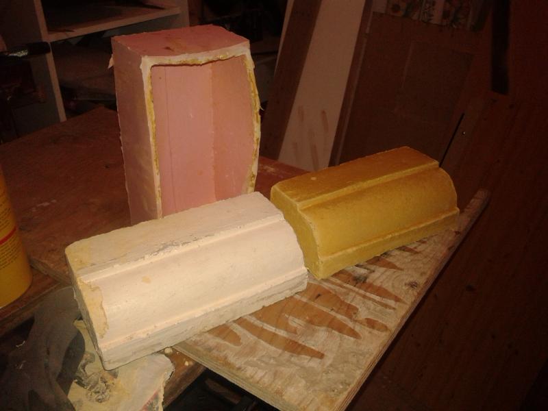

I'm building something of an extravagant shed at the moment. Somehow I managed to get planning permission to build a shed with a pitched roof, 2 dormer windows and a brick chimney stack.
I quite fancied a row of brick specials to dress my block work (along with stucco and stone). Brick specials are quite expensive and you don't get the variety of the bricks available from the Victorian period.
Reclamation yards have lots of nice bricks but not always in the quantity you need.
So....I decided I would make my own. I bought one nice brick and a litre of silicone rubber. I painted the brick with a gloss to help with the de-moulding and built a wooden frame. Voila, one brick mould for me to fill with yellow concrete. The results seem quite good and now I can make lots of bricks which have character.
The brick on the left is the original. The mould is just behind.
It seems so easy yet no where else on the web can I find concrete brick specials. Lots of websites with architectural stone but no concrete brick specials as such. Surely this is cheaper alternative to making fancy bricks with clay. Is this a gap in the market or does no one want fancy concrete bricks? I'd love to hear your thoughts.
Ian

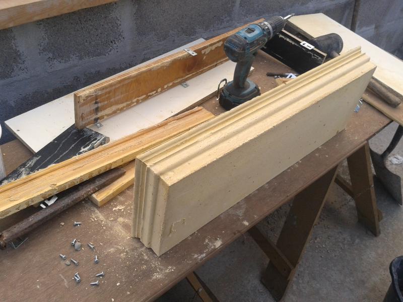

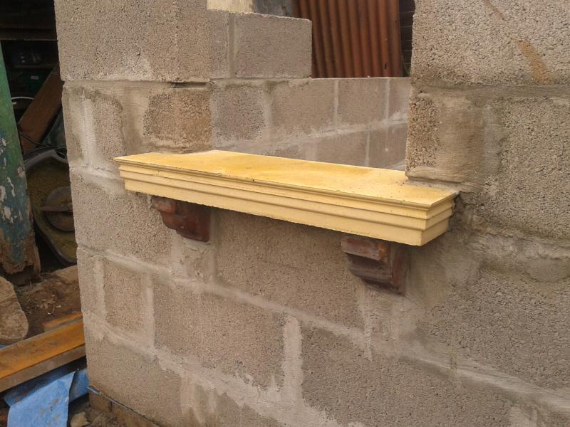

The project is well under way. I also did something similar for the window sills because I didn't want the plain flat sills you buy in the shops.
I made a box from wood, lined it with some architrave and filled it up with yellow concrete for a sandstone look. I'm quite pleased with the results.
I'll gladly post more pics as I make progress.
Interesting reverse of the architrave moulding. Did you need to use anything as a release agent?

I didn't use a release agent.
What I did do was varnish the wood before hand and seal the gaps between the wood with silicone sealant.
