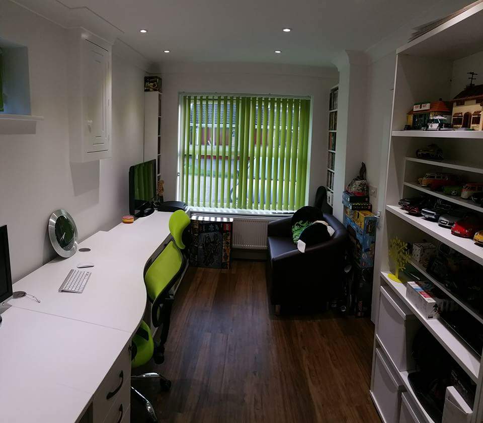

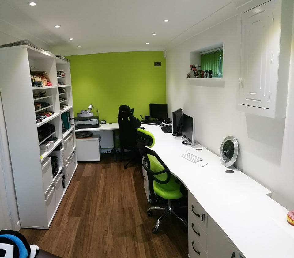

I converted my garage a while back when I done a 2 story extension above, I used https://m.officefurnitureonline.co.uk to kit it out, as they have a very large variety of desks lengths, depths, styles, cabinets, bookshelves, filing cabinets that all match.
I gave them the dimensions of the room and told them the desks I like and what items I wanted and they designed it for me with proofs and the actually style of desks I wanted included free build, installation and placing them. Which was a bonus
