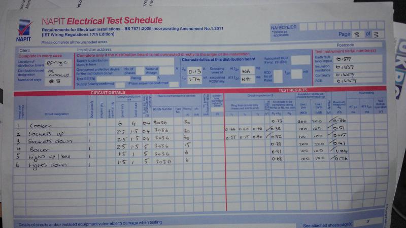

Good to hear it won't necessarily need a rewire in the near future, I've attached a pic of the report if anyone is interested or spots anything that I may not understand.
The report states "No RCD protection throughout (new fuse box required)" and is marked as C2 - Potentially dangerous urgent remedial action required.
It really winds me up these people that don't know what an EICR is for or how to fill it out.
You are testing and inspecting the installation and reporting on it's condition. That is it.
The IECR is not the place to recommend what improvements are required.
A statement such as 'new light required in kitchen cupboard' is just pointless. WTF?? Tell me why a new light is required, and which regulation(s) the existing light is contravening.
It seems the OPs electrician has done a pretty poor job over all of properly filling out his certificate.
No unique certificate number. Test results not identified as to what type of certificate they relate to. No customer name, address or post code.
Distribution board designation 'as marked' What the hell??
No reference methods, no numbers of points served, no kA values, no max permitted Zs values, a 6.0mm² with a 4.0mm² CPC, and apparently there are some 6A BS3036s in the OPs installation!!
No page numbers at the bottom
No. of phases, No. of wires, Rating of main fuse, Main earth verification, 8 boxes for main switch details all left empty.
On to the observations section, it asks you if any further investigation is required for each departure. 'YES or NO' not ermm I'm not sure so I'll leave it blank.
3 boxes under the observations also not filled in.
These should have ALL been completed.
I only hope this certificate gets picked out by the crappit inspector :rolleyes: :rolleyes:

It would seem that he has already done a fairly thorough EICR (even if not documented perfectly). That being the case, would you really expect him to undertake further testing if he were to replace the CU in the fairly near future?

Those NAPIT forms are pants, eh?
I can't see a requirement to test N-CPC for insulation resistance, so there is a danger that a fault of this nature won't be picked up and once the RCD board is fitted, it'll be tripping away....
Incorrect disconnection times too.
Any unused boxes look better with n/a in them. Then you defiantly won't miss any out.
It would get picked up on the Live/Earth one SB... Phase and neutral connected together, tested to earth. It doesn't say Phase/CPC ;)

Ah but would it? If I squint at the forms then I think it says 'LIVE/CPC - which would suggest as you are saying (test both Line and Neutral to CPC) but how many would just test the LIVE (ie not the N?). Obv not you :) but....
NICEIC forms ask you to record them both separately, which can be helpful when fault finding.....
PS Didn't the term phase go out with the last regs???
You're probably right about some people - but those are the ones who don't realise that 'live' means N as well as L - and I, personally, would question whether they should be doing EICRs if they don't understand that!
