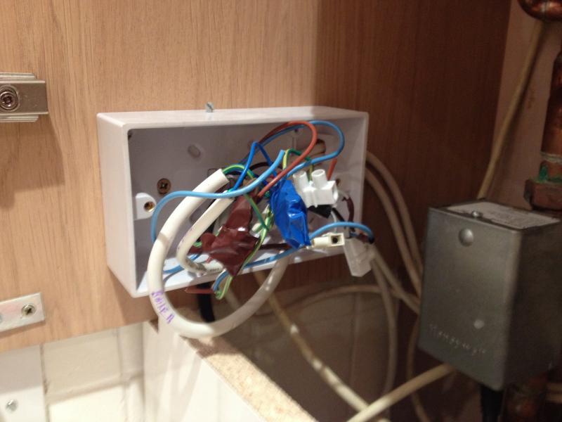

Hi I was wondering if anyone can help with this one.
Genuine post not a bodged DIY attempt and asking for help.
I had a new boiler installed over 12 months ago by a gas safe engineer, it has never really worked since the install and now after all this time the installer will not come back or even answer any comms.
They did come back a few times during the first few months and after each visit nothing really seemed to be an improvement but now in the last few months the excuses I have had is I can't attend because I am ill / on holiday / too busy etc etc......
The issues - for me to heat water to the cylinder I have to turn up my wall thermostat which then operates the boiler, the pipe to my cylinder gets hot and I have to turn the wall stat down to turn off the HW water.
For the rads to work I have to turn on the ch and hot water on the program together.
Trading standards and gas safety / registered manufacture installer issues aside I just want to to get the thing working properly.
The junction box is a birds nest of wires, taped together with insulation tape and unused wire just snipped with no insulation a real bodge job.
Now if the system is operating opposite to that which it should be ie room stat on hot water heating instead of room stat on rads working, could this be resolved by simply turning the honeywell 3 position diverter valve round the other way?
Any help appreciated.
Many thanks and sorry if it sounds like a rant but this has been a very expensive and frustrating experience for us.

1. Check the valve model no. It should be a V4073.
2. You can't turn the valve round, but it's worth checking that it is installed correctly. The ports are marked on the side of the brass body - A, B and AB. AB goes to the boiler or pump. A goes to the rads, B to the HW cylinder

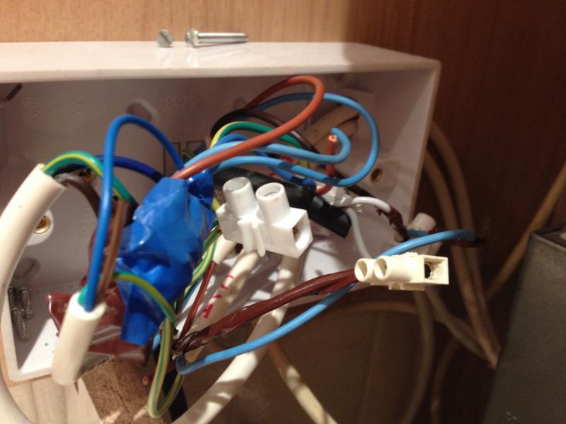

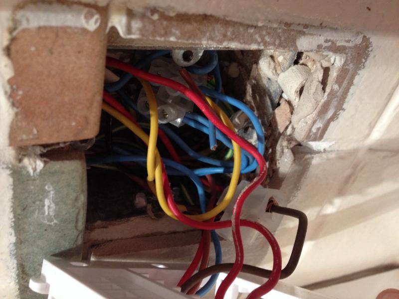

Can you take pic of the junction box (with the lid off ;) ) so we can see the wiring.
This is what the wiring looks like.
FFS! Rip it out & start again
Looking at that there's not one 5 core cable in there so there might not be enough wires in there. Y plans not only need a wire to tell the valve to turn on HW or CH it also needs one to tell it to turn them off, looking at that there's a chance he's only provided a L N for each demand.
Also thanks D Hailsham for the diverter info, it is plumbed in opposite to those points mentioned.
Wtf is that
I expect to see that on old systems not new!!
