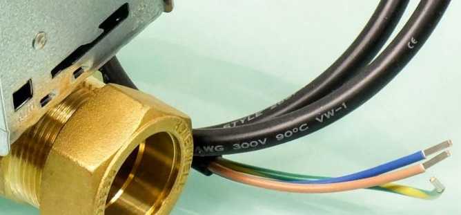

I have the MV in my system that controls the heating to the HW tank. A Dunsley Neutraliser blends the heat from the oil boiler and the wood stove back boiler and the MV stops the flow to the tank when it's hot enough. The valve has failed open and the HW is far too hot. The MV is a Honeywell 4043B - such that it is open on mains failure.
Investigation shows the head has failed - the quadrant gear is jumping, so a replacement motor is a no-go. I cannot find anyone stocking the head for this MV - can someone help please.

Try that one linked above- Screwfix and Toolstation take returns. I don't know whether the B uses a different gearbox to the H- you might get lucky :). If you don't then it's new valve and swap the mech over.

That's a V4043H which is a normally closed powerhead. The OP wants a V4043B that is normally open. The V4043B can be identified because as it is normally open, it doesn't need a manual opening lever (hence the vacant slot) or have an internal microswitch, so only has a 3 wire connection.

Thanks IanMCD - just along the road from you. I should have probably said that it was NOT the 4043H !! I suspect that many didn't know the difference.
Unfortunately it is looking ominously like the head is not available for replacement, and I will have to buy the whole valve and then take the head off. I'll give BES a phone in the morning.
