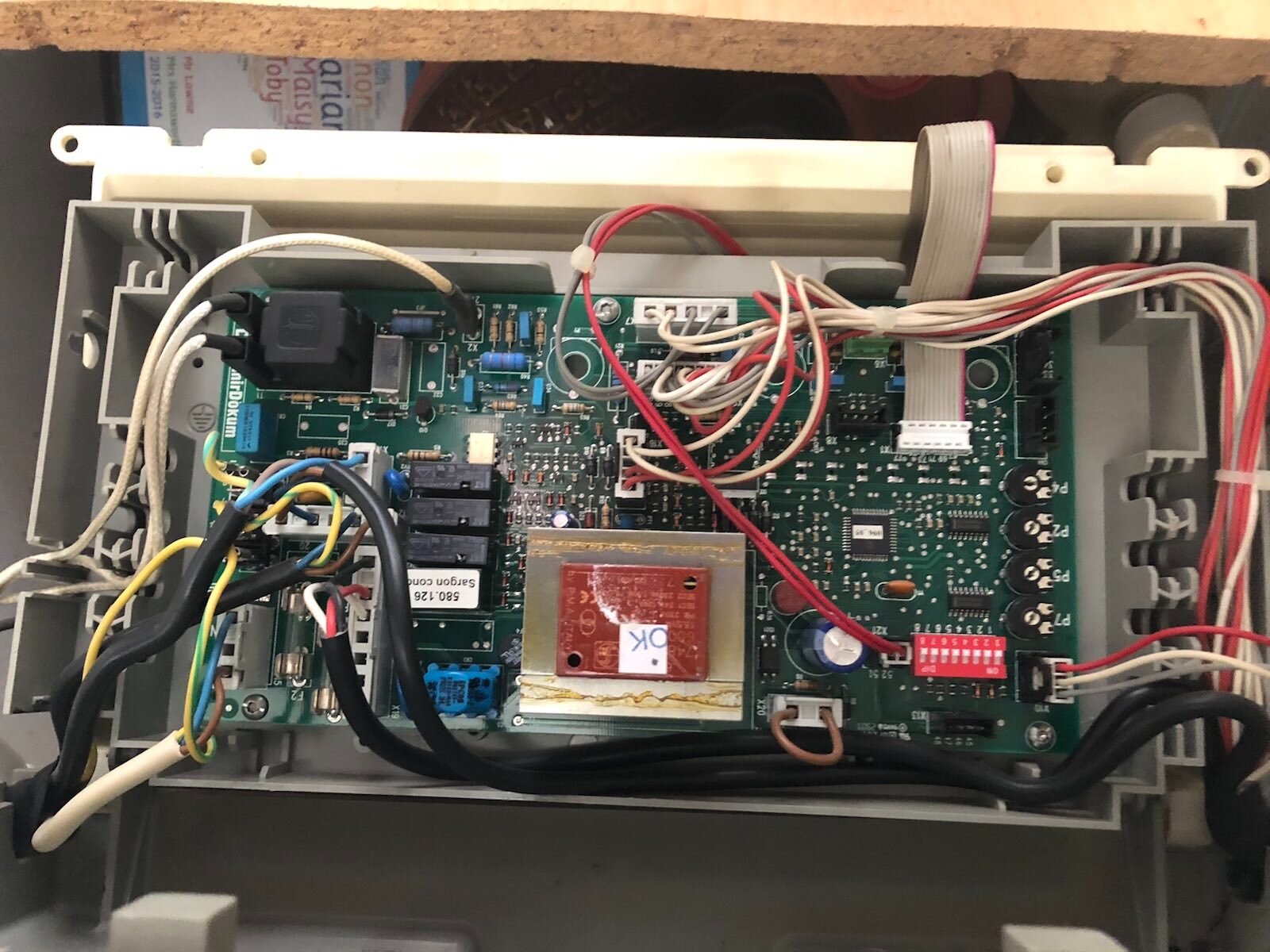

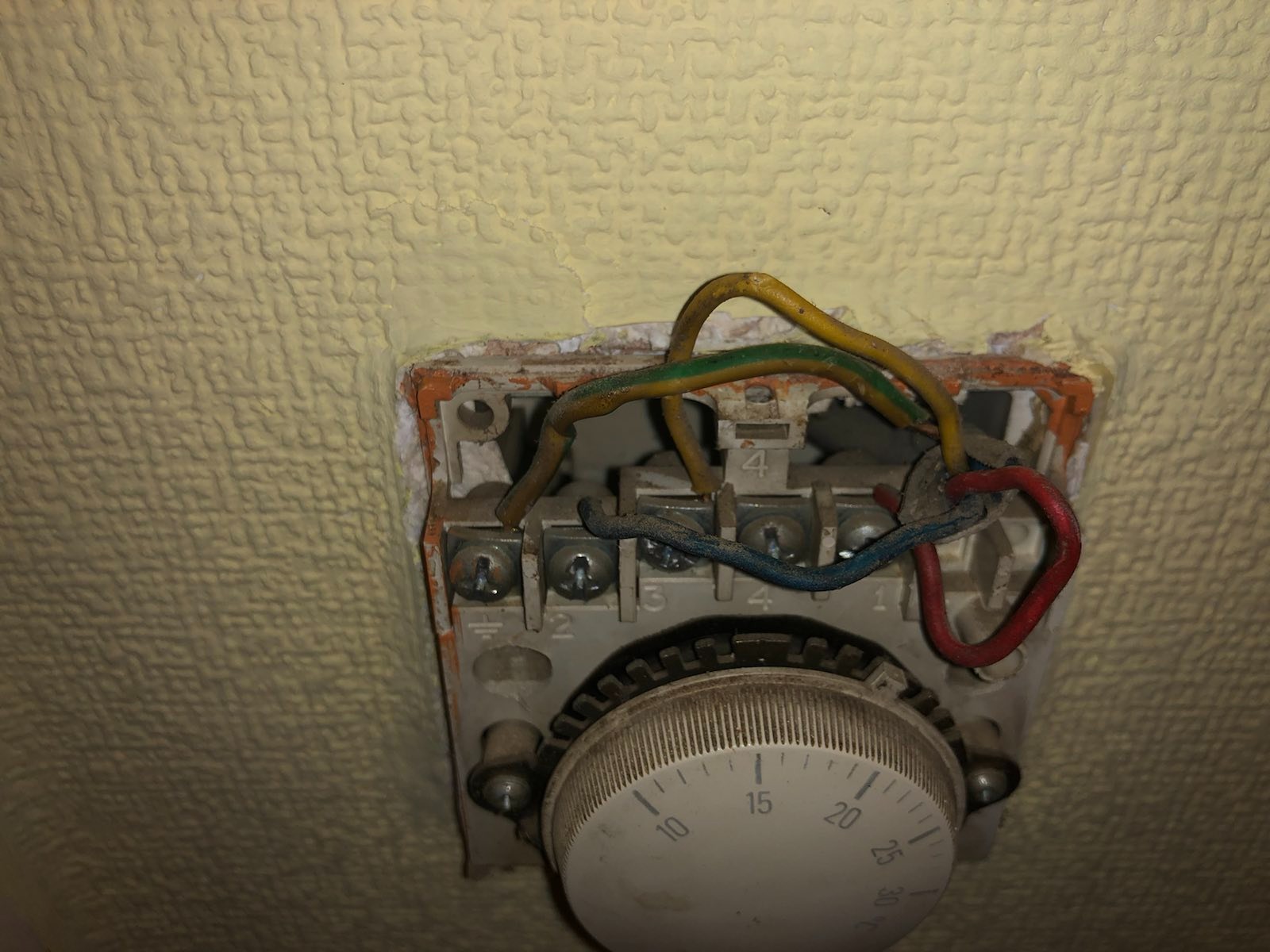

Hi,
I've a Honeywell 6360B attached to a Heatline Combi - I've manuals for both but am struggling.
The Heatline is set to use low voltage for thermostat (the 230v thermo connector is jumped) and I can see the two 'switch wires' exiting from the 24v thermo connector but lose sight of them as they disappear behind tiling with the mains supply (there's an isolation switch as few feet away). Across the house at the Honeywell there's a four core cable live/neutral/yellow/bare earth - which is wired to terminals 1/2/3 & earth.
Everything works fine, I just want to add a more modern thermostat (L/N & low volt switch) - but I'm struggling to understand how it's working now since my reading from the Honeywell circuit is the yellow cable is a switched neutral @ 230v. Is it possible there's more going on somewhere - extra resistance or something.
Thanks.

I can’t see the RT connection on the pcb, but if everything works as is, and you’re measuring 230vac on the Honeywell, then I would say it’s mains switching.

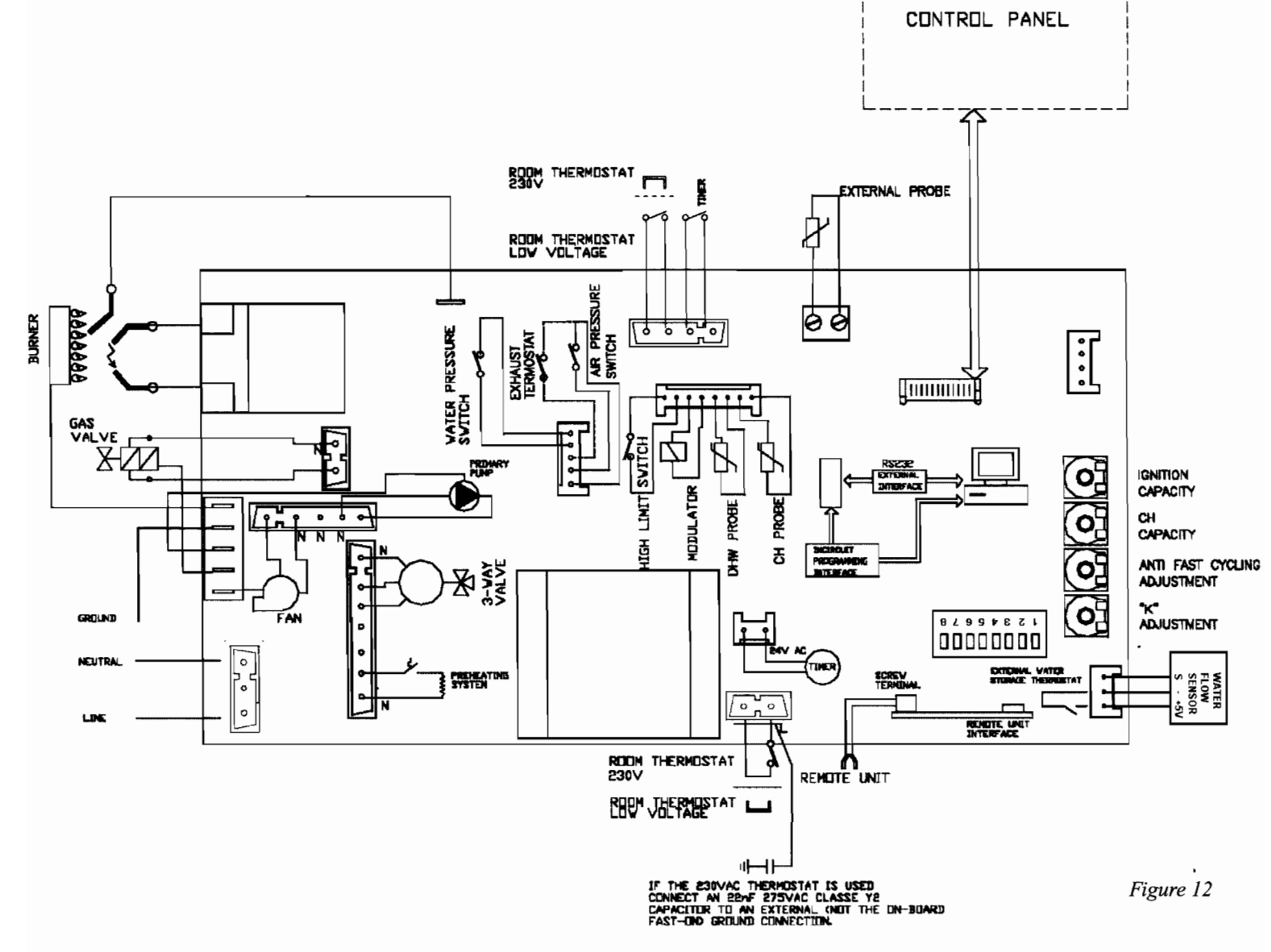

This is the board diagram - I don't have a reliable meter, but mains tester driver isn't lighting on the thermostat connections in any state. It's definitely controlling the boiler properly though.

It needs testing properly, and the brown link that’s in could be controlling the heating as opposed to the room thermostat. Simple test would be put the heating on, leave room stat on low and see if it kicks in, ensuring the boiler thermostat on the front is high.
The compensation resistor in the old thermostat will not work with an extra low voltage supply, but some times that is a good point not bad, it means the difference between switch on and switch off temperatures is greater, but it will still work with extra low voltage.

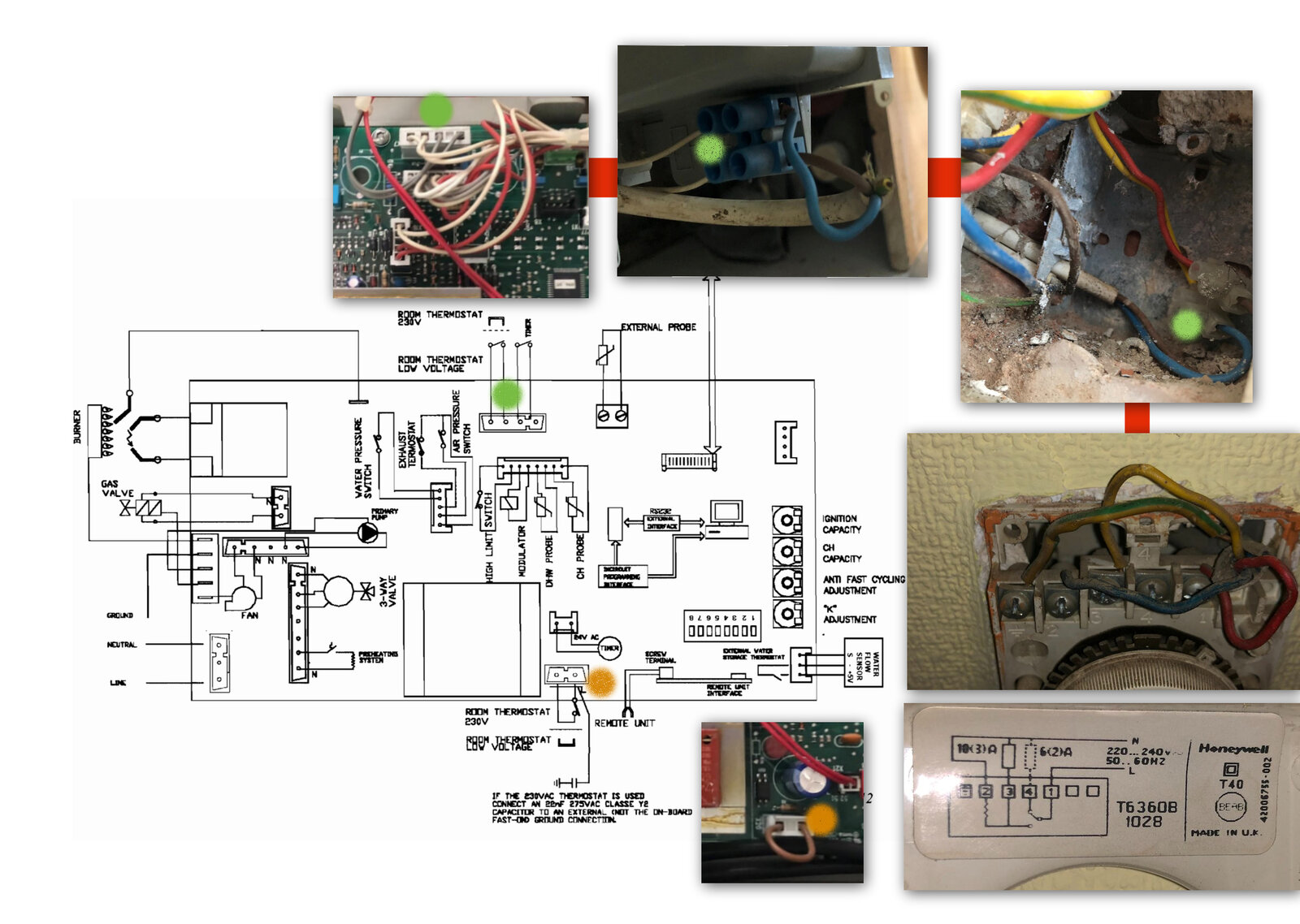

So I've traced the RT which goes from the low-voltage on board to a scotch block at the side of boiler connected to a 'L/N' of a supply cable.
Then behind the isolator/switch I can see that cable connected via another scotch block to yellow/red cable (can't see the rest of their cable, but I assume it's the other end of the cable connected to the thermostat.
I've tried to put it all in one image...
Why is this working and not killing the board?

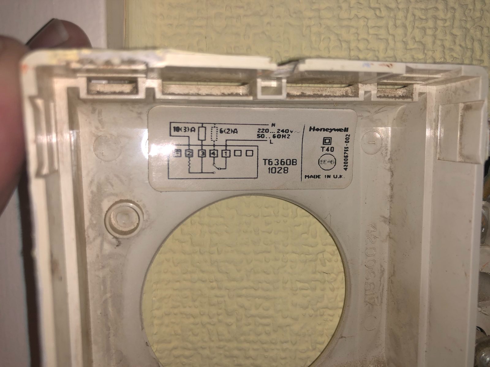

Just in case anyone happens upon this later and since most instructions/videos have a different config - after testing with a meter this was wired as follows:
Pin 1 (red in photos) and Pin 3 (yellow in photos) were connected to the' low voltage' thermostat terminal on the boiler (~15VAC) and Pin 2 (blue wire) was connected to neutral on the load side of the isolator switch (earth was connected likewise to the isolator).
Still not 100% on why this actually worked, but it did - I was able to re-use the cabling albeit wired simply to supply a modern smart thermostat with 230VAC and run a volt free connection back to the boiler (all jumpers etc being the same).
What seems evident to me, and why it would work is, the RT connections on both sides of the board are suitable for 24v or 230 vac.
