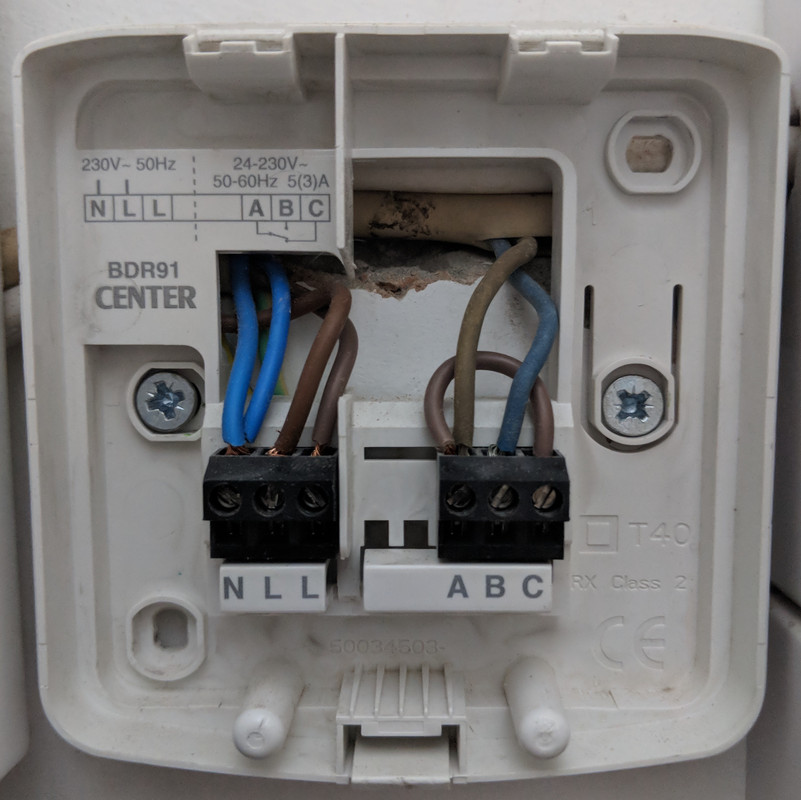

Hello!
In the spirit of adventure I am trying to understand my existing Honeywell wireless base and transmitter setup and have come across a real head-scratcher with the wiring, I wonder if anyone can shed some light.
I understand N and L, I understand that A, B and C are essentially a fancy switch.
What I don't understand is why C is shorted to A?
Indeed, if I remove the wire from A to C, the system still works as expected.
Any clues appreciated! This system was installed by a professional by the way so I assume they knew what they were doing...
Take the link out of A-C , A to B is normally open so it takes a call for heat to close them and fire boiler, A to C is normally closed meaning the contact is closed when unenergized.
