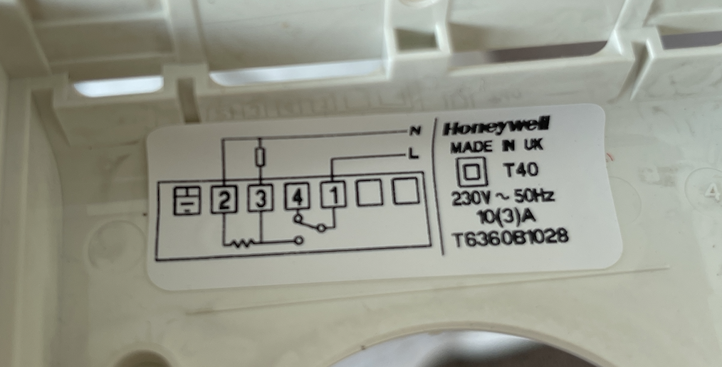

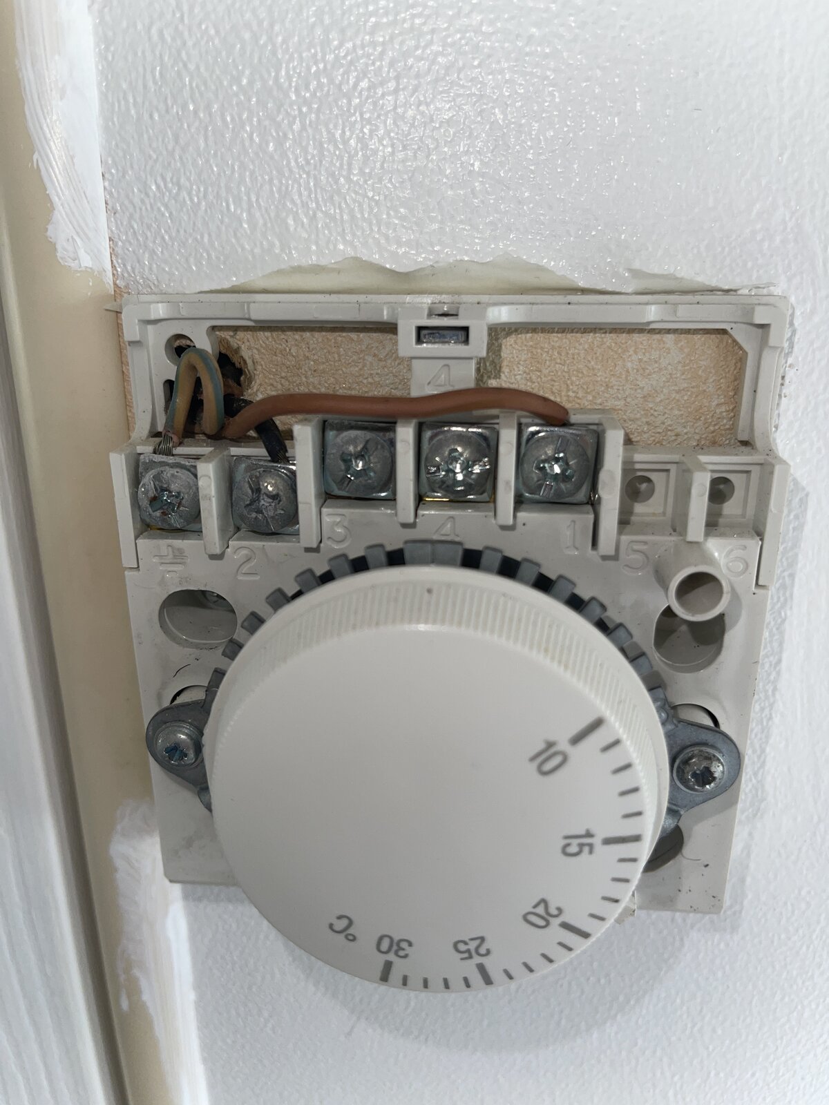

Current Honeywell wiring.
It is wired as Black 2, Brown 1 plus an earth.
Honeywell wiring diagram.

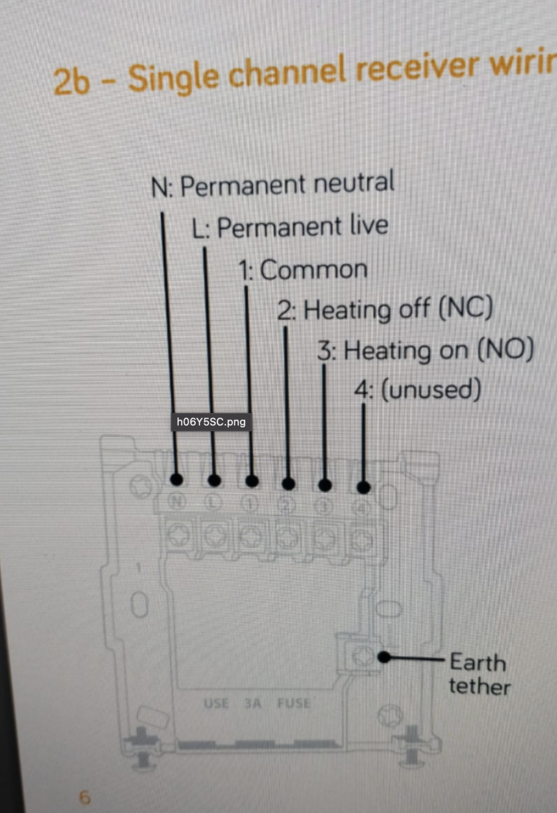

Hive receiver diagram.
Where should these wires be going in the Hive receiver diagram, is it like for like? do I need any bridges etc or a complete rewire ( which I'm hoping to avoid )

New wiring I’m afraid, no permanent neutral on that existing one, which the Hive receiver requires. Also opening up the boiler case on that boiler requires safety checks afterwards, ok if if you’re competent and have testing equipment.
as a cheat if the earth wire on your existing thermostat goes to the earth on the boiler then you could sleeve it black or blue and connect to the neutral at the hive and connect to the neutral at the boiler, then the wire in 1 at the thermostat goes to L on the hive , link L&1 at the hive , then the black wire in 2 goes to 3 on the hive, no need to be gas safe registered to do this on this particular boiler if the boiler has a timer it will need to be set to constantly on and the Hive will over ride it
Brilliant, I will give this a try when I’m back down at the Caravan on Saturday . Thank you Ian

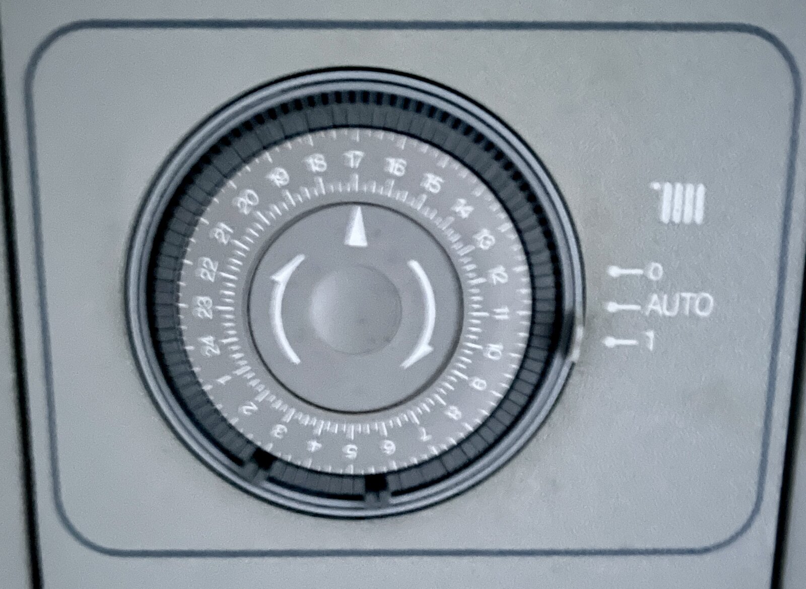

Do you only have a room thermostat, most boilers also have a programmer which is what the Hive receiver replaces.
Hi, It only has the timer/programmer on the actual boiler.
simply set that to 1 constantly on and the Hive will over ride it

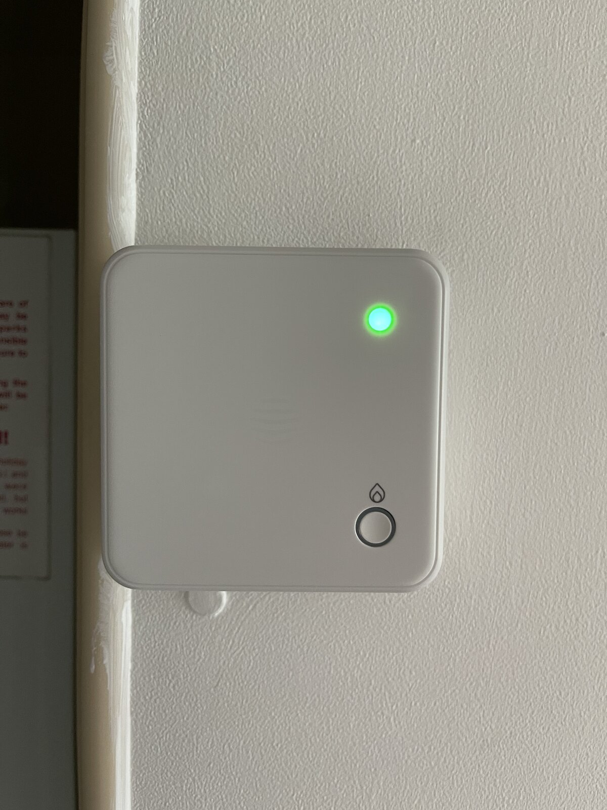

Many many thanks Ian. Ended up just re-wiring the hive to the boiler with 3wires and a bridge wire as suggested by yourself and it’s running like a dream!
You have really helped me and saved me £80 the Site electrician wanted.
It was so easy to do following your instructions.
Thank you once again.
