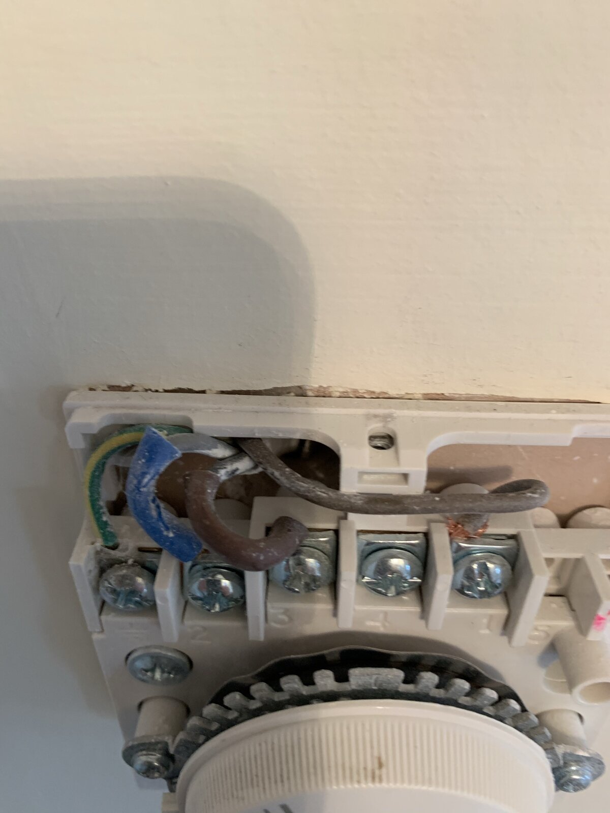

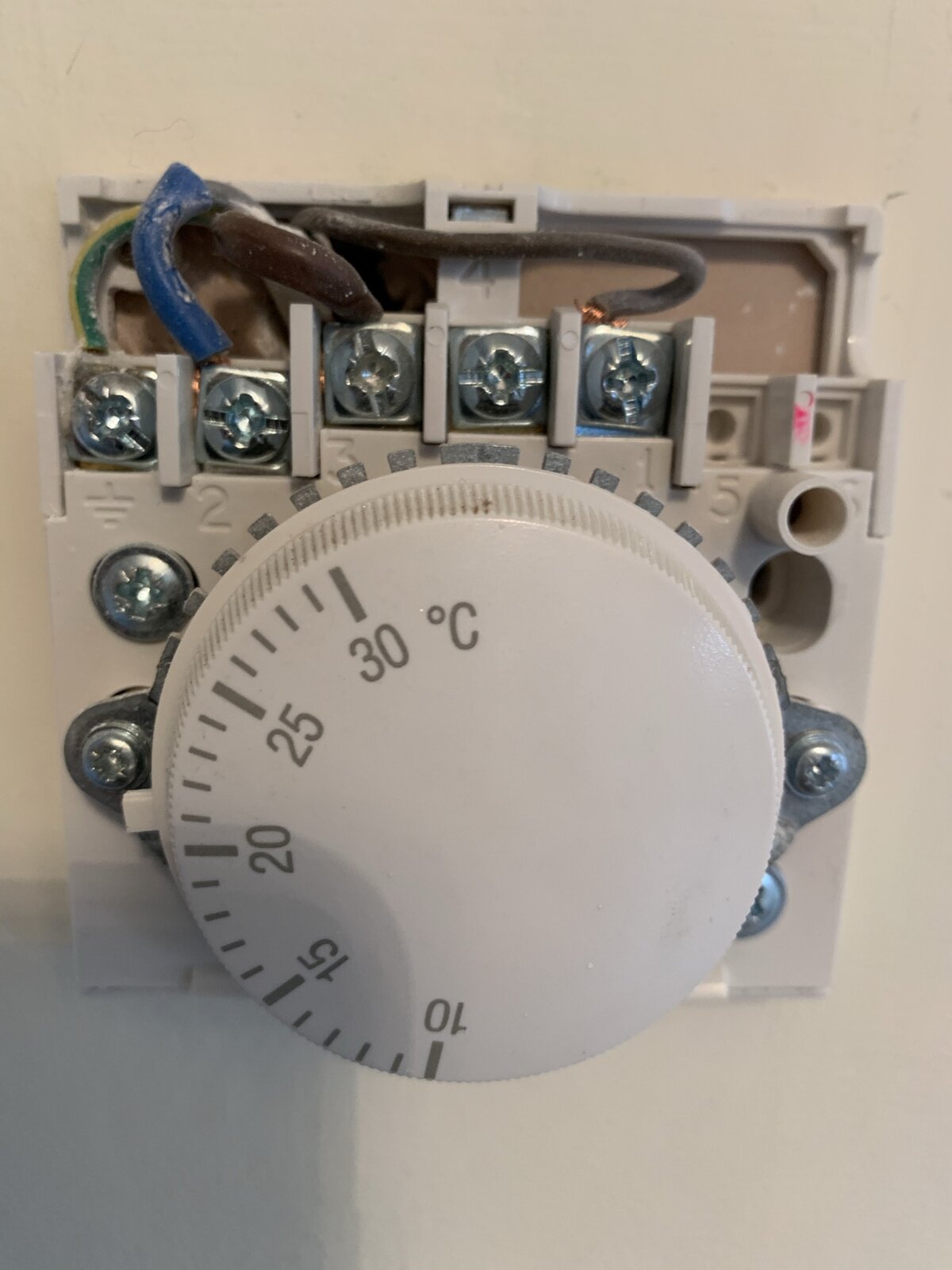

Good afternoon,
your help would be greatly appreciated. I need to replace my dad’s analogue Honeywell room stat with a wired digital one. Below is the wiring of the existing stat.
I interpret them cables running from left to right to be the yellow & green (earth), the blue (neutral), the brown (live), grey or is it black (unknown).
I understand that that only 2 wires are needed for DT90E. The earthing one is not required, not sure of the other not to be used. Please identify the 2 cables that are needed and which terminals in the the DT90E they go in. I plan to use a terminal block for the 2 unused cables.

USE wires in 1(live in) and 3 live out
isolate earth and 2 (neutral)
use A and B IN DT90
To confirm. Old stat terminal 1 wire goes into DT90E terminal A and old stat wire 3 goes into DT90E terminal B?
Thanks in advance.
Thanks in advance.
yes, but to be honest if you get them the wrong way round wont make any difference, it is just a switch

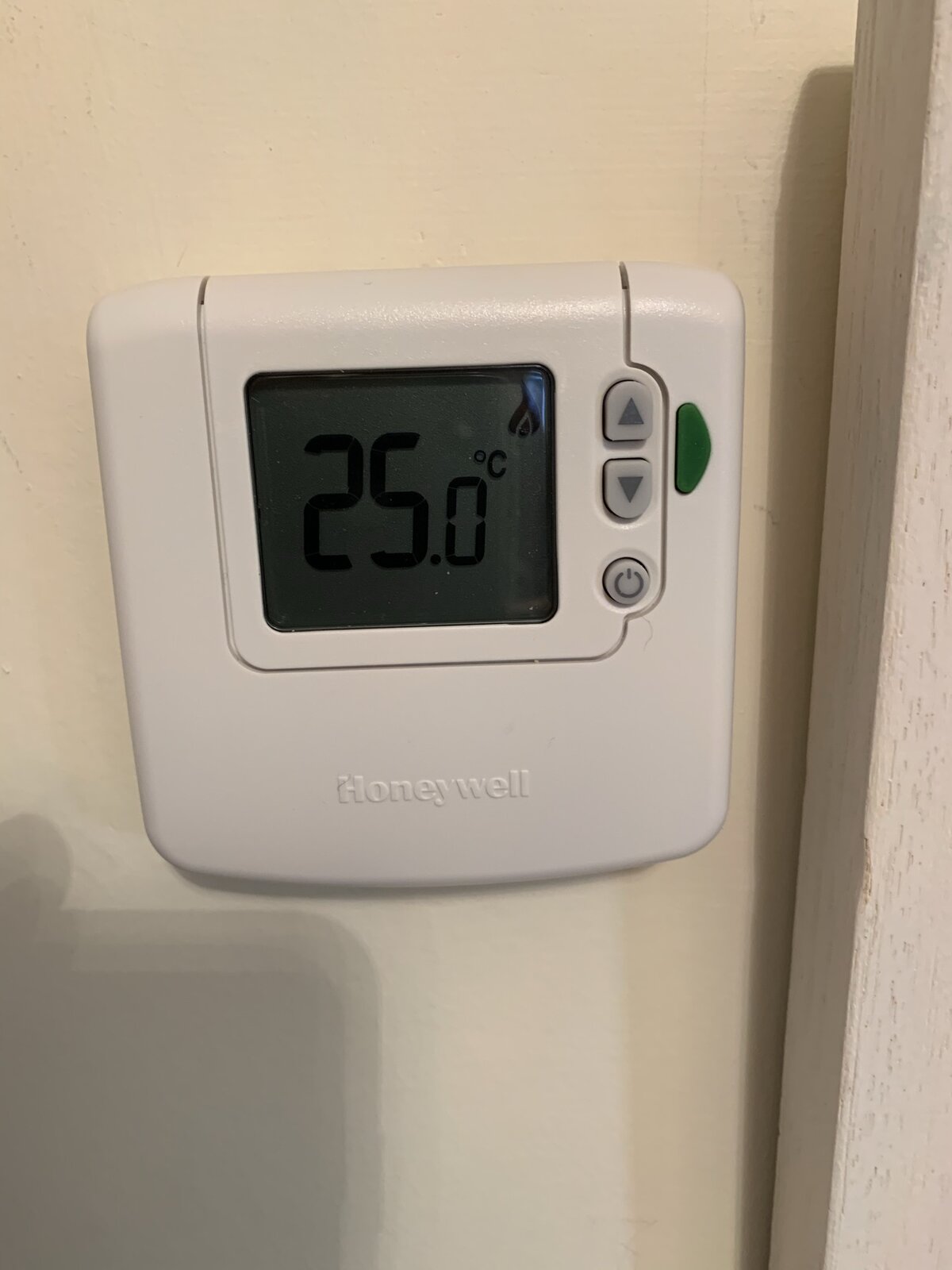

Job done. All working.
thanks again.
