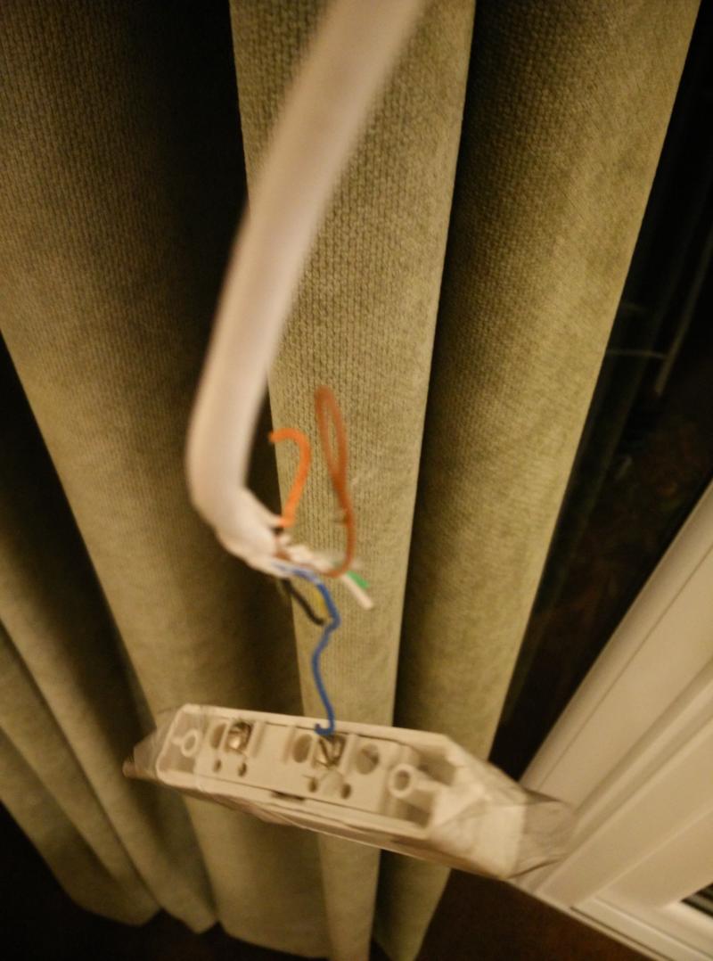

When we had upvc french doors fitted recently, the fitters had to detach the alarm contacts, they put the two contacts together and taped them up.
At some point one of the wires (blue one) has become unattached from the contact.
When I set the alarm the unit just beeps rapidly with an error message "Back door"

No ... Just put it back under the silver screw in the contact no high voltages ...
If one of the two silver screws is missing a wire, that's where it should go.
Strip back the brown wire put it around the screw as the other wire , there is no tamper loop on that cable, put the magnet at the side of the contact and try to set sytem.

So I attached the wire and didn't die.
The error message has now gone but the alarm won't set, it just beeps continuously until I re-enter the code.
Any ideas?
If it was deffo the brown that came out twist it together with the blue & try again. If that fixes it the switch is duff. You can get contacts that work with a large gap that are fine for UVPC doors. That would be the long term fix rather than having the switch made redundant by taping the magnet to it.

Would it cause a problem if I twist together the wrong colors?
If not I could just try them all?
The orange wire is also longer than the rest.
No as there shouldn't be the 13v supply on any of them as no need for a switch. At the most you would have the switch (2 wires) & tamper loop (two wires again.) If that contact isn't making a circuit you would get the fast beeps when trying to set the alarm & after the delay timeout (whatever that is set to) the alarm would sound.
