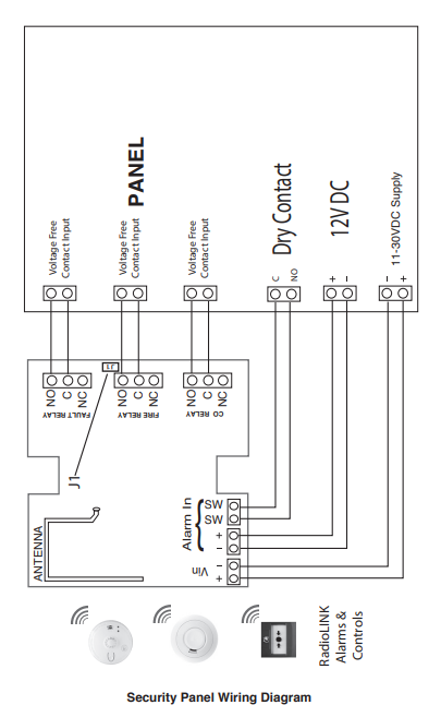

There is a couple of low voltage Aico Ei181 ionisation smoke alarms connected to the Galaxy 2-44. These smoke alarms are now obsolete. I was looking to change these alarms, just wondering if anyone else has done a similar exercise and what they chose.
The Ei413 is a RadioLINK Panel Interface Module that provides an interface between RadioLINK alarms and accessories and fire alarm/security alarm panels.

Not quite sure from the wiring diagram of the 2-44 panel and the interface module how they will hook up.
The smoke alarms have radio links if one goes off all of them go off. Currently Aico Ei181 are addressed separately therefore it is possible to pin point from the alarm which one was triggered.
