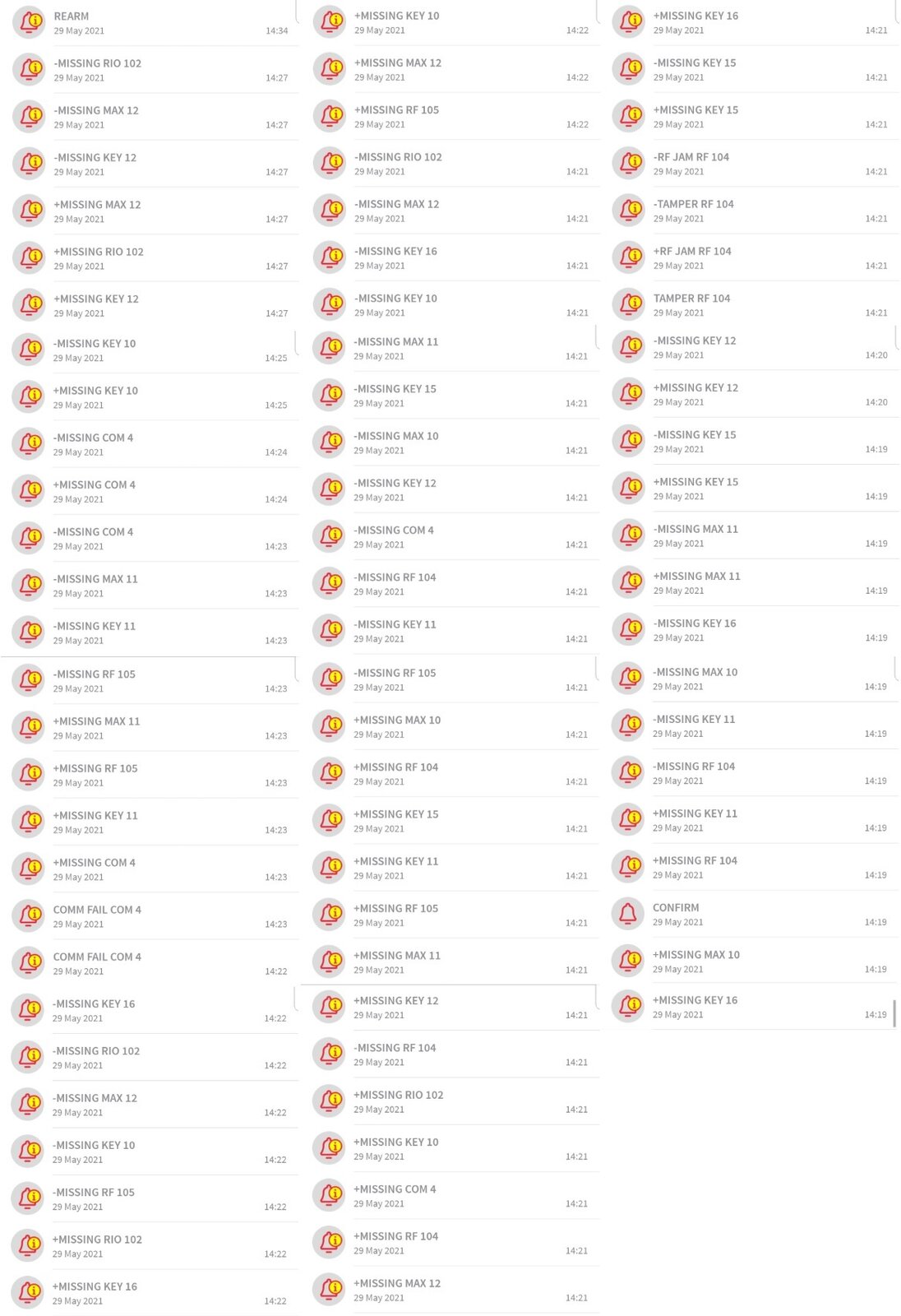

I have a GD-48. Today, it had some sort of weird episode for 8 minutes. During this time it wrote loads of messages to the log where various modules "went missing", then came back. Then it seems to have recovered. This has happened twice previously (to my knowledge). The other times have been while I've been in, and the system was unset. On those occasions, the keypads started beeping which alerted me, and the issue resolved after a while and the beeping stopped. Probably I entered a code to clear the beeping. Anyhow today, since I was out at the time, it triggered a false alarm and I didn't spot it until a neighbour contacted me to let me know. By the time I checked, it had already rearmed (after the alarm had been sounding for 15 mins), and as the weird episode was over and did not repeat later there was no recurrence of the alarm before I got home.
I have attached a log taken from GX Remote Control app. NB you have to read it bottom to top.
Anyone have any ideas what happened?
My best theory is that the power supply is only just coping with the load on it and for whatever reason, at these times its power output has dropped temporarily such that various of the modules have shut down, then later it has recovered.
The system was installed by a semi-professional relative of the previous owner of my house. There were a lot of things wrong with it that I've sorted over the time we've lived here (as an enthusiastic amateur). I've also added to the system 1x keypad, 1x PIR, the internet module, 2x RF RIOs and 2x shock sensors. These episodes have started since I added the second RF RIO and the 2x shock sensors.

This is a bus fault and all devices on the bus are dropping for a second, then coming back online. I would start by checking diagnostics power supplies which should give an idea of current consumption. Then check across all the devices to see if any hints with devices not being at 100%. It may be a device you have added is faulty or the wiring going to the first device in the chain has an issue. I'm afraid it's going to be a process of elimination.

Many thanks for the reply @GalaxyGuy. Ok. I checked diagnostics. It is giving a constant reading of 13.76V with the current fluctuating between 0.53A and 0.61A.

The bus fault is the symptom and since it's intermittent, then it may take some time to diagnose. It can be caused by the bus itself being open, or a rogue device causing the issue by dragging the bus down. It doesn't look like a power supply problem, but that's not to say that some device isn't going low resistance and dragging power down. Although, you'd expect a blown aux fuse if that was the case. Most of the time it's wiring disturbance or something faulty that's been added prior to the fault manifesting.

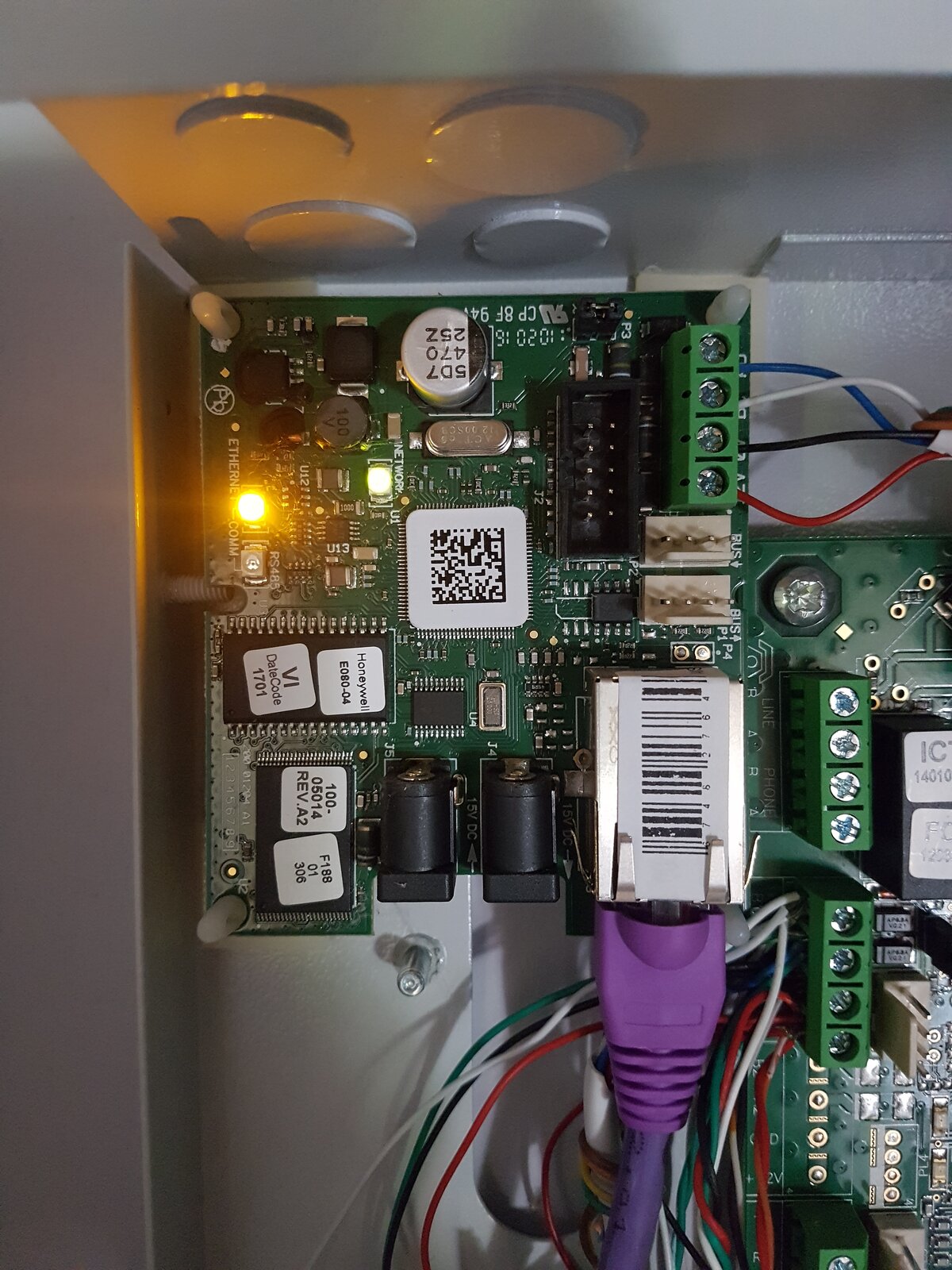

The E080-4 modules go faulty over time. Check for any scorching on the square QR barcode label.
Thanks. QR looks fine to me but have taken photo for what it's worth! The shock sensors are Honeywell Viper GL ones which have electronics - so they do have power to them - hence me thinking that. Especially as they were the most recent change?
Just test the temp with your finger on that label, it shouldn't be hot. Probably some other issue, but the E080-4 is a known problem part.
Check them for moisture inside. Especially if on a window frame.
