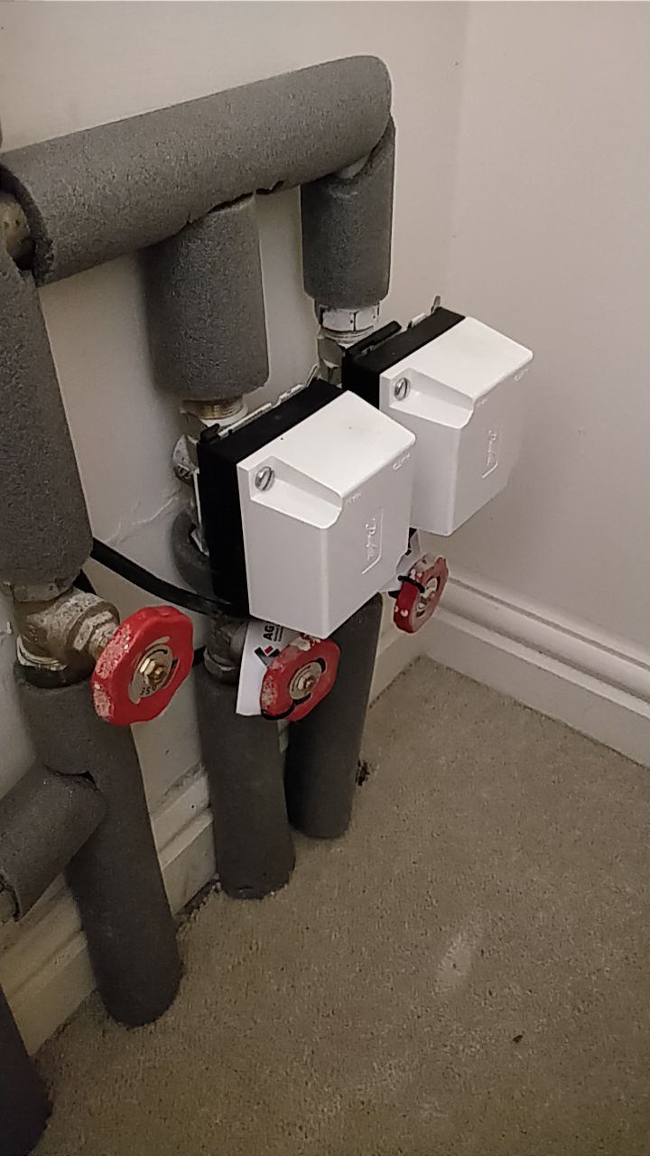

I am attempting to setup the Honeywell Lyric T6 thermostat. I have a multi-zone property, so i have two of the these thermostats.
I believe i have identified how to setup one thermostat - but i am totally lost at how to be able to control both zone. I have an understanding that i would need to wire in both receiver boxes that came with the thermostat.

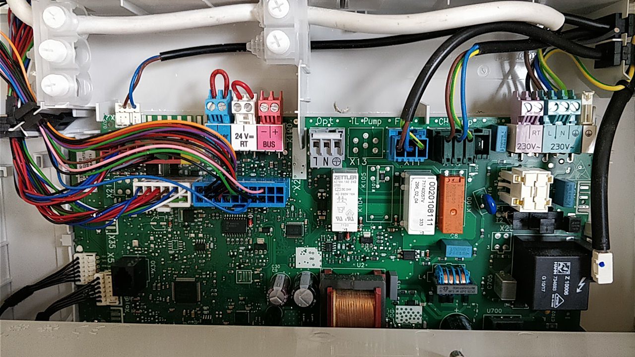

* The main PCB
* multi-zone valve

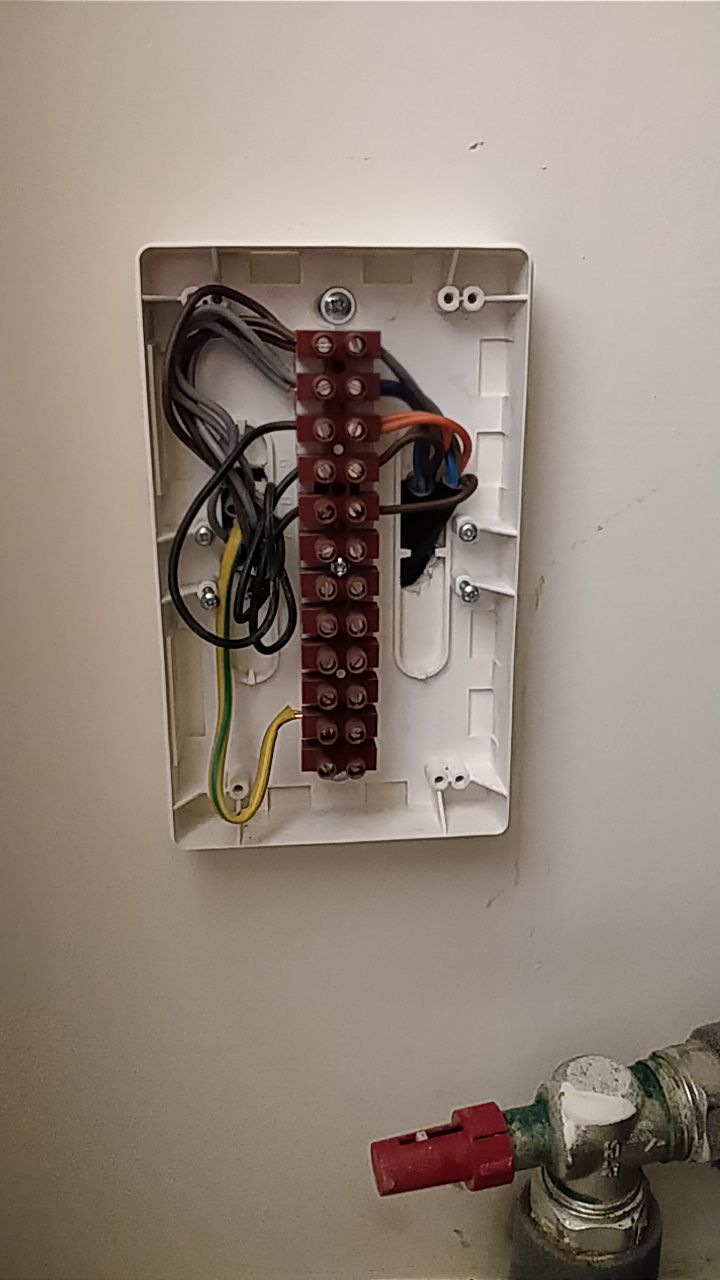

* Junction box.
The boiler i have is a vaillant ecotec plus 838

Is this a new set up ? the 24v connection plug should have been removed when the boiler was commissioned, don't suppose you noticed the boiler running all the time :confused: anyhoo you have to connect both the recievers to the junction box.

ok thank you for your help. I will attempt to read up more on how to setup the receivers within the junction box.
Find out what the connection is on the far left hand side, I think its marked up as x22 (the black cable with two core going to a white plug) you might have more complications than you think.
edit.. ignore the black cable, its the pwm signal cable for the internal pump, have you removed the 24v connector yet ?
Yep. I think I will just have to get a professional to install them for me.
You shouldn't be removing the cover of your boiler unless you're Gas Safe Registered and competent to carry out the 26.9 checks which need to be completed for safety reasons before the boiler is operated again.
