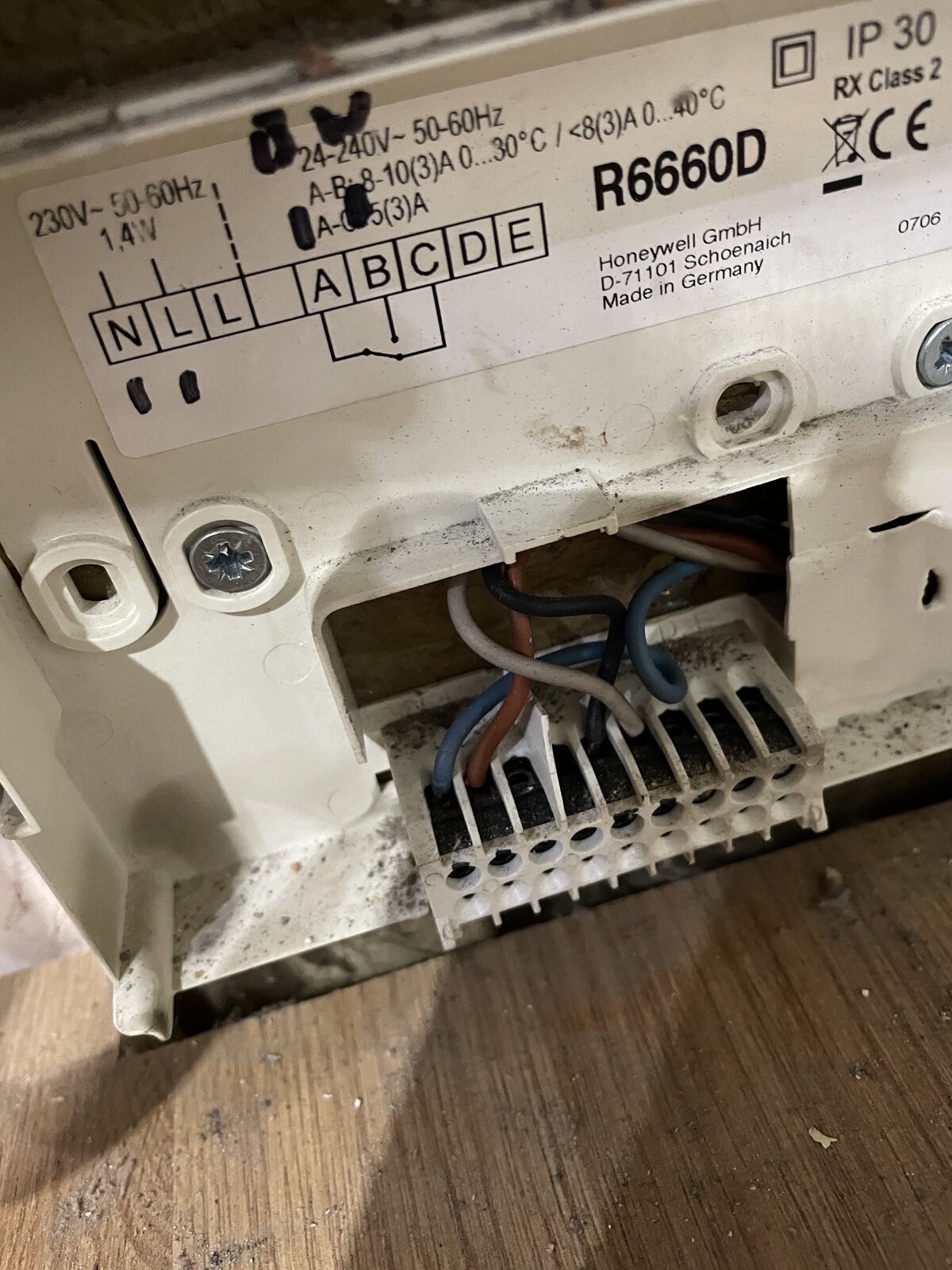

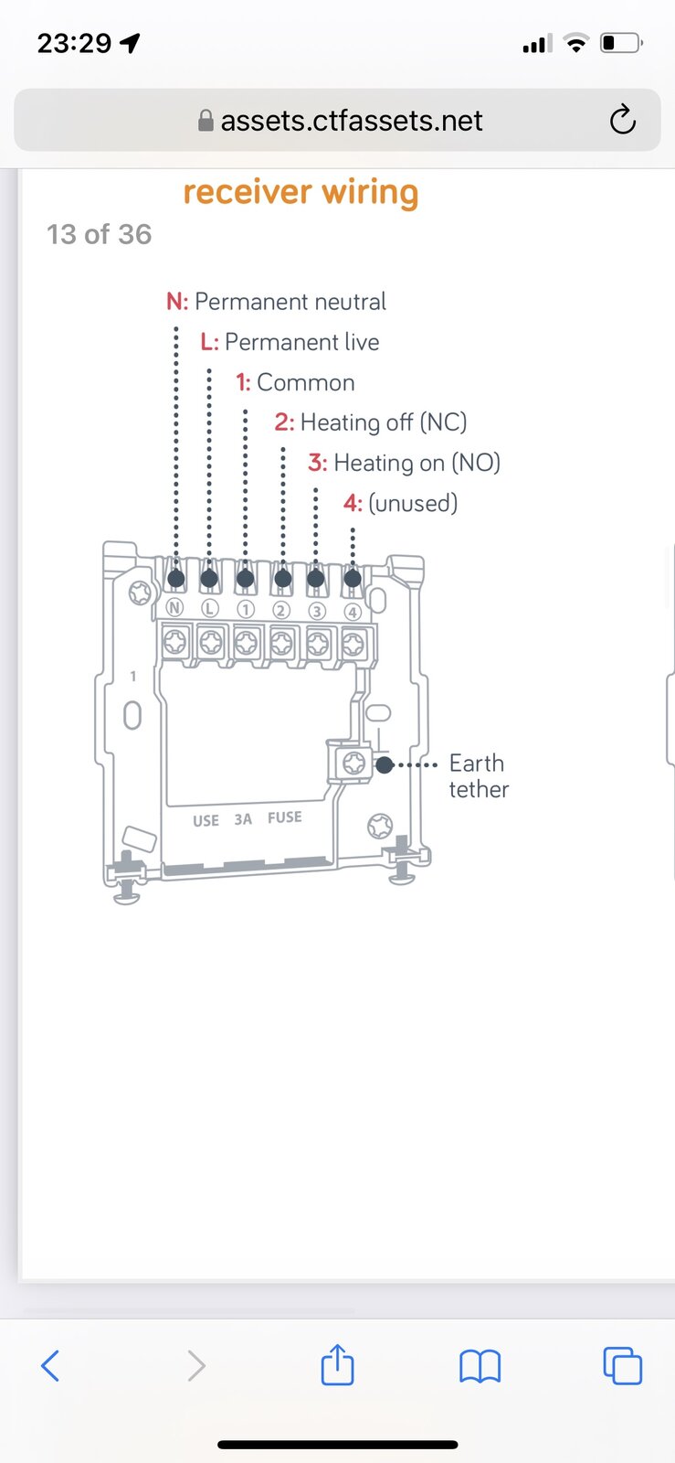

Hi I want to change my honey well receiver to a hive one my current one has 4 wires neutral and live than the two switch ones the current setup is on a and b on the hive will I need to put the wires into 1 and 3? What would happen if I got ir wrong also? Thanks in advance
Stop worrying you are correct the wires in A&B go to 1&3 doesnt matter which way round , it is simply a switch, and as you already know L&N to L&N simple as that, no Earth required
thanks pal just thought I would double check before doing it heard you can knacker up the boiler if you get the wiring wrong thanks again
