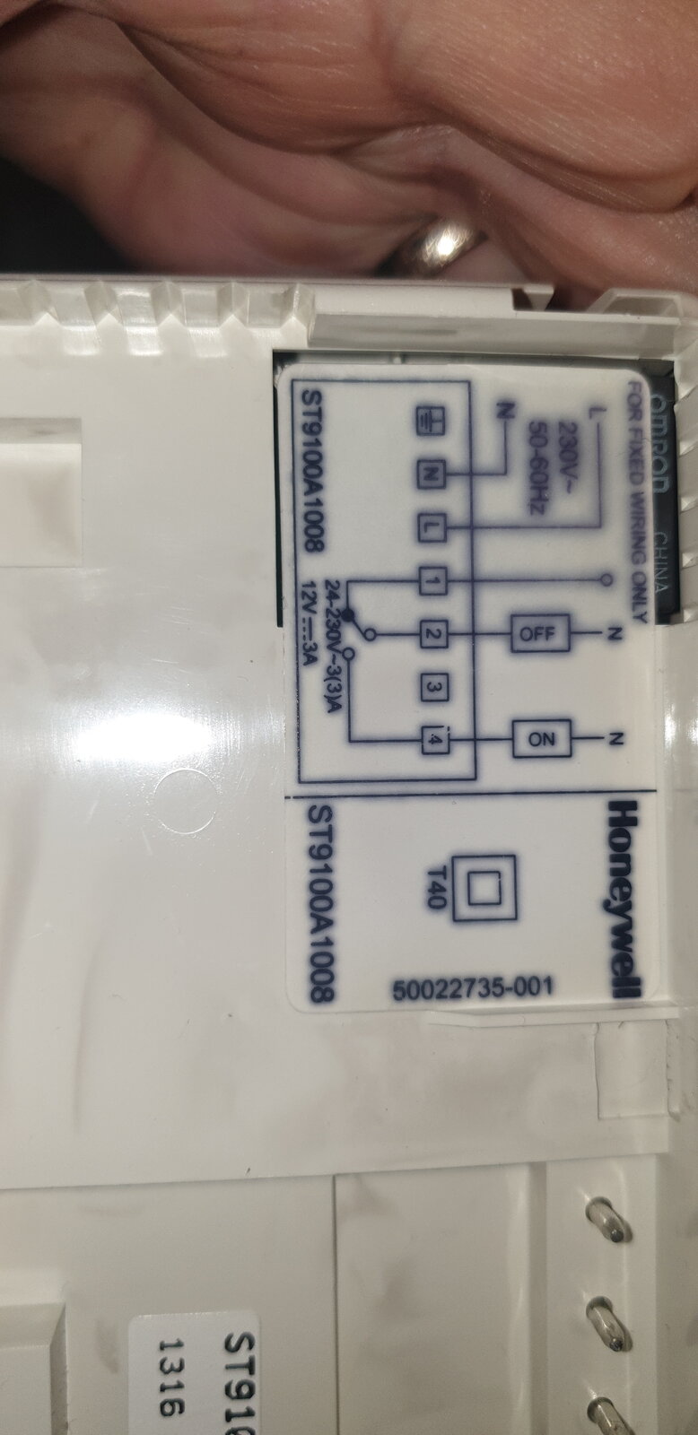

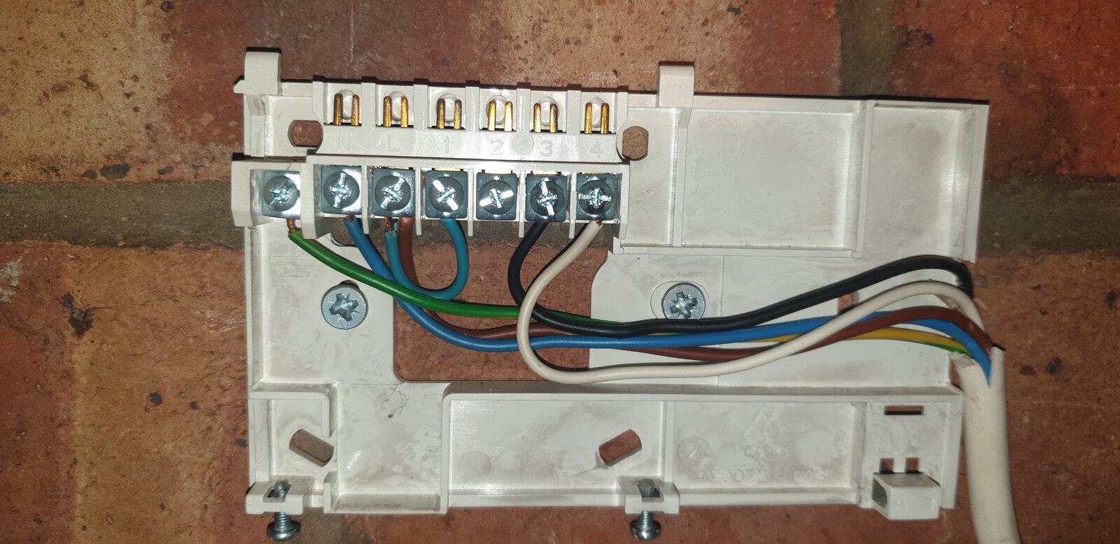

Hi i currently have a Honeywell St9100a programmer which i intend to swap for a dual channel hive. i have an S plan system with hot water tank. The hot water has a pump in the airing cupboard. i have wired it up the same. N L 1 3 and 4. With a loop between L and 1. Boiler is not firing up. Any advice welcome

The link between L & 1 is only required on a Combi that uses 240V switching and then only with the single channel Hive.
You said it's a 2-channel Hive but a Honeywell ST9100A is a single channel controller. What looks after your hot water? What sort of boiler do you have?
The picture of your old wiring looks unusual. terminal #3 has a connection but the ST9100A diagram shows nothing should be there.
However based on the old wiring, it looks like you have a Combi and the connections were
L & N (power)
Earth
#1 link across from L
#3 black core parked here but not used
#4 central heating "on"
For an S-Plan system using a 2-channel hive you should connect L, N for power , 3 for hot-water and 4 for Central heating. The earth tether is a useful spot to connect the Yellow/Green core. 1 & 2 should be left unused. But I have doubts you have an S-Plan system.
As for the roomstat, as cross thread indicates, link it out. But the easiest at this stage is just turn the roomstat up to max. When your system is working you can then link it out properly.

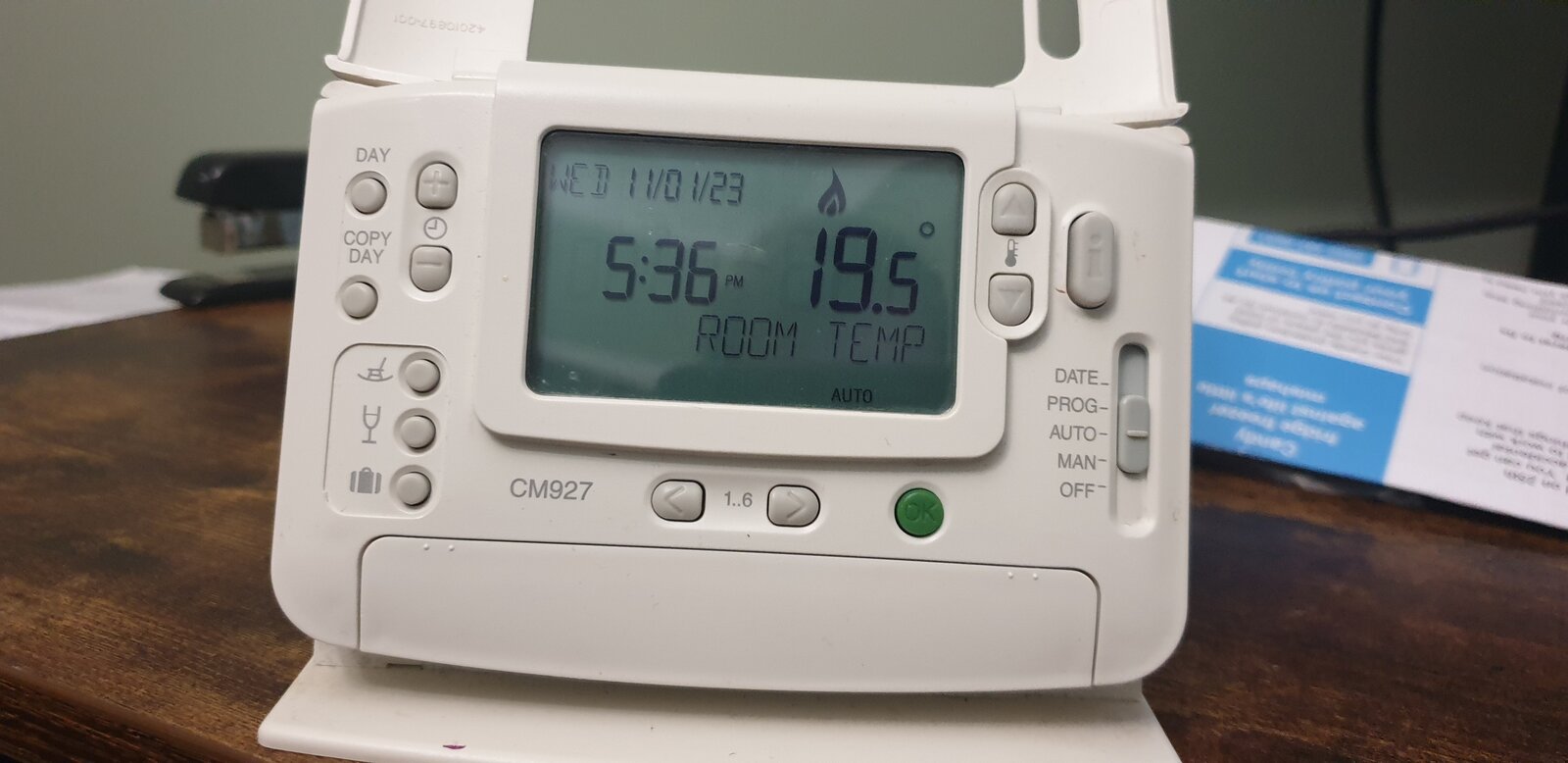

Thermostat was wireless, but has a very old thermostat that is still on the wall
If your prior thermostat was wireless you should have a receiver unit which needs to be linked out then. Otherwise you have an "open circuit" and the boiler will not fire up.

The st9100a is set to always on. i presumed this did the heating and hot water. The thermostat just controls the heating. The wireless thermosat controls the st9100a so i thought all the wiring would be just there. If its more complicated thanthat its beyond me im afraid
Currently you have a single channel controller which if it's permanently on is effectively bypassed. I guess that means your HW is also always on and just controlled by the tank thermostat. Your heating is then managed by the room stat. To swap that out for a 2-channel Hive and provide full control would certainly call for some cabling effort at the wiring centre.
Do you have a picture of your thermostat receiver? You said the stat is wireless, so that implies there is a second box (i.e. receiver). It should be possible in that case to swap out the receiver unit to give you smart heating. You could then leave the existing ST9100A as "always on" or subsequently fully bypass it.
It may be possible to retain the 2-channel Hive and run it looking after a single channel (heating) with the hot water side unused. Or equally swap the 2-channel Hive for a single channel model. Depends on what's at the receiver. All is not lost just yet.
Thanks again Ian. This is the room thermostat. i don't think i have another receiver, i think its just the st9100. Sounds like i may need the single channel and set the hw to always on
