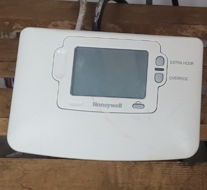

I have an oil fired Potterton statesman boiler that works absolutely fine when the Honeywell st9100c programmer works.

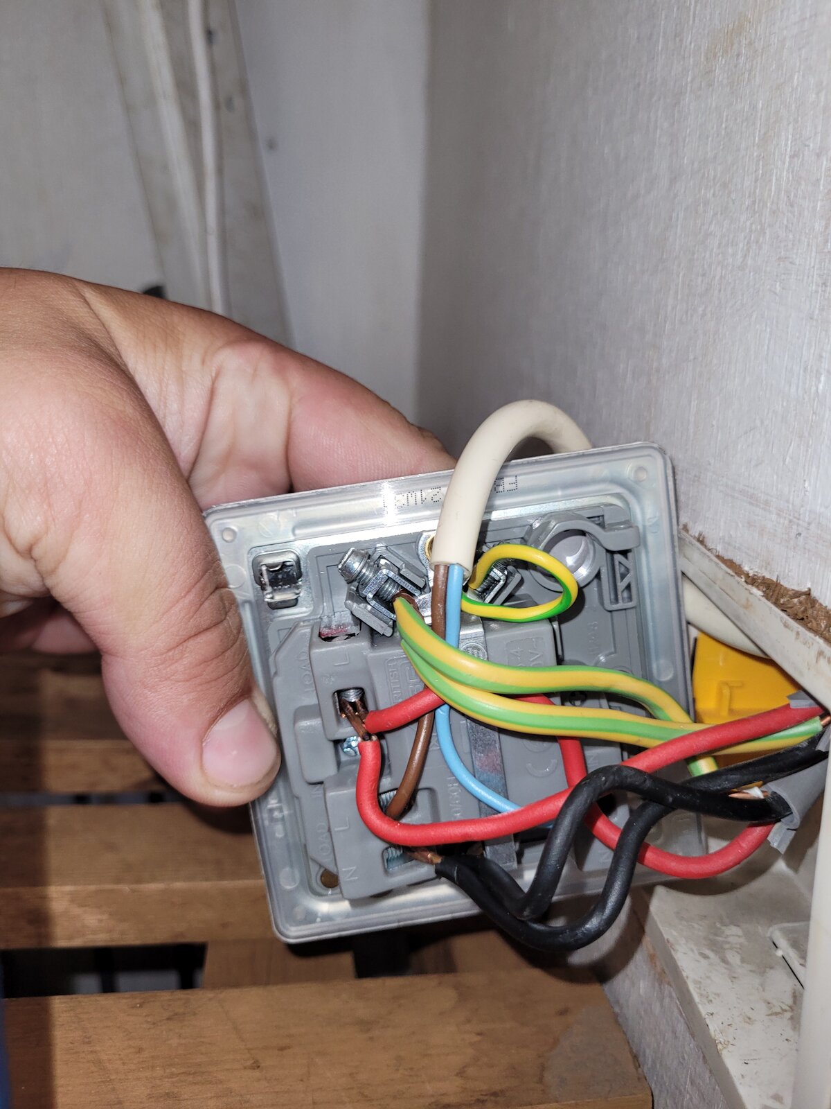

However lately the programmer last about a day and turns off completely. At first, I could change the fuse in the spur and it would power up again for a day but now it won't at all.

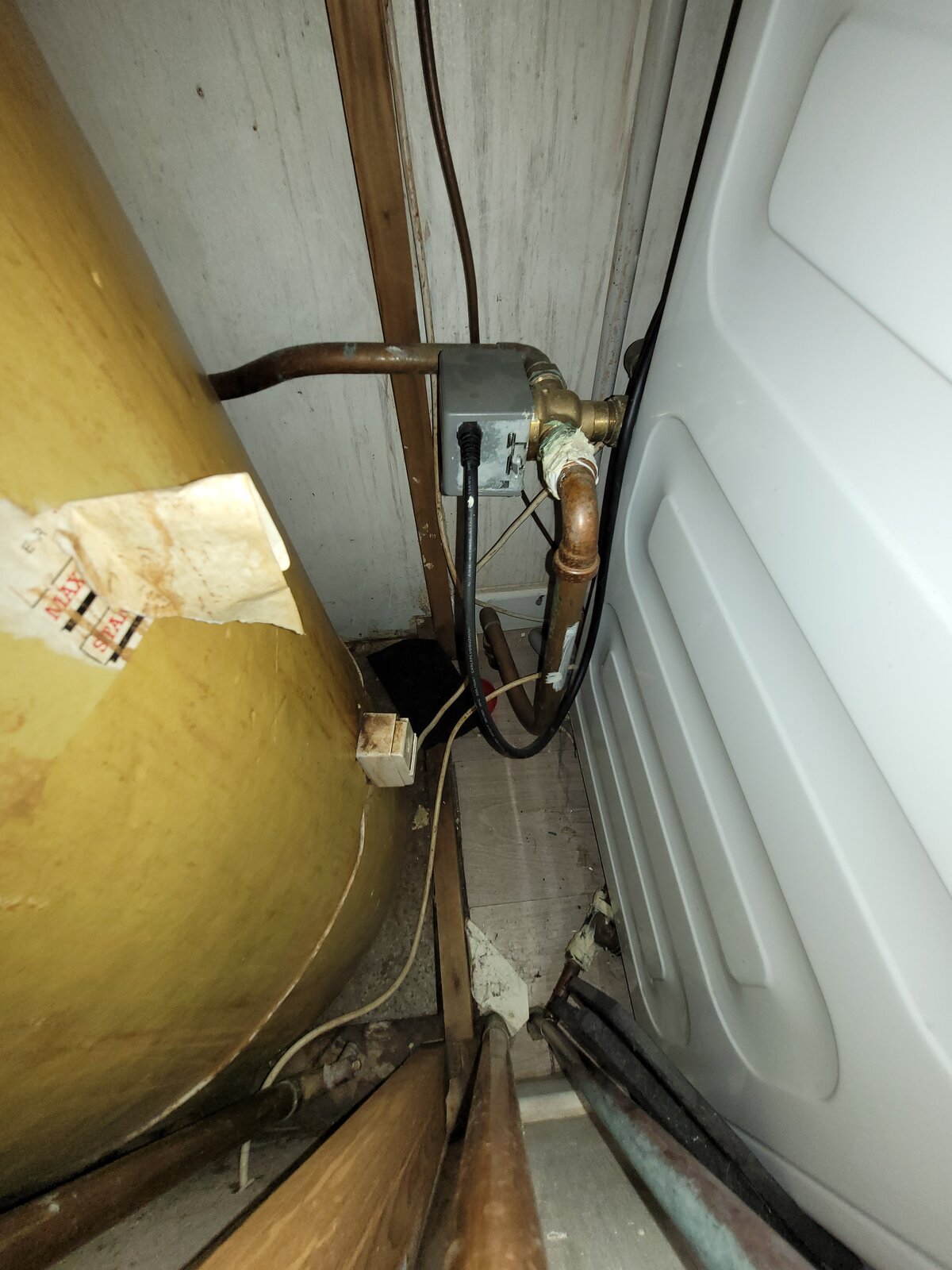

I'm wondering if it is wired wrong or there's not enough voltage to the programmer to come on or even maybe the Honeywell cylinder stat
l641a1039 that may be faulty and stopping it.

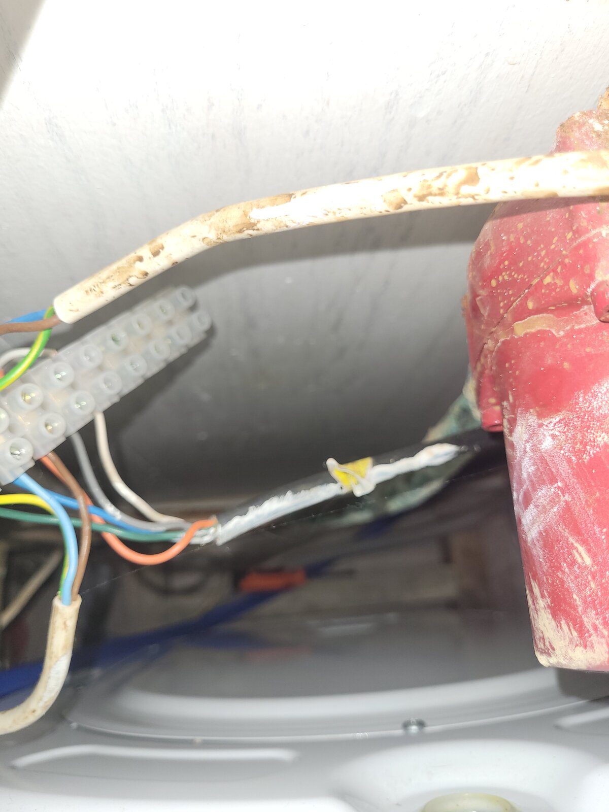

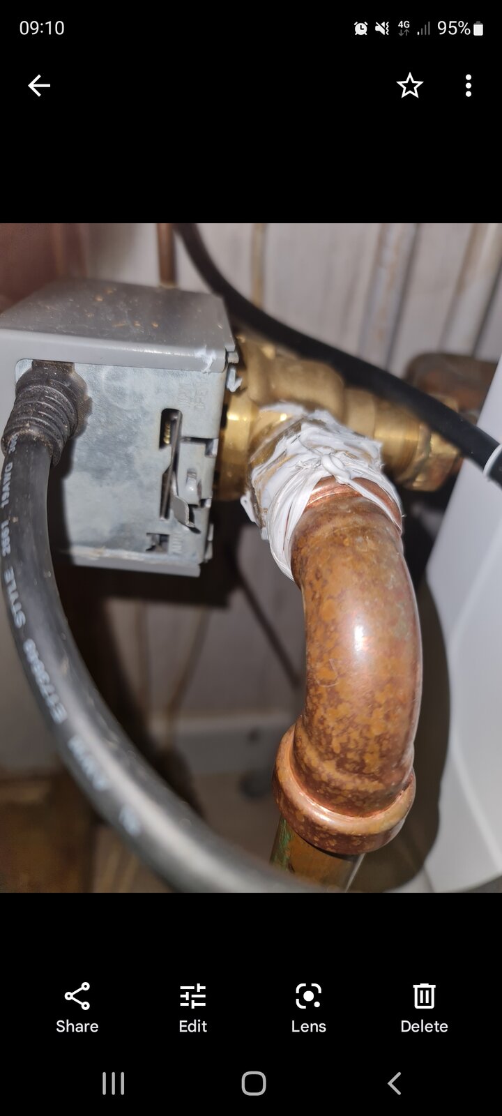

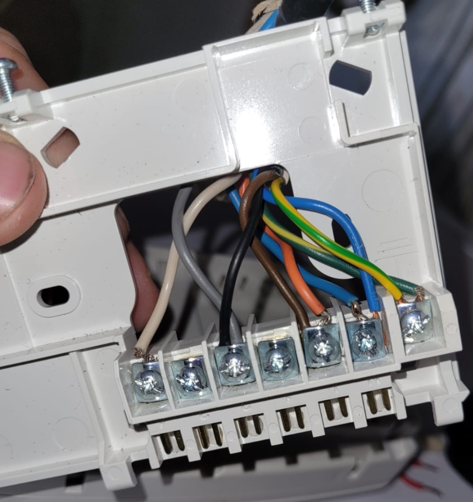

I have attached some pictures of the wiring in the spur, programmer and 10 block for your reference.

Check for any loose/pinched connections would be a good start. Make sure you’re working safely though, if you’re unsure, don’t mess. You haven’t said what area you reside.

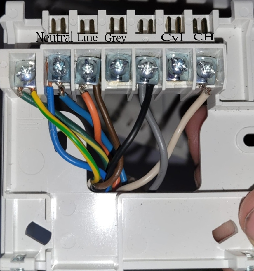

There maybe someone on here who can assist in your area, but some of the terminals in the timer look suspect.
Quick glance, and orange does not seem right.
In the main, wire colours mean nothing, except from the motorised valve, where orange normally goes to boiler and pump.
Basic Y Plan and the boiler is fed direct from tank stat. The motorised valve does nothing to get domestic hot water, as that is the default state.
Should the orange wire be located somewhere else or not at all?

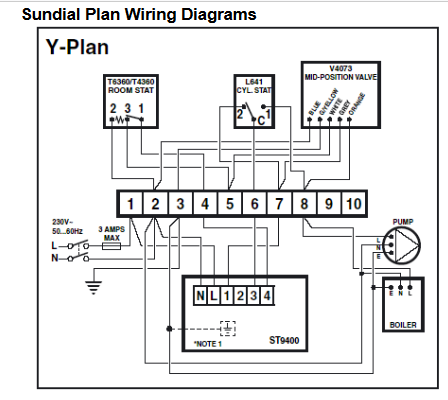

Have an internet search on Y plan or C plan (depending on your setup).
Do you gents perhaps think it maybe the RCD board or a circuit breaker causing the issue? All over appliances on there work unless I put a bigger amp fuse in the spur than a 3 or 5amp it will trip that one circuit.
your programmer wont trip anything, it is what it is controlling that is tripping your electrics, take a pic on your phone and mark the wires, remove and isolate everything except the L.N& E does your programmer now come on ?

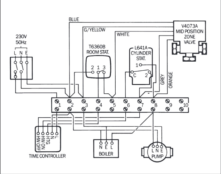

Typical Y Plan, the Orange from the motorised valve goes no where near the programmer here called a time controller.
From the instructions small variations but again no orange to the programmer.
So you have a black and grey going to where there should be no wires, nothing is going to 1 = H/W off, so it will not give central heating only, and nothing going to cylinder stat which should turn hot water on, and the Honeywell ST9100C as far as I can tell is a single channel programmer anyway so could not do CH and DHW however way you wired it.
Typical Y Plan, the Orange from the motorised valve goes no where near the programmer here called a time controller. View attachment 276695From the instructions small variations but again no orange to the programmer. View attachment 276696
Hi mate,
Are you saying remove the orange altogether. I can put grey into one. What color wire should go in to 3 you have marked cylinder?
I have tried with just the three standard wires and still don't come on. I tried a new programmer as well same one but still no joy
It didn't buddy
