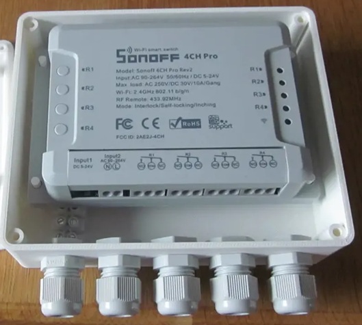

Thank you for all for your input, however after much searching the SONOFF 4CHPROR3 4-Gang Wi-Fi Smart Switch with RF 433MHz RF Control (appr £30) is a fully configurable substitute for a conventional timer and will do exactly what I need for a fraction of the cost of a Hive. No additional hub required, and no subscription for the bells and whistles. Like Hive, he SONOFF is configured and controlled via a phone app (eWeLink), which in my application will give me remote controlled CH and HW timing programs and on/off control.
The SONOFF will only provide on/off control via phone app whereas Hive provides time and temperature control, but if time control is all you want then that won't be a problem for you.
My limited experience with SONOFF is mixed. One I installed for a neighbour (his choice not mine) had communication errors after a power cut that took a lot of resolving, and I'm not overly impressed with the build quality either. The wiring terminals are small and very close together, so installation can be quite difficult, as any exposed conductor showing outside of the terminal runs a high risk of touching the one next to it. Unless the design has changed, they also have exposed live terminals so the whole thing needs to be installed in an additional enclosure.
Stem, thanks for the heads-up re terminations. I'll bear that in mind when I come to install one.
The SONOFF is far from perfect from the reviews I have read online, but on the whole, it seems a reasonable option and if all goes pear shaped, not difficult to re-instate a conventional boiler time clock.
