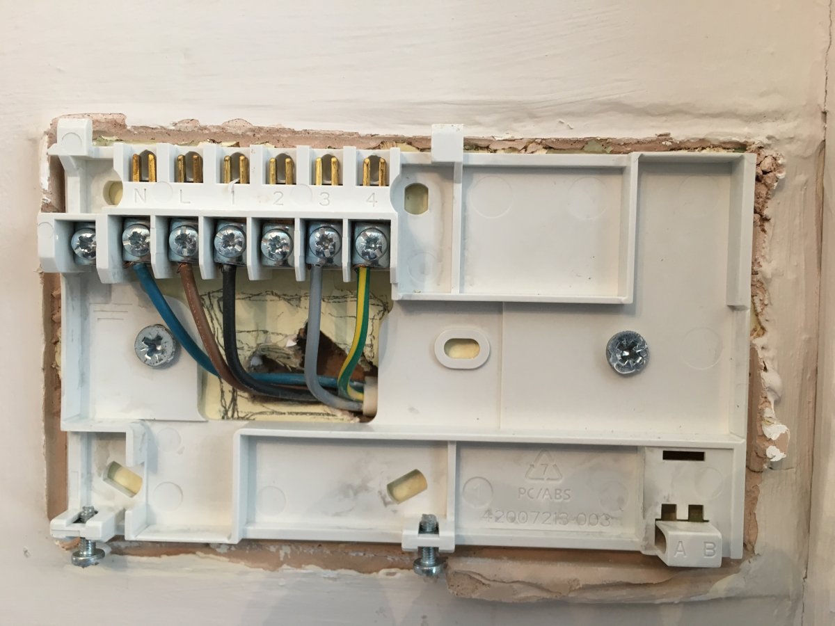

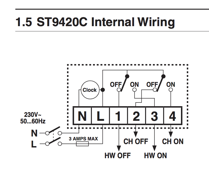

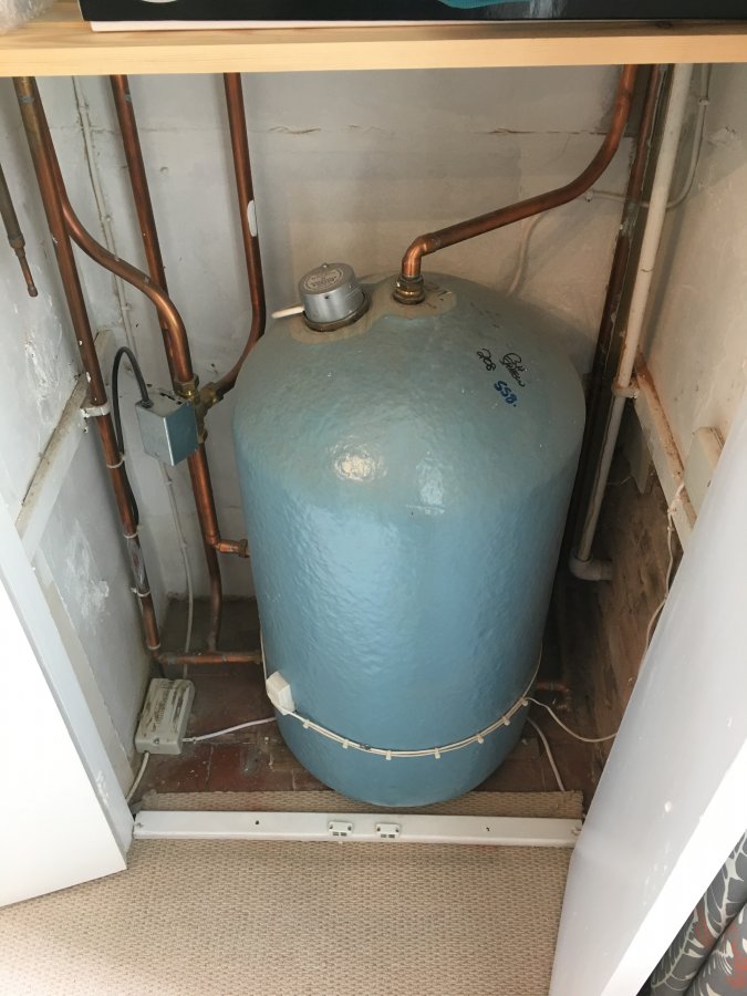

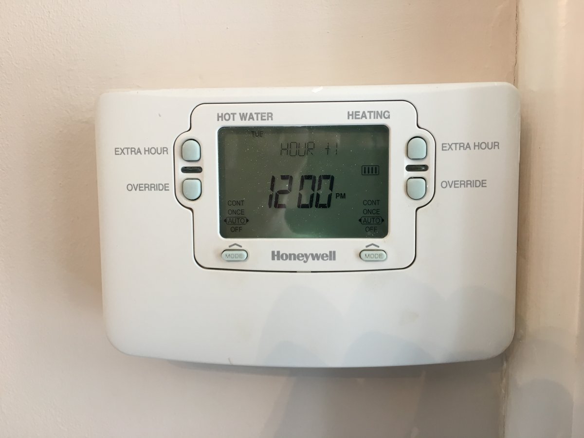

Hi,
I'm currently looking to change to a HIVE system. At present I have a Honeywell ST9420c timer with wireless thermostat and wireless cylinder stat. I believe that I have a Y plan system as I only have one 3 way port and a pump.
At present the Honeywell timer ST9420c has the following wires:
  • Blue (neutral)
  • Brown (live)
  • Black (HW Off)
  • Grey (HW On)
  • Yellow/green (CH on) - bad practice to use earth, I've just found it like that
Boiler Model: Worcester Greenstar Ri
Questions:
1) Can I simply swap out the timer for the HIVE 2, even though I don't have a CH off?
2) Can I simply remove the wireless cylinder stat without replacing it?
Thanks for your help, I've attached a couple of pictures to help.

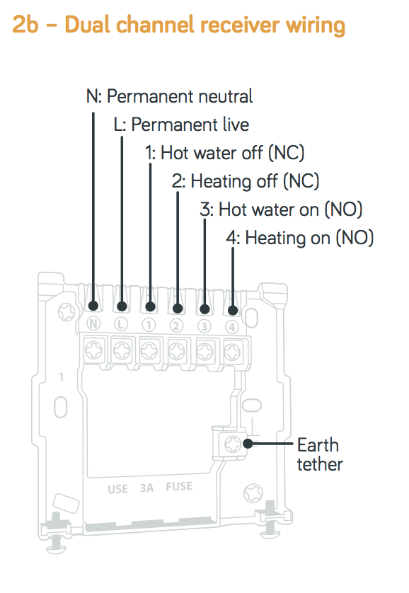

Sorry forgot to attach the Hive wiring diagram.
