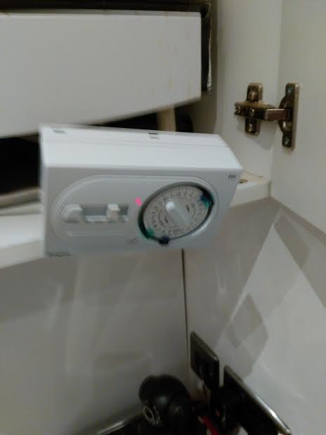

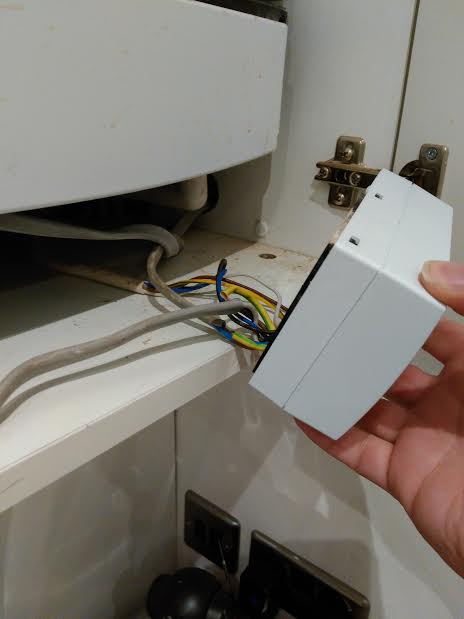

How difficult is the cm927 to install, bearing in mind this is the current istallation (see pics)

When we see a mess like your pictures, we wonder what other nasties are lurking underneath.

That is an absolute abortion of an installation. I would have it checked out.
That's a polite way of putting it, that wiring is f****** s***. The timer isn't even fixed to a wall! What installer in their right mind would consider that installation acceptable, or even safe enough to hand over to the customer?
My guess is that the installer didn't leave it like that. Ive now gone into columbo mode and I think I can see some sawdust in the cupboard. So I deduce that the previous owner did a diy kitchen refit and decided that he didn't want the programmer on show.
