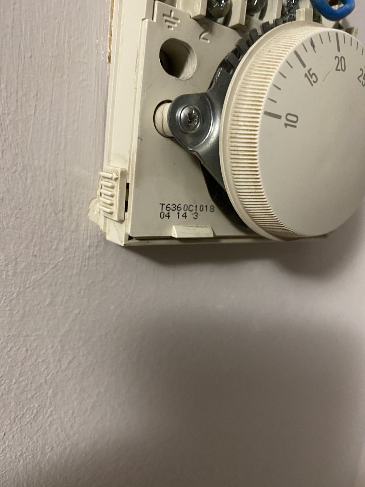

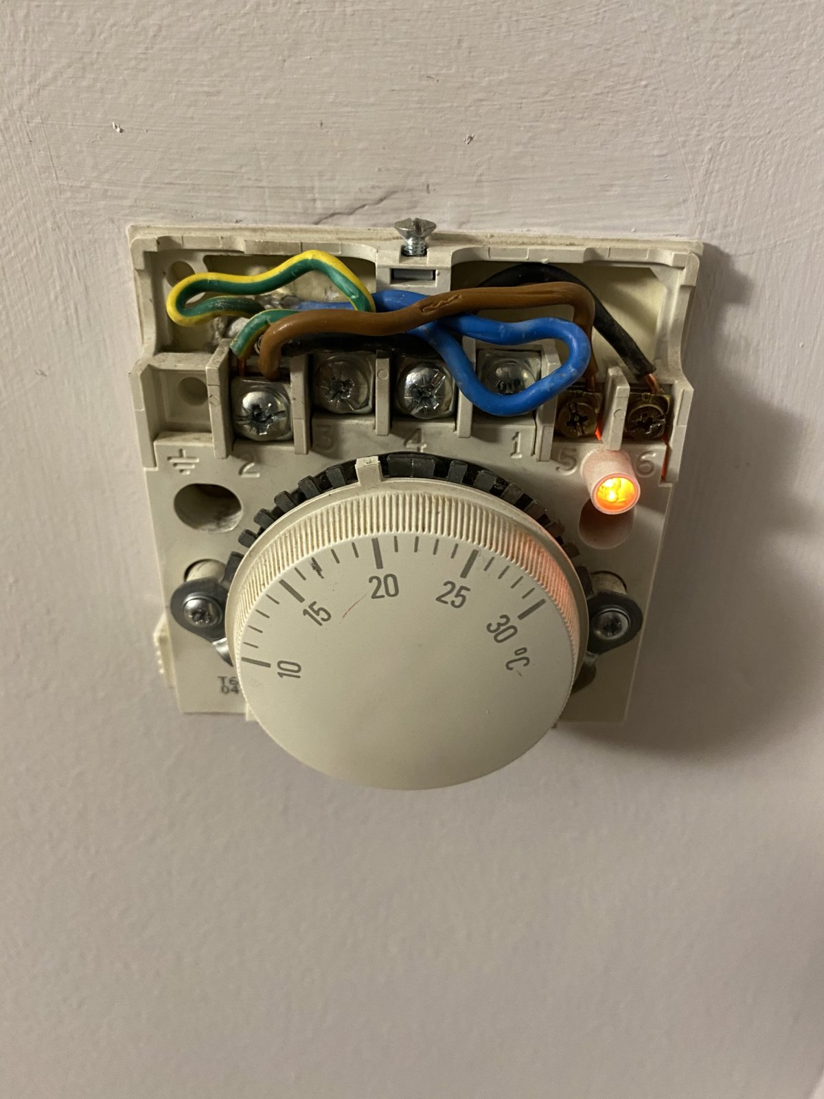

I have this thermostat,T6360C.

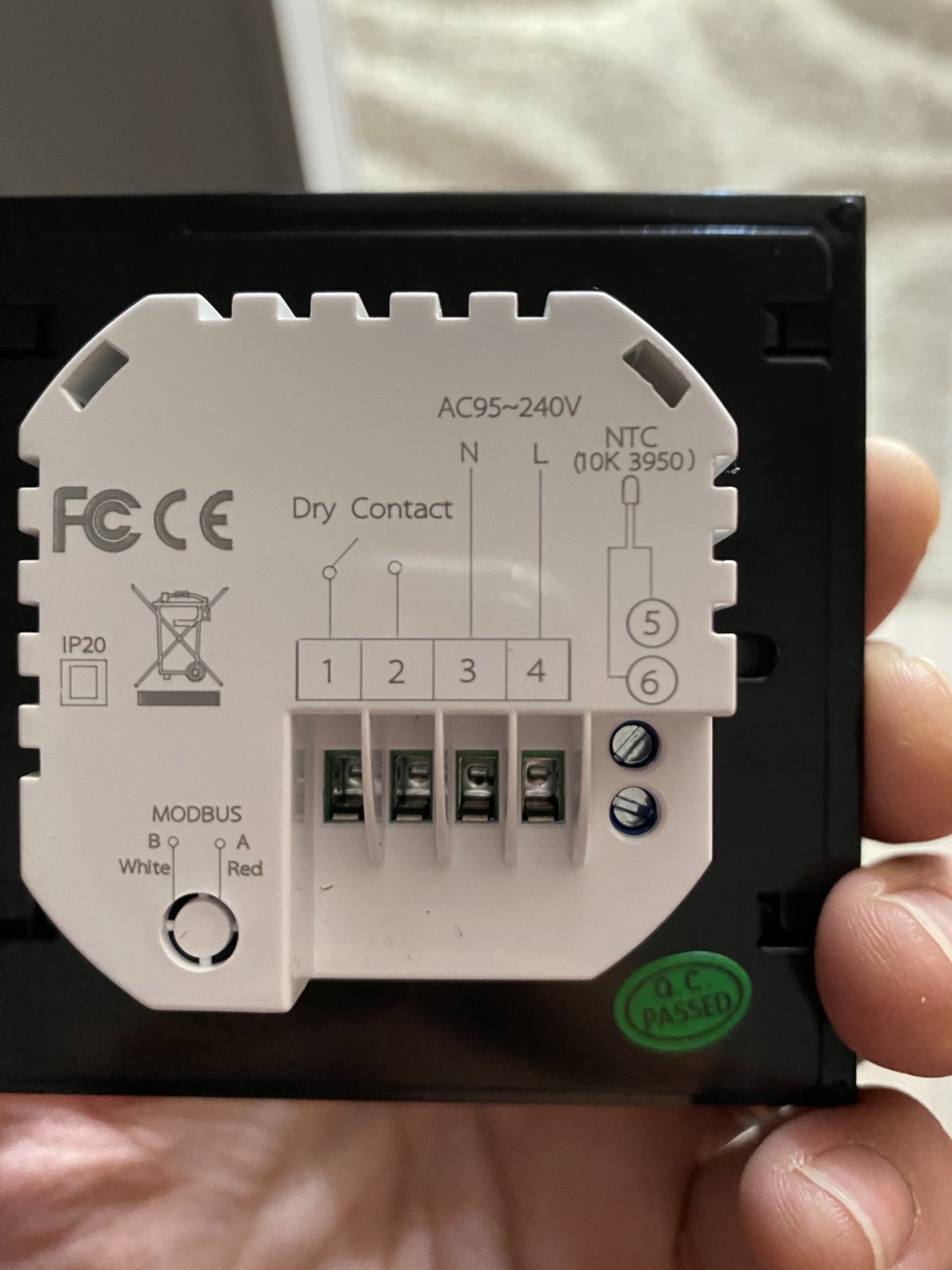

I bought another one BHT-GCLW.the wall has 3 wires.
Anyone to help me with connection?

The Honeywell terminals from the diagram below are:
full

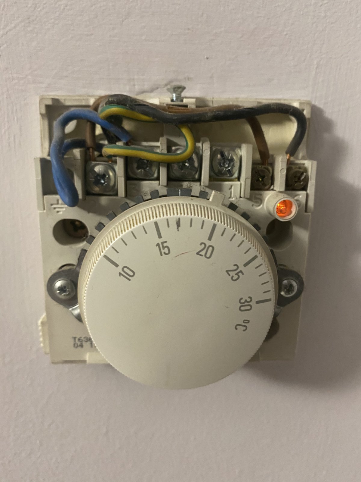

It's difficult to see in your photo where the wires are connected, I can't see a wire in terminal 4 so assume the thermostat is only being used to control heating and not cooling then the connections required are:
2=L
3=Heating Switched Live (Heating on)
6=N
Assuming that the existing thermostat has been wired correctly. Please check this with a multimeter first to be sure.
Honeywell L=New Stat L
Honeywell N=New Stat N
Honeywell 3= New Stat 2
The new stat requires an additional link between L and 1
Ok. Sorry my mistake.
It appears not to be twin&earth but single wires.
So it is ok to sleeve the Green/Yellow with Brown as it is a Live conductor.
