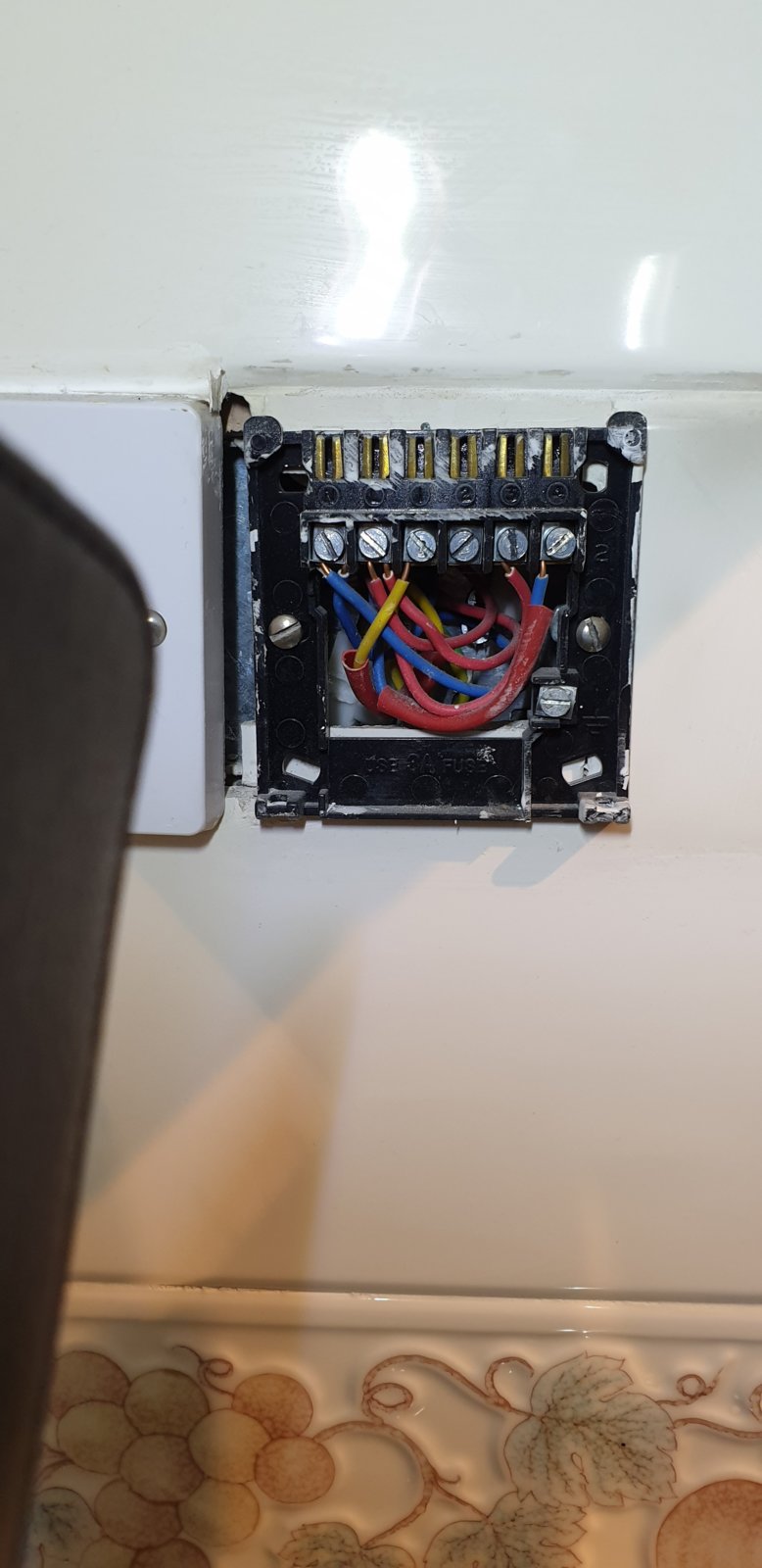

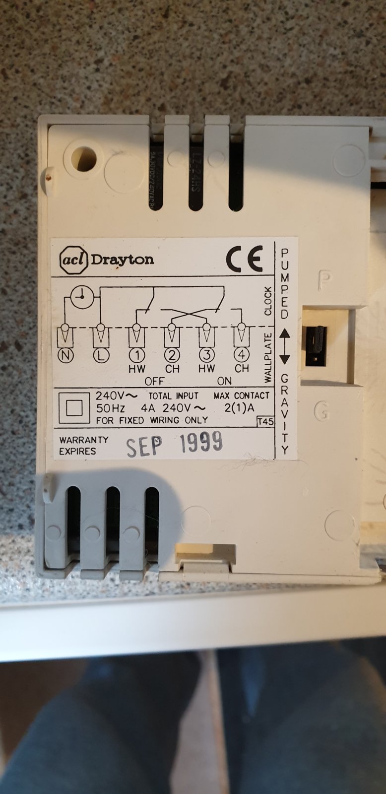

Hi, I'm looking to replace an acl/drayton LP241 with a Honeywell t6r-hw. It's an Ideal classic ff250 on a s-plan system I think (vented hot water cylinder and 2 motorised valves). The existing programmer wiring is like this:
Looking at the wiring diagram on the t6r-hw instructions should it be wired:
Neutral from old to N on new
Live from old to L on new
1 from old to E on new
3 from old to D on new
4 from old to B on new
Link L to A on new
Sorry for the sideways image!
Is this correct? Thanks in advance, parpat.

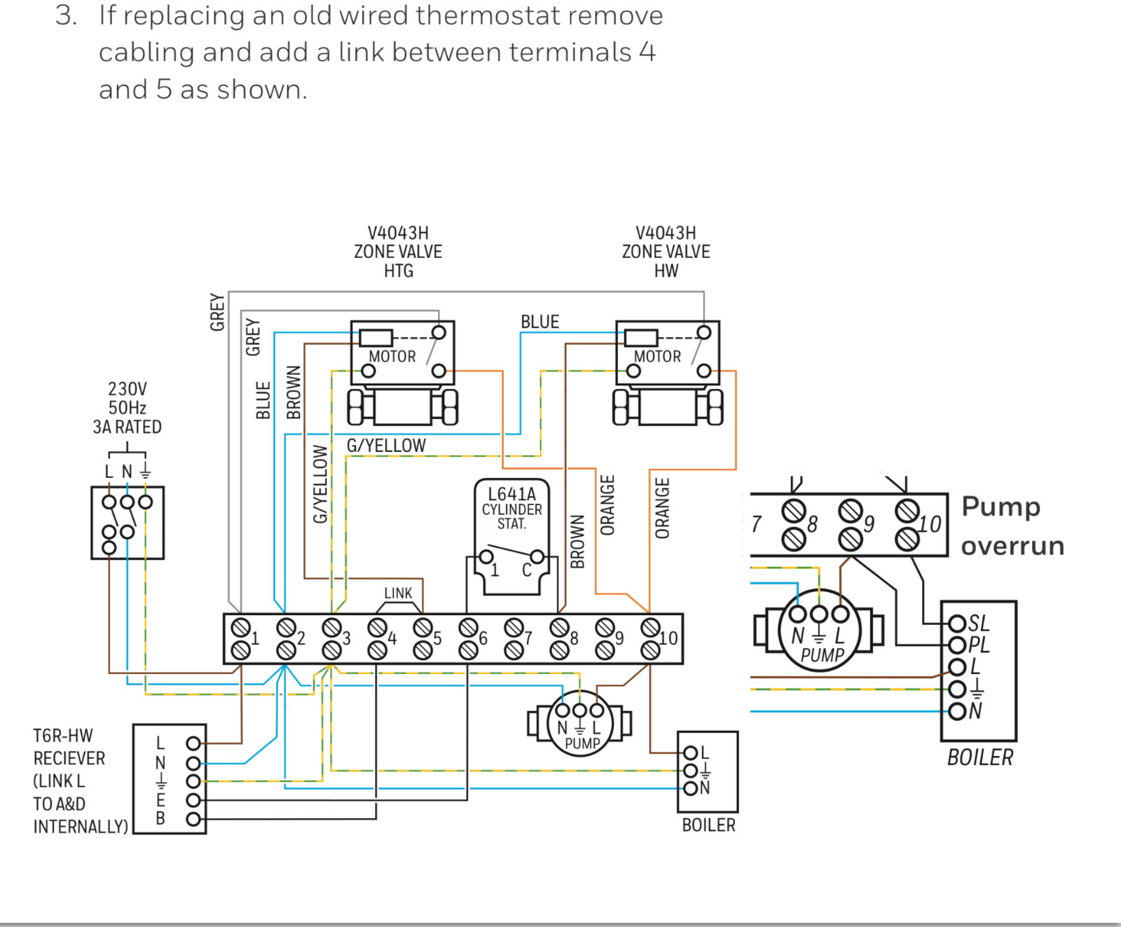

Hello Parpat,
I think you need a link from L-A-D, I’m not 100% on the rest as it appears there might be internal switching off, so I think it might be
Link L - A - D
3 from old to E on new
I’m sure I’ll be corrected if it’s wrong, usually @stem or @ianmcd as they’re more experienced than me.
The Novice is right.
A and D are common and so need to be linked to L to provide 230V switching. I do not think the T6R-HW is internally linked looking at the manual.
Taken from Honeywell’s wiring app, it states A&D to be linked internally

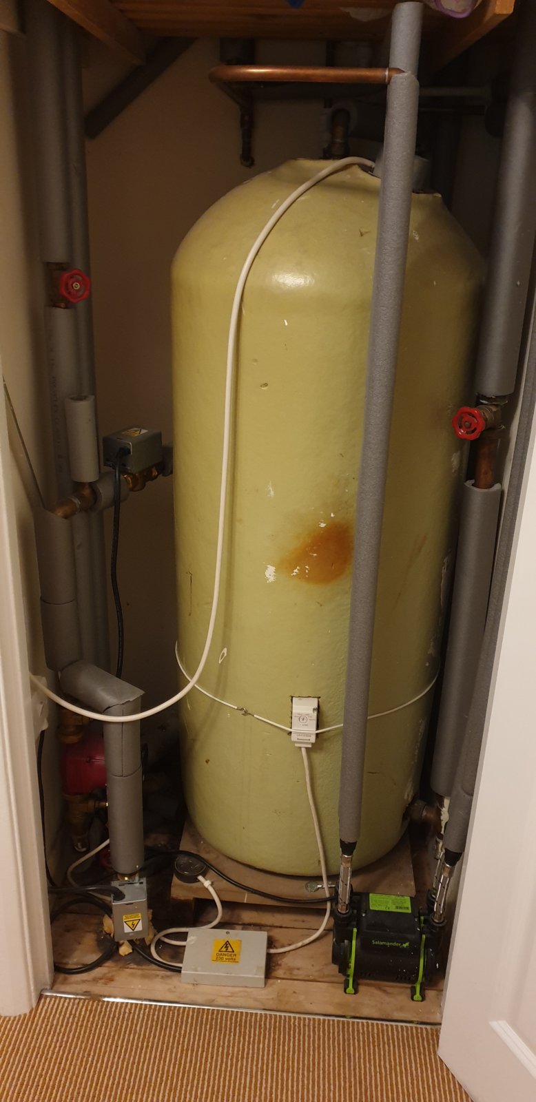

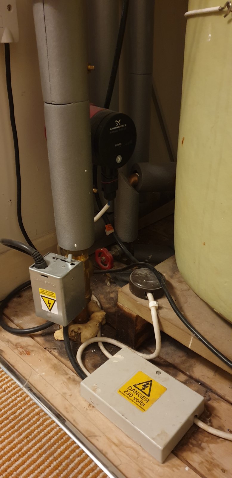

Thanks for the replies everyone.
Pictures of cylinder and motorised valves.
Thanks again for your help.
Parpat.
