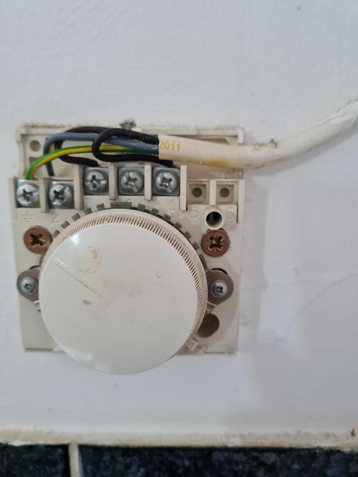

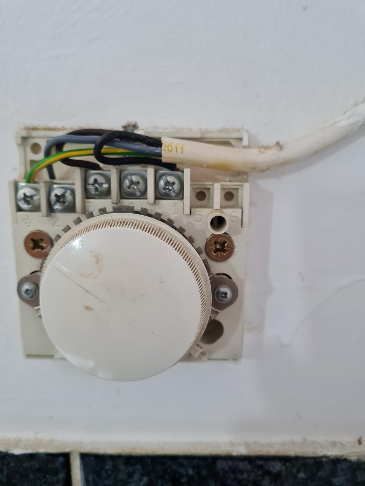

Hi
I have just replaced a Honeywell Thermostat but the dial is working the opposite way?
It turns off when I turn it to 30 and Turns on when I turn it to 10?
Help please?
Here is a picture of the wiring
Many Thanks
Also the neutral wire is not connected
Does this make a difference?

According to your picture there is a neutral but you cannot be 100% sure it is one without testing, (the blue wire.)
If you’re referring to the blue as a neutral then it only matters for temperature swings, if it is a neutral wire. I suspect the live and switched are the wrong way around (1 and 3)

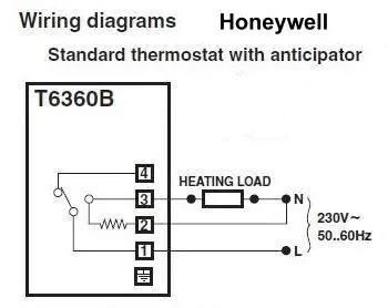

The wiring as shown in your photo looks right to me. Assuming that it is a T6360B. The model number and diagram will be inside the lid. For it to work in reverse I would expect terminals 1 & 4 to be connected, and not 1 & 3.
From the T6360B diagram below:
1=Live
2=Neutral
3=Switched Live
In any case swapping the wires in 1 and 3 over won't do anything to correct reverse operation. The thermostat is just an on/off switch and the two wires in 1 and 3 will still be electrically connected together by the switch regardless of which way around they are connected.
For accuracy though it is important that the switched live wire is connected to terminal 3 though, otherwise the 'anticipator' shown by the zig zag pattern will be on permanently so won't enhance the accuracy, it needs to be switched on and off with the heating.

Just found this, which seems what the OP is suffering: https://support.esicontrols.co.uk/f...er-temperatures-and-on-at-lower-temperatures/

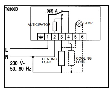

Can't the OPs stat be used in a cooling mode, switching on a AC unit or whatever?.
Yes it could, because terminal 4 becomes live when heat is not required. This is the position it's shown in on the diagram. Hence my comment:
Here's a diagram showing the T630B with an optional COOLING LOAD connected to terminal 4
i take it that is a pic of your old one before you changed it
The picture looks like an old thermostat, so likely as was before it was changed, the order of the terminals can easy cause a problem, earth, 2, 3, 4, 1, 5, 6. is asking for problems, people expect 1, 2, 3, 4, 5, etc.
