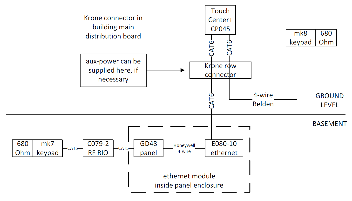

Hi,
I'm having frequent (couple times a day) keyboard lost-problem with TouchCenter Plus connected to GD-48 (firmware 7.something). Keyboard diagnostics give connection quality varying between 0% and 100%. Cabling is Cat5 unshielded/ Cat6 shielded, last part to mk8 keyboard is 2-pair shielded Belden. There's short (about 20cm) internal run of untwisted 4-wire between panel and Ethernet module inside panel enclosure, this wire came with ethernet-module. Both ends have 680Ohm resistors and power supply is from panel. Total bus length is between 20m and 30m, closer to 20m I think. There's one Krone-row connector (located in main distribution board), where pairs are connected, pairs are correct, twisting has been preserved and topology is definitely bus, not star or something else. Picture of all devices and bus topology attached.
The weird thing, mk8 keyboard has communication quality of 100% and it's last device on bus after TouchCenter Plus. I have already tried with two different TC+, always same problem. Clear wire is connected on Cat6 between all the runs, haven't connected the shielding to anything, can it cause problem like this? If this is power-problem, I can supply ground level devices from separate power supply with battery backup used for smoke detectors, it has enoguh spare capacity. If problem is caused by shielding, should it be connected at both ends (panel, distribution board), or only single end (which one)?

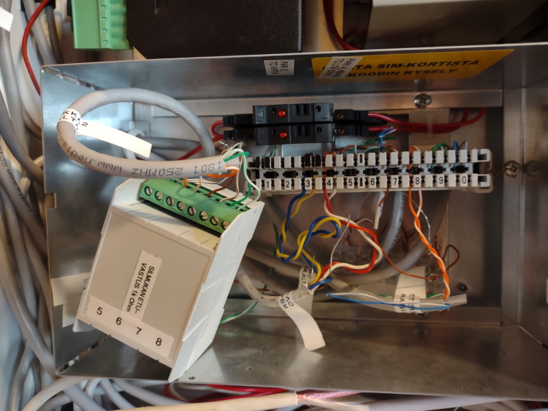

With the power off, what is the resistance of a and b with respect to 0v ?

Got this sorted out, I guess, or at least it's been working for about week without issues. Resistance was around nominal 680 Ohm. Thing that seemed to help was using separate power supply for TC+ and Mk8 keypad. They are supplied now by same PSU as my fire alarms. TC+ gives still low communication quality occasionally in diagnostics, but it's not dropping comletely anymore. Mk8 has still high communication (100%). One of my TC+ was bought from eBay, the later one from security retailer. Got outputs working too, issue was with reversed wiring. Now I can turn on my yard lights and block heater from TC+ :mrgreen:
Okay, good. It sounds like there was some voltage drop over your cable lengths. This would be more apparent with the TC, as they consume more current than the regular keypads.

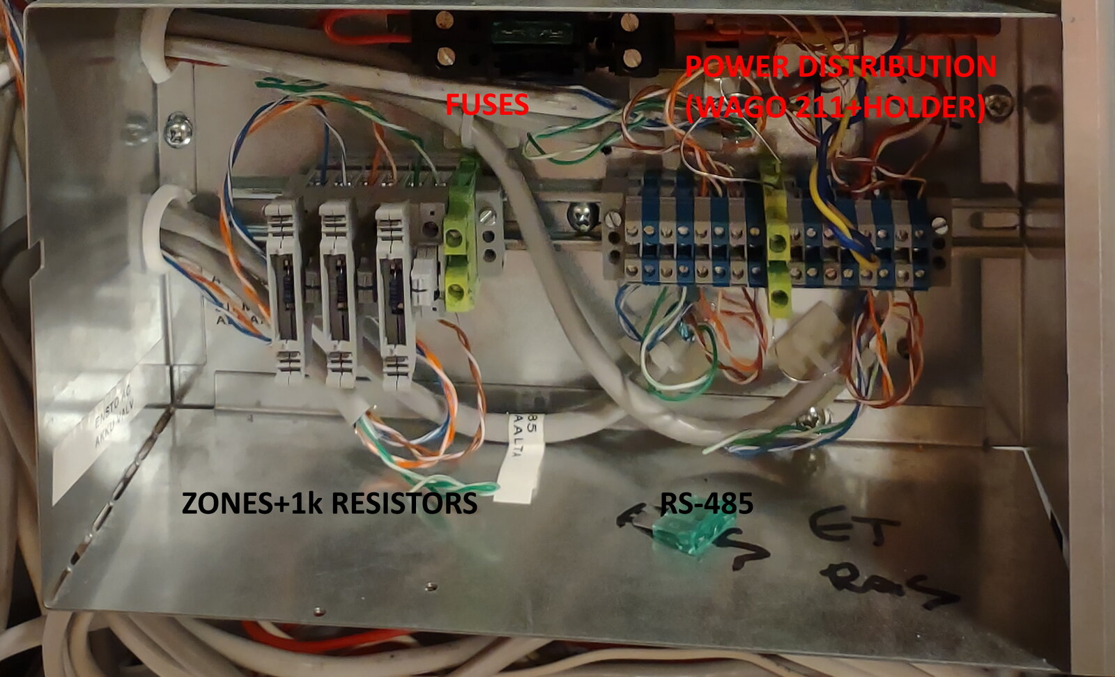

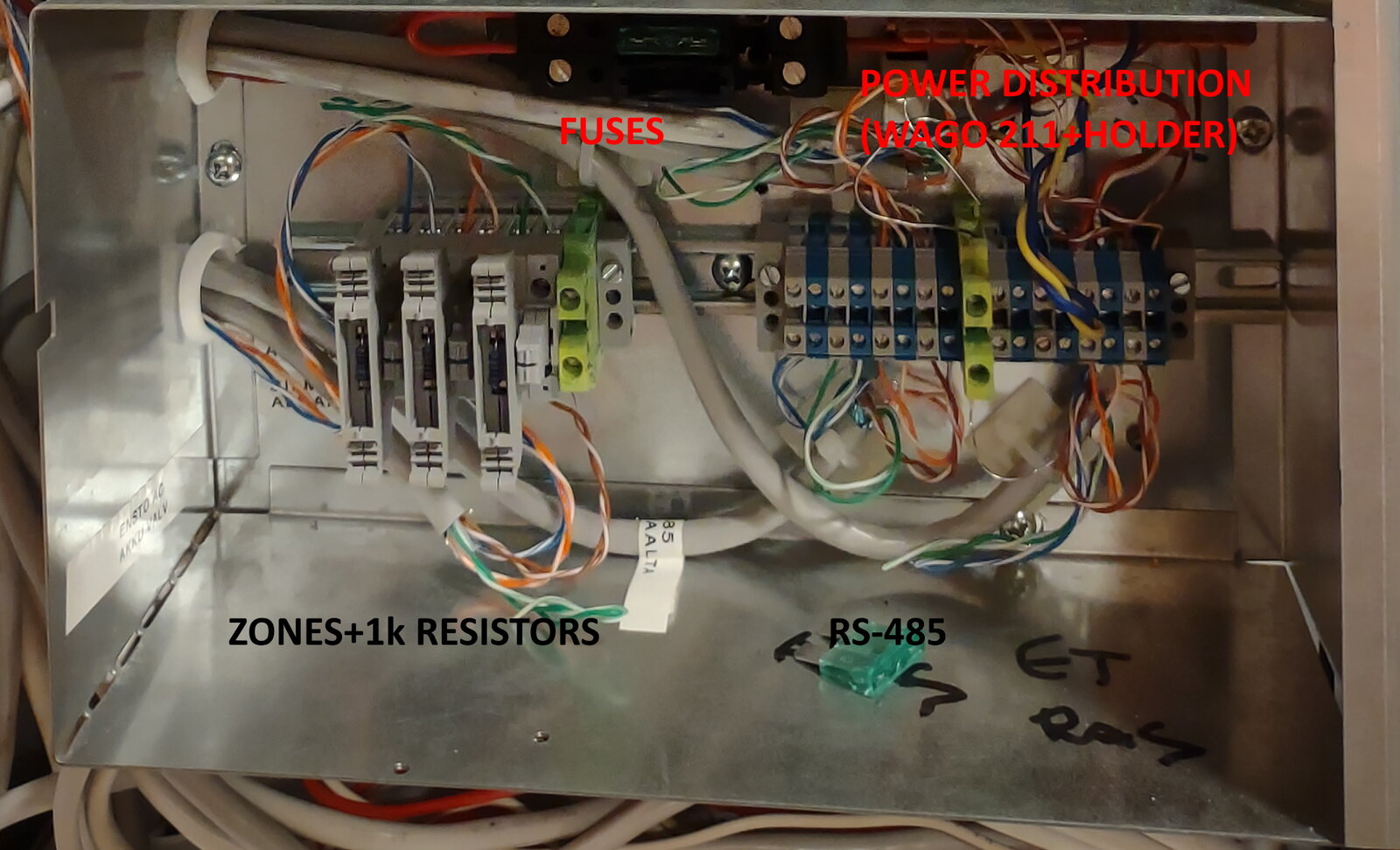

Did recently some tidying on my Dimension connectors, attached are "before" and "after" pictures, I guess it's easy to see which one is before and which one after. Replacing Krone-row connector and other shady components improved reliability even more, comms quality on TC+ is constantly around 40%, which makes it finally reliable. New connections are made using Phoenix Contact Mini block-row connectors on a 17mm component rail. Mini blocks are very compact compared to full size DIN-rail components and they are very flexible: resistors are installed on component holders, that can be simply plugged and removed as necessary. Non-resistor connector has simple bridge piece, that is also simple to attach and remove. I used Wago 211-connectors for power distribution and to make it tidy, installed them in holder. Mini blocks were by no means cheap, but reliability is more important.

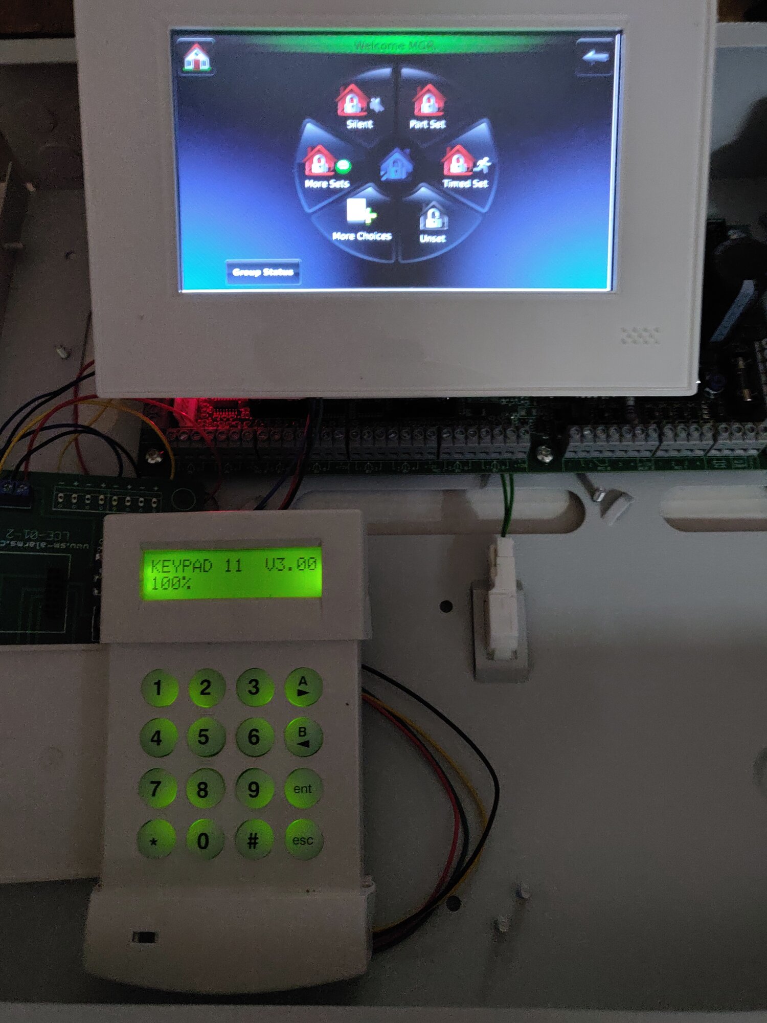

There's definitely something wrong with your setup. 40% on the TC+ is really bad. It means that for every 100 packets of data being sent to the touchcenter, 60 are either missing or corrupted. This will make the keypad unreliable and needs to be fixed or you'll end up with full blown tampers for keypad loss when the system is set. The 60% retries will also slow down the bus, slowing apps via Ethernet and other keypads.
From above, it looks like you measured the resistance between A and B and that doesn't inform much. A bus communication at 40% suggests only one side of the differential pair is actually working. I would expect one of the following to be true.
- The A or B line is not properly connected to the touchcenter and open circuit.
- The A or B line is being dragged down to 0v. Confirm this by testing resistance between 0v and A, then 0v and B with the power off. Do this at both the panel and at the touchcenter keypad with the power off. These resistances will give an indication of where the fault is.
- The touchcenter may be faulty.
Here you can see a TC+ and a Keyprox. Both are consistently at 100%.
