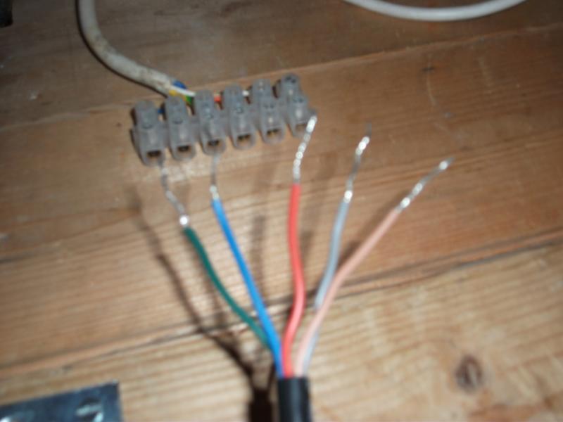

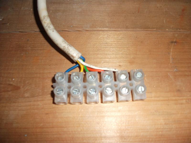

Hi. I've managed to get three reasonably good pictures.
The old Sunvic unit was running into the connector block shown in the picture 'like for like' according to the colour of each wire, basically a continuation of the white five core cable.
The Honeywell unit (black five core) now needs to go into the connector in place of the old Sunvic, but the colours are not all the same.

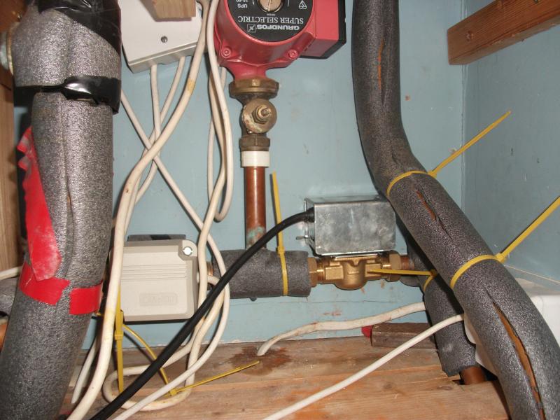

The other picture shows my set up. Two zone valves. one for hot water and one for heating. You can also see the pump just above the two valves.
Does this help?

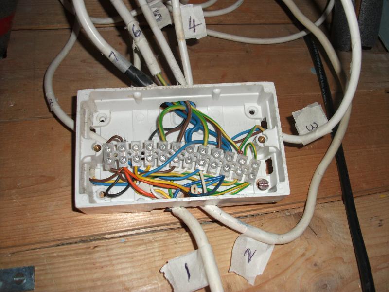

wanted a pic of the cable in the wiring centre where it joins the others together.
Sorry lost me again. Is the wiring centre the white box that is to the left of the pump. This is where all the cables runs back to?

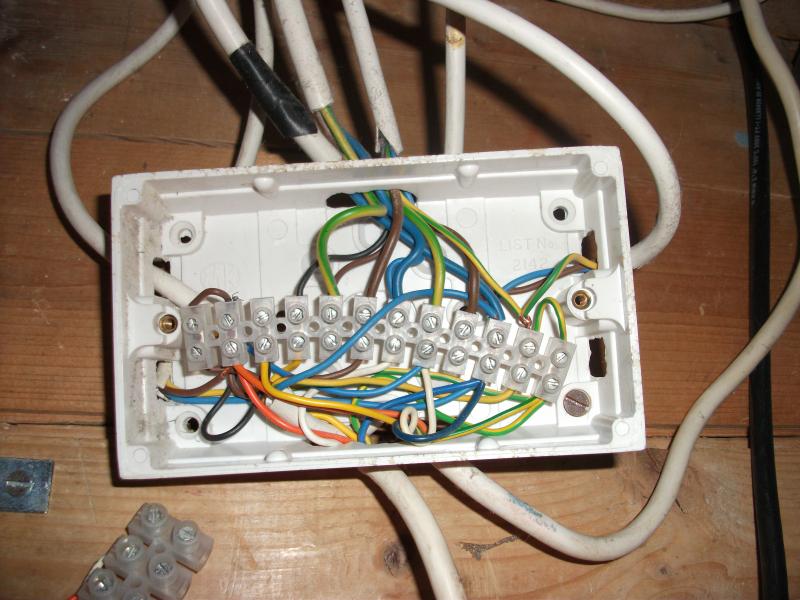

I have taken pictures of the centre as requested. The two pics are the same, but one has the cables numbered so you know where they go to on the system. Working from the bottom left in an anti-clockwise direction. cable 1 goes to the Honeywell valve that I'm trying to wire up. cable 2 goes to the remaining Sunvic valve, cable 3 goes to the 13amp power supply, cable 4 goes to the pump, cable 5 goes to the wall thermostat, cable 6&7 go to the wall mounted control unit, cable 8 to a water temperature device mounted on the side of the hot water cyclinder.

the following can be connected as such
Sunvic Unit ----- Honeywell Unit
Orange --------- Orange
Blue ------------ Blue
Green/Yellow - Green/Yellow
yellow ---------- Brown
now stop
the white on the old sunvic unit is connected to the thermostat satisfied terminal, the honeywell does not need this so disconnect it/make safe
the honeywell grey needs to be connected to a permanent live so connect the grey in with the brown of cable 3
Matt
edited to correct glaring mistake spotted by seco! :oops:

get rid of that extra length of wire and join the new cable straight to the wiring centre.
fit your earth neutral.
wiring centre------------------------- honeywell valve.
from left
term 3 remove yellow.-------------------fit the brown.
term 8 remove white. -------------------fit grey in term 9
the y/gr & blue left in term 8 are heating satisfied they are not used now.
