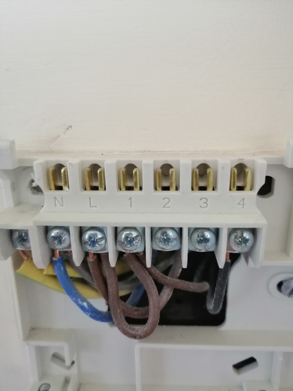

I current have installed a honeywell st9100c timer as per the image with the wires.

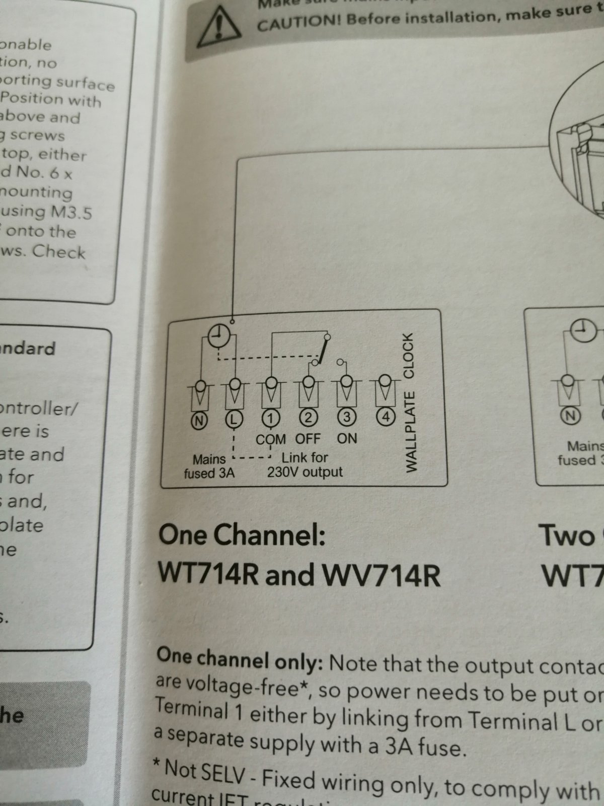

We are in the process of installing a Drayton wiser timer and the wiring in the unit needs to be as per the wiring diagram
Please can someone tell me which wires go where as per the wiring diagram
Thanks in advance for your help

Honeywell --- Drayton
N ------------N
L ------------L
1 ----------- 1
2 ----------- 2
3 (Not used)
4 ----------- 3
4 (not used)
The earth wire (green/yellow) can be left in place or can be connected to a terminal block hidden behind the backplate.
The Wiser will fit on the existing backplate so, if you are installing the Wiser in the same place as the old ST9100, all you need to do is move the wire from terminal 4 to terminal 3, and the job is done.
Make sure you turn the electricity off while working on the backplate.
