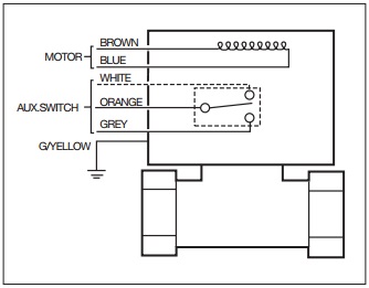

The white wire provides a signal from the microswitch inside the motorised valve that becomes live when the valve closes.
This wire is provided for use with systems that are configured as a C-Plan and have gravity circulation of the Hot Water and only pumped Central Heating. It allows the HW to call for heat without causing the pump to run if CH isn't needed.
So, if you have a C-Plan, then the answer is no, as it performs a required function. If you have an alternative system, then it likely will be OK without.

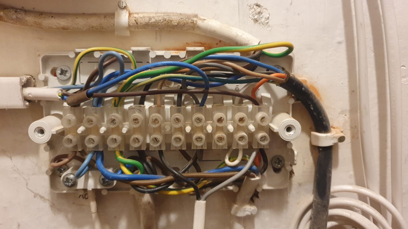

the white wire is connected to the wiring centre but no other wires with it. The problem is I don't know what type of system it is - boiler, hot water cylinder in airing cupboard, water tank in the loft, one zone valve, honeywell controller thats used just for the hot water, and netamo that controls the heating. The hot water comes on okay with the programmer but the heating doesnt with the netamo or even if i set the programmer to constant.

If there is only one motorised valve fitted to the system, then it does sound like a C-Plan and your description of how it isn't working would correspond to a C-Plan with out the white wire connected. [It's what controls the boiler when the Central Heating is required but the Hot Water isn't] Also as @oldbuffer a C-Plan motorised valve is usually 28mm. Is yours?
Your post is somewhat contradictive though.
one zone valve,
just to add - also a valve up next to the hot water tank (different part code) and a thermostat on the hot water tank.
If it is a C-Plan and my theory is correct that would mean it would never have worked properly. Is that the case? If it has worked correctly in the past, then stopped, has anything happened / been changed between it working and not working?
If there are 2 motorised valves then it won't be a C-Plan. However I only see one motorised valve cable at the wiring centre.

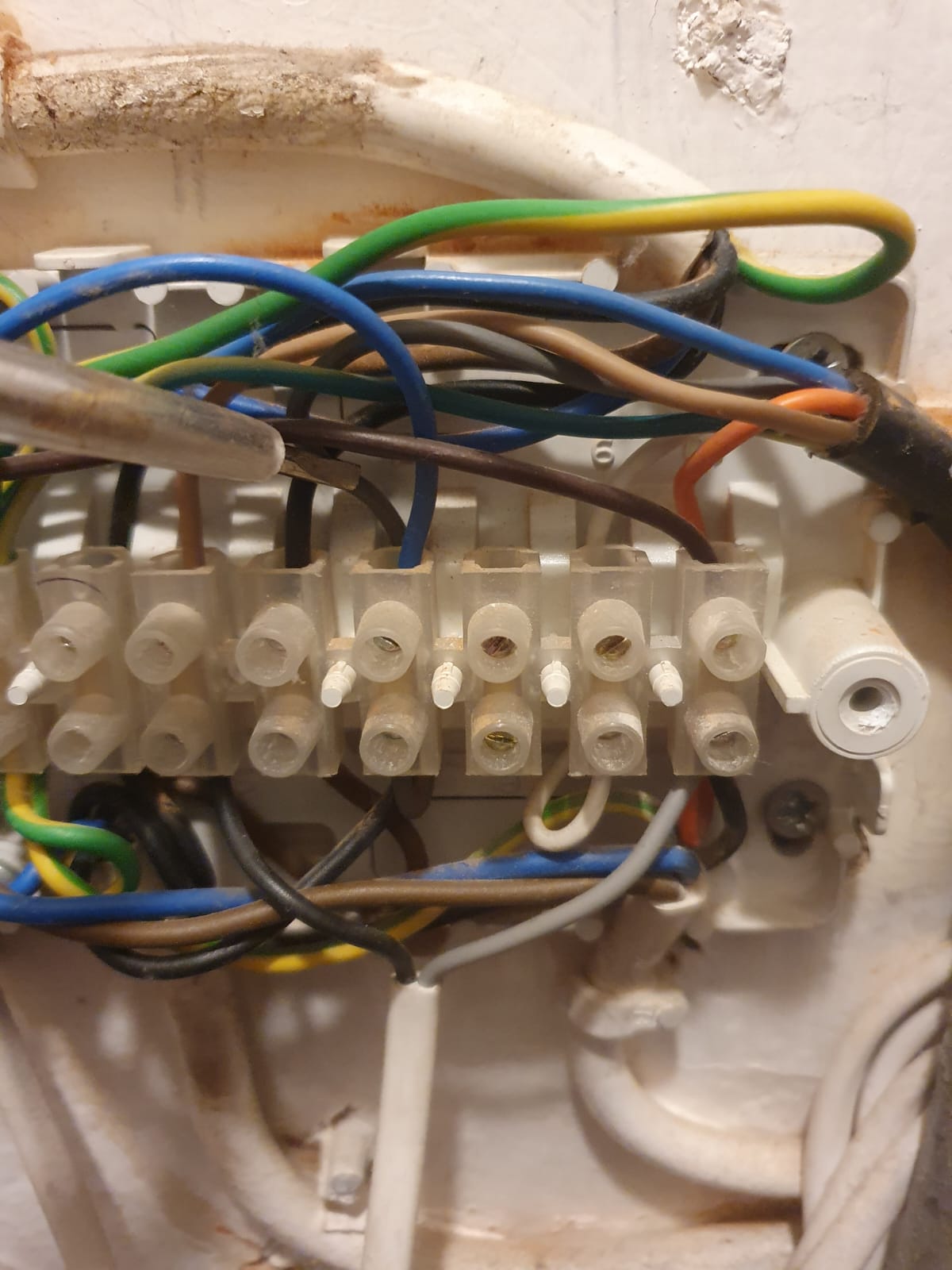

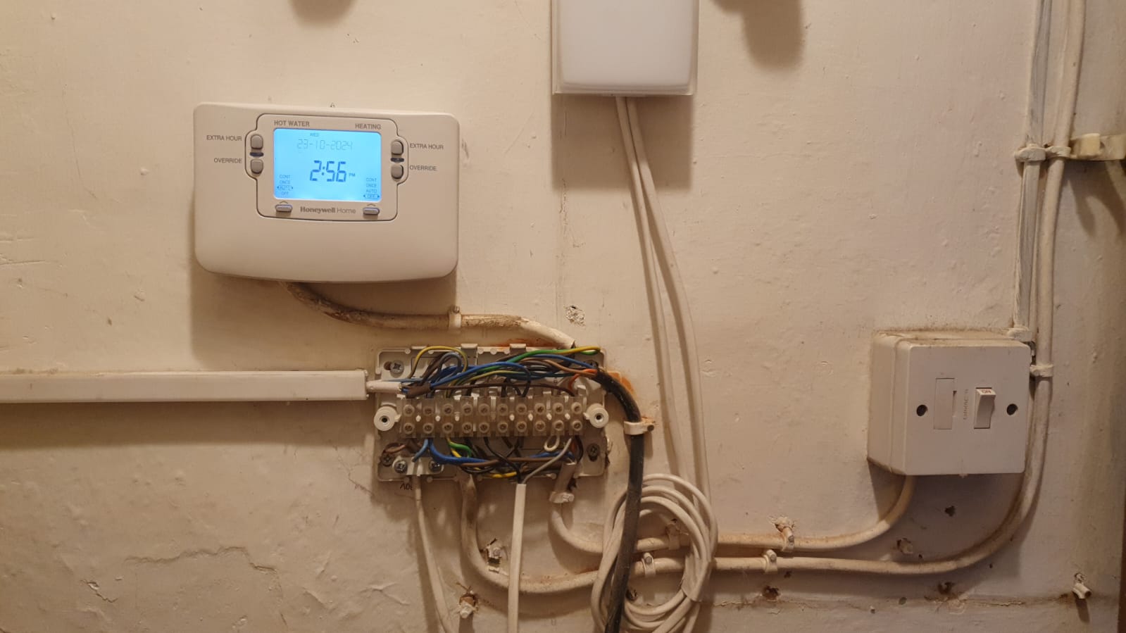

Sorry yes my post is probably confusing, the pic is not of full wiring centre, just a close up of the white wire that comes from the valve near the boiler that is faulty. I've attached some more pics.
I'd not realised there is a 2nd valve upstairs by the hot water cylinder, as I've not had to look in detail at our heating system before. One youtube video later and all is clear, it's not a C plan it's an S plan.
The netamo is the same as a nest or hive - just a different brand. https://www.netatmo.com/en-gb
Still not sure if the white wire shown in the pic is wired up to anything/doing anything - which is what this question is about really.
Thank you all for responding and any help on the white wire (see pic posted) and whether I can use the valve head bought without the white wire would be appreciated...its getting colder by the day :oops:

If you have a S-Plan with separate motorised valves for the HW and CH then the white wire is not required. Which is confirmed by it not being connected to anything at the wiring centre.
