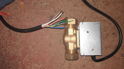

What is the white wire for on a Honeywell zone valve 2 port valve. It makes it 6 core.
Are you sure it's actually a wire and not just a central filler core. Often used with cables having 5 wires to keep them in place.
It is used in conjunction with a C-plan setup, for gravity DHW and pumped CH.
It enables a DHW call for heat to be satisfied without causing the pump to run if there isn't also a demand for CH.

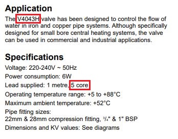

A imagine a replacement might be tricky to find though these days. Most versions of the V4043H don't have the 6th white wire anymore.

If @Fallout doesn't have a C-plan setup but rather S-plan then obviously they can just terminate the white wire safely and tuck it out of the way.
Note that the wiring diagram looks like it isn't quite accurate (or rather detailed enough) with the part numbers and that it looks like it is the V4043H1080 (1") and V4043H1106 (28mm) variations that are the 6-wire versions.
No still readily availabe, as already said safely isolate the white wire if not using
