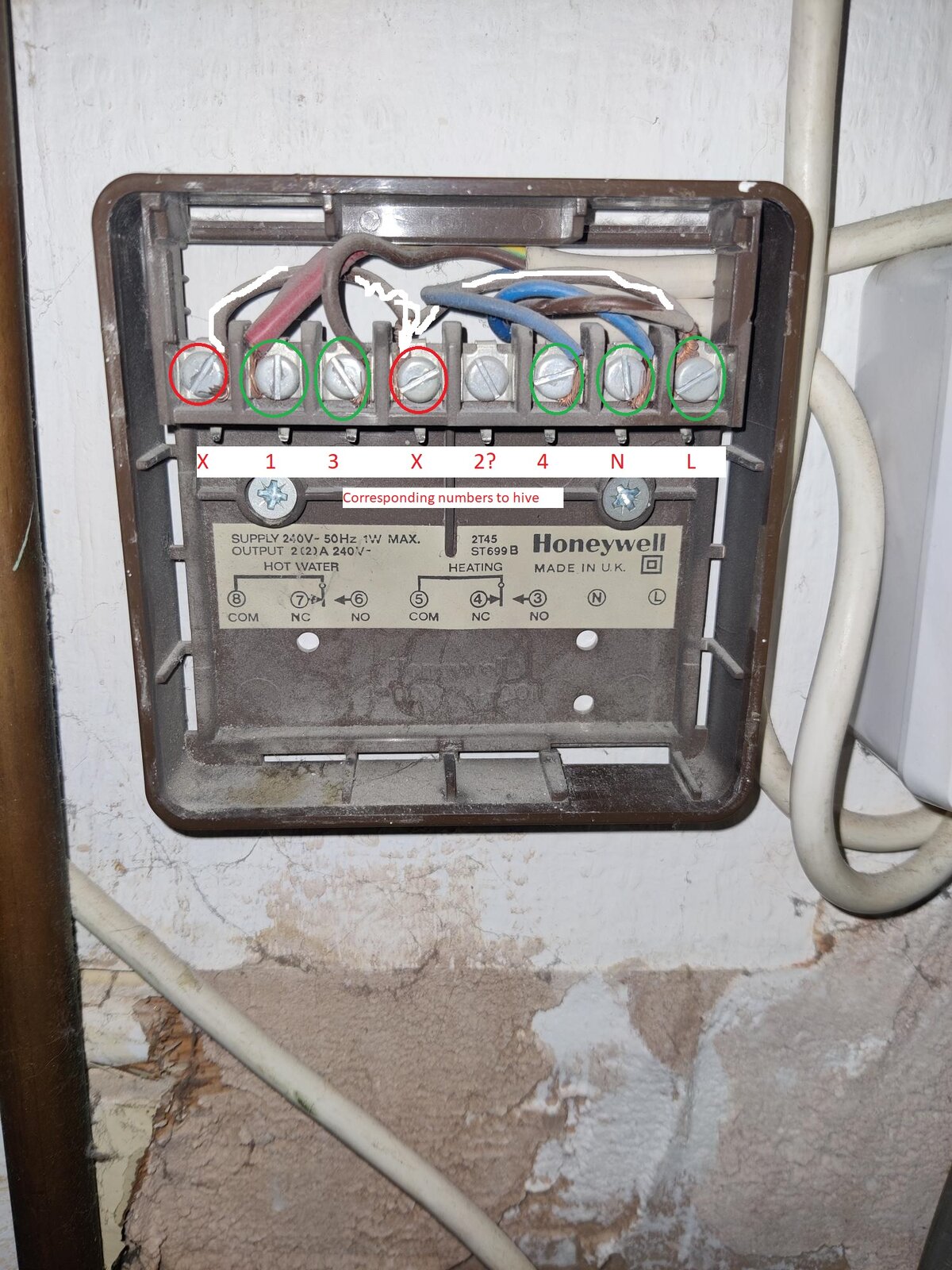

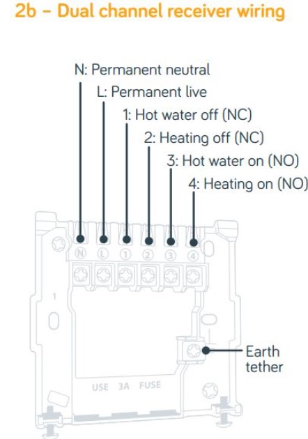

As above, looking to change our Honneywell timer to Hive Active Heating Thermostat V3 Hot Water. The old timer can no longer keep time!!
I've read the instructions and various threads/videos of other installations. I know there are 'live' links from 1 to 5 and 5 to 8 on the Honneywell. When you remove those it is then possible to translate current wiring to the Hive installation guide which I have done in the image.
My only question is what happens to "heating off (NC)", as that's currently 4 on the Honneywell which is blank, so will that be left blank on the Hive?
Our system has a water tank in the loft with a cylinder in the airing cupboard, a heating pump and a motorised valve. This may answer the question as the motorised valve is in place?
