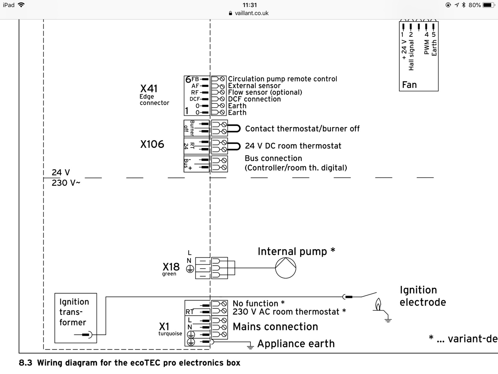

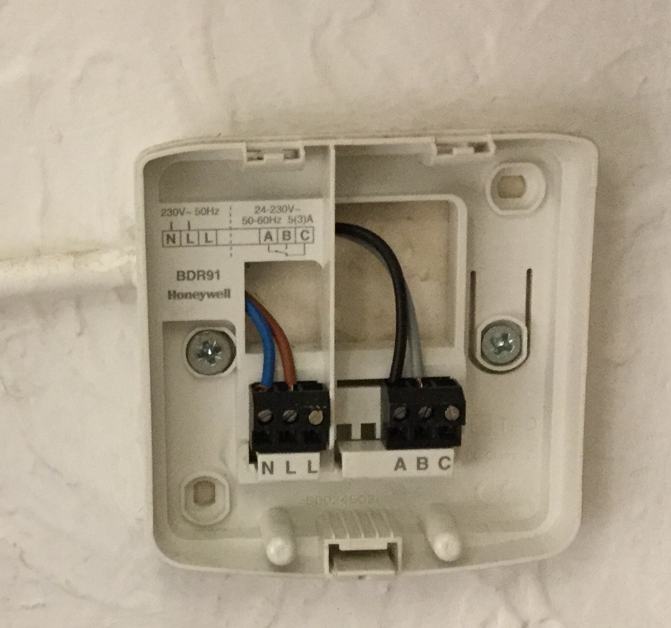

hi everyone,
I need a bit of help.
Current setup:
Vaillant Ecotec pro 28 H Combi A
Honeywell BDR9 thermostat
Required:
Boiler will be same.
I want to change honeywell thermostat to hive. Only problem is I have bought thermostat with dual channel receiver. I know dual channel is for conventional boiler but I have some idea from searching internet that it can be used for combi too. Please help with wiring.
Thanks in advance.
Return it and buy the single channel version.
It will connect to the same thermostat wiring you have now.

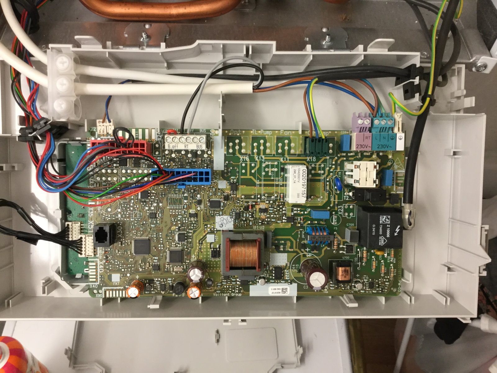

If you connect the dual channel Hive to the existing wiring, the boiler PCB will be destroyed.
That boiler can do mains voltage thermostats, but that requires modification of the wiring at the boiler.
Given the questions you are asking, this is not something you should attempt yourself, as mistakes mean a destroyed PCB.
You should not really be opening the case of that boiler anyway.
As above, having opened the casing of the boiler you now need to do the 26.9 checks before you use it again. It's Gas Safe Registered Engineer territory in there.

Thanks for the answers. I thought it to be simple. Will definitely not mess up with PCB.
Will bring single channel and will replace.
A Honeywell T6 Lyric would be a better choice than Hive anyway, so that's two reasons to take it back
Did not open. Took pic long ago when engineer came for service. Btw why one will need checks for only opening the case if isolated.
