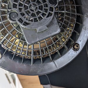

The extractor fan noise at low settings (1, 2) is very noisy. At setting 3, it's not.
I still have the original manual but it doesn't cover much.
Does anyone know if this is an issue with motor or motor housing or the fins around motor?
I've googled to find a way to remove fan fins from around the motor but couldn't find anything - pics attached - suggestions welcome.
Was hoping to remove the fan fins to remove grease and hopefully stop the noise.

It sounds like it is running out of true, due to either worn bearings, or weight of grime.

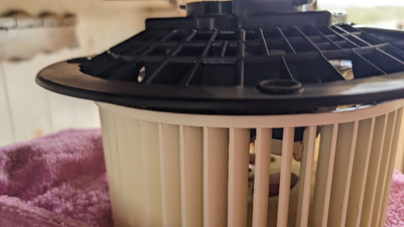

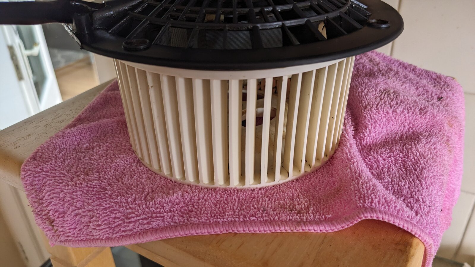

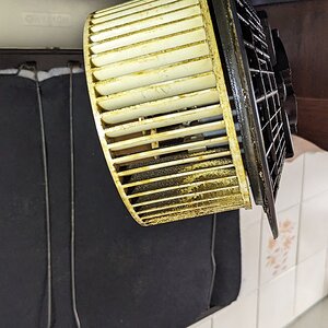

The grease filter(&carbon filter) is in the background of the last photo. I changed that to new filter.
I also just spent a couple of hours degreasing the fan blades but alas the same noise remains.

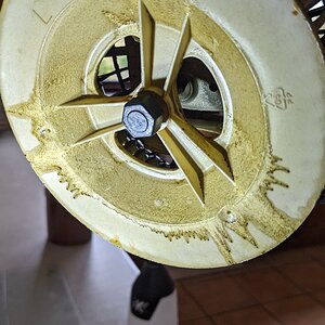

I'm not sure if I take the impeller off that I can reattach it after. Couldn't find anything online about this particular type of impeller + motor setup but if you look at the first photo in the first post - you'll see a locking nut type thing. I don't know how to separate the impeller from the motor safely?

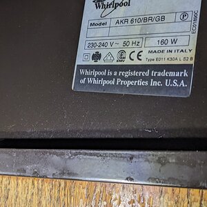

Hard to see motor model number through fins but it has printed on it:
SICO Italy K30RC001, TP 3v 120 watts, CLF07-98.
The hood model number is AKR 610/BR/GB
Type E011 K30A L S2 B

Sorry the MP3 won't play either, but if you want to have any chance of improving things the impeller is going to have come off. If you have had difficulty trying to undo the nut it may be because it is a left handed thread so try clockwise as well as anti clockwise. It's a grip nut meaning that it clamps to the shaft rather than the shaft being threaded. Having looked again at your pics, the bearing on the other end of the shaft also needs cleaning and lubricating. I hope you can resolve the problem because like you I could not find an exact replacement for your model. You would need to contact Whirlpool for advice if you need a new motor.
