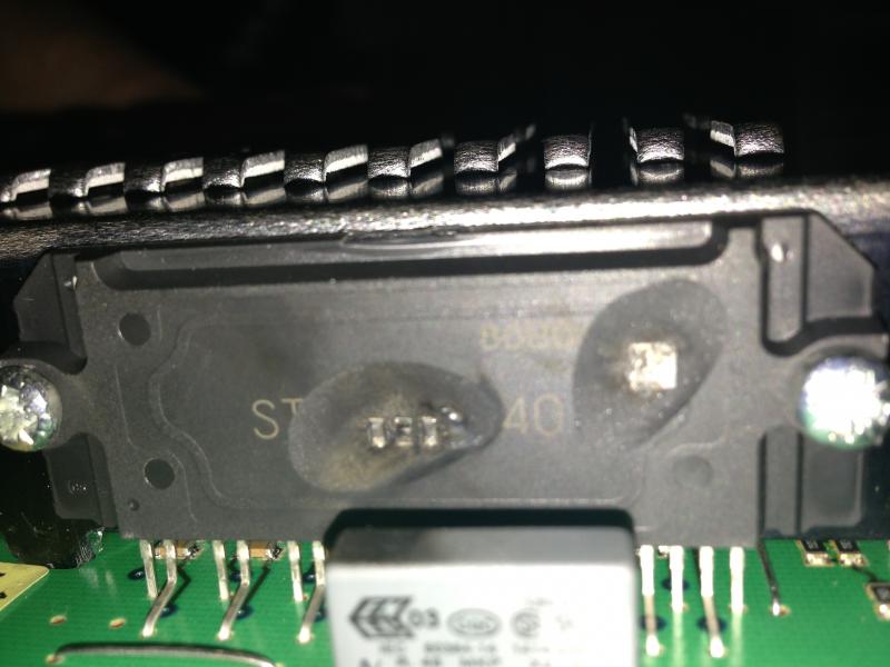

So this time I stayed with it, and shortly after beginning a cycle, I looked like it was struggling to turn the drum! Then to my surprise BANG! (And the dirt is gone! or not in this case!) There was a loud electrically sounding pop/bang from within, and the LCD started flickering the display.

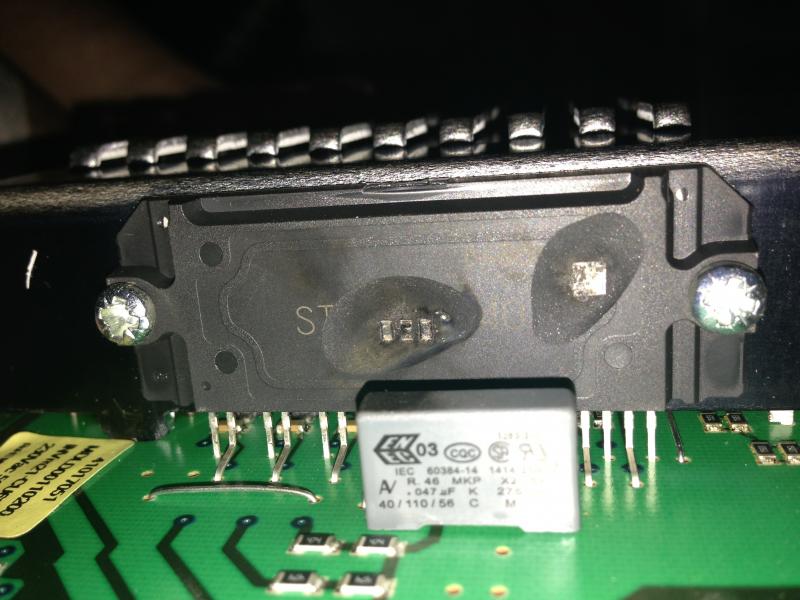

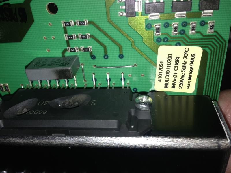

After pulling it apart, I can see that the black large chip with the heatsink, on the controller board has two blow holes on it, also the little 6a fuse had popped...I'm upset because the controller boards seem to range £200-300!!!

That looks like a pretty terminal failure. The question is what caused it to pop and will it happen again if you simply replace the board (expensive way to find out if you just put a new board in!).
Post the numbers off the heat-sinked MOSFET/TRIAC. This part may cost 10x less than the controller but you may need a soldering station and solder wick to remove it.
How much for a new machine? How old is the current one? If you are going to gamble this much you should know how the dice are loaded. :D
Another option is that you go to almost any electronic repair shop and have them bid on replacing the damaged component with one of equal or better specifications.
