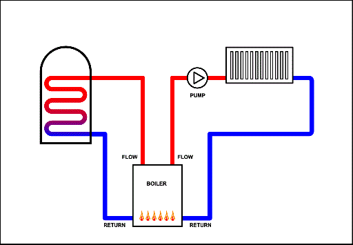

Hi ianmcd, I have a cold water tank in the loft that feeds the hot water system, doesn't that mean I have a Gravity fed system? But I'm very willing to try setting it to fully pumped if it will make it work!
If you have a pump and a three way valve OR a pump and two valves then your system is fully pumped. Some older systems the HW side was gravity circulation (nothing to do with gravity fed) and you could not have separate CH times hence the option on the timer.
There is often confusion about what the term 'gravity' actually means when it comes to heating systems.
Gravity circulation is where water circulates around a circuit without a pump, using the principle that hot water rises as it is less dense and cooler water falls by the affect of gravity as it is heavier. This is the description of 'gravity' that would effect the setting of the programmer i.e. it's not 'fully pumped' system, it only has pumped central heating with gravity circulation of hot water around the hot water cylinder as per the diagram below.
PUMPED CENTRAL HEATING WITH GRAVITY CIRCULATION OF HOT WATER
Gravity fed describes a system that is filled with water from a storage tank (usually in the loft) and has nothing to do with how the programmer is configured. Gravity fed systems can be and frequently are fully pumped in that the hot water circuit and heating are both pumped.
Dear all, many thanks for explaining that to me, I had no idea! I definitely have a 3 way motorised valve (Drayton, I think), and definitely have a pump next to it, so I will change the setting on the back of the programmer and try again! I will let you know how I go.
Sorry for the late reply - thanks Stem and inamcd, it's working perfectly, now that I changed the setting to fully pumped!
