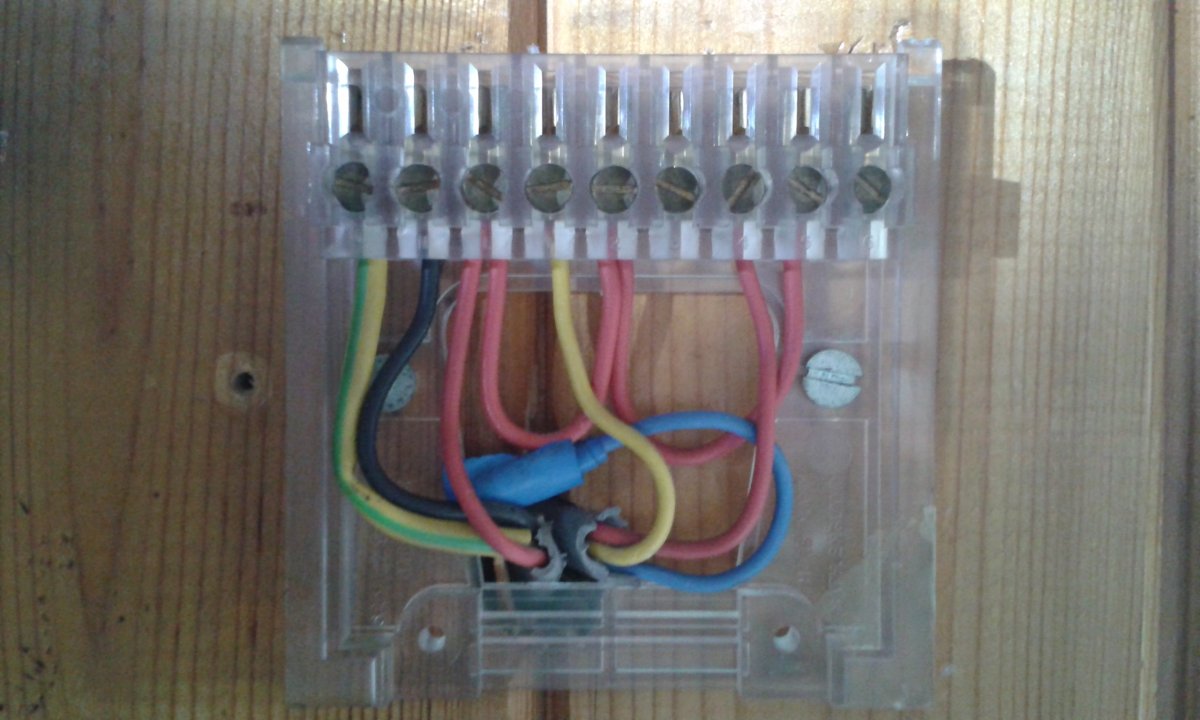

Hi guys, here's the back plate image, are you able to advise further from here. Thanks.
Where does the power cable connected to the left hand three terminals come from? Is it plugged in somewhere or hard wired into a fused outlet?
A check of any fuses in that circuit should be the first thing. Also with all the power safely off, check that those 3 wires in the picture are securely held in place by their screws above.

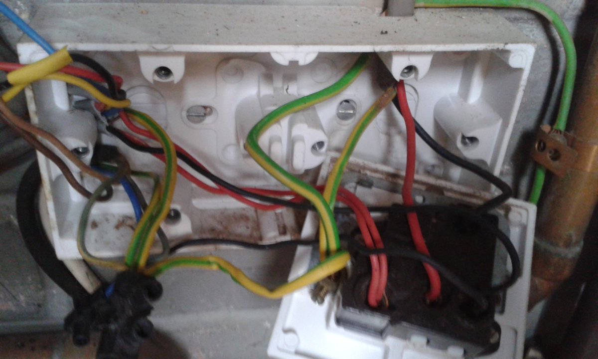

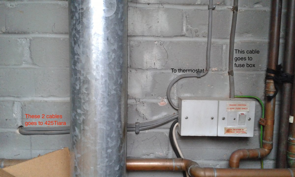

The left hand 3 terminals come from a switch box as shown in the image below.
With power turned OFF first, can you post a picture of the inside of the left hand wiring box?
I'd particularly like to see the neutral connections in there.
It is difficult to see the layout.
With the switch turned off...
I would want to first check that the black wire (2nd from the left on the Horstmann backplate) is securely connected inside the Horstmann tiara backplate.
Then trace the other end of that black wire in the white connecting box to make sure it has a good connection to the Neutral cable coming from the fused switch box, which also is likely black.
OK I think that's as far as you can go with a visual inspection.
Since you've gone this far opening up the wiring (hopefully with the relevant circuit breaker turned off or fuse holder removed at the consumer unit!) I would suggest you invest in a multimeter (~£10 or so), or get someone in to check that power is getting to the Horstmann backbox contacts.
