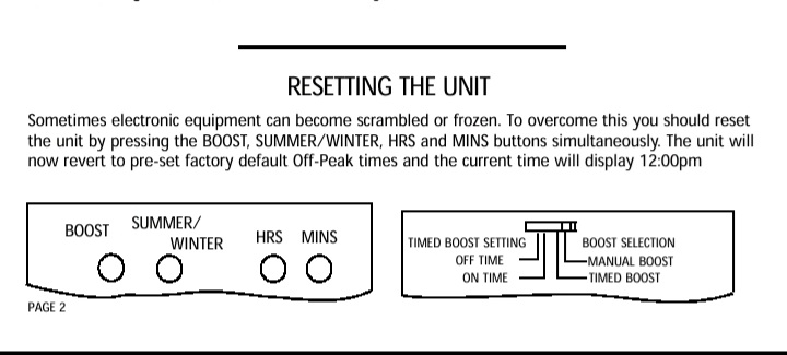

Started having an issue after the electric tripped where the timer is always on and the display has frozen. I've read the newer model can be reset with pressing all the buttons but this doesn't seem to work. Turning off the circuit hasn't worked either. Could this model be upgraded and would it fix the issue?
As you say, from the manual, you should be able to reset from the button presses...
Although it doesn't mention it, the diagram does show the slide switch in the manual boost position, may not make any difference, but could be worth a try!
Other than that, the programming is backed up by a battery on the PCB. If you have any competence in electronics, this can be desoldered/disconnected to 'hard reset' the device (take it off the wall, and completely remove it from the supply, before attempting disassembly!).
Thanks, I have a manual but it doesn't mention this reset so not sure if it's a slightly different model. I set the switch to the one hour boost on the far right and pressed the buttons but still no change.

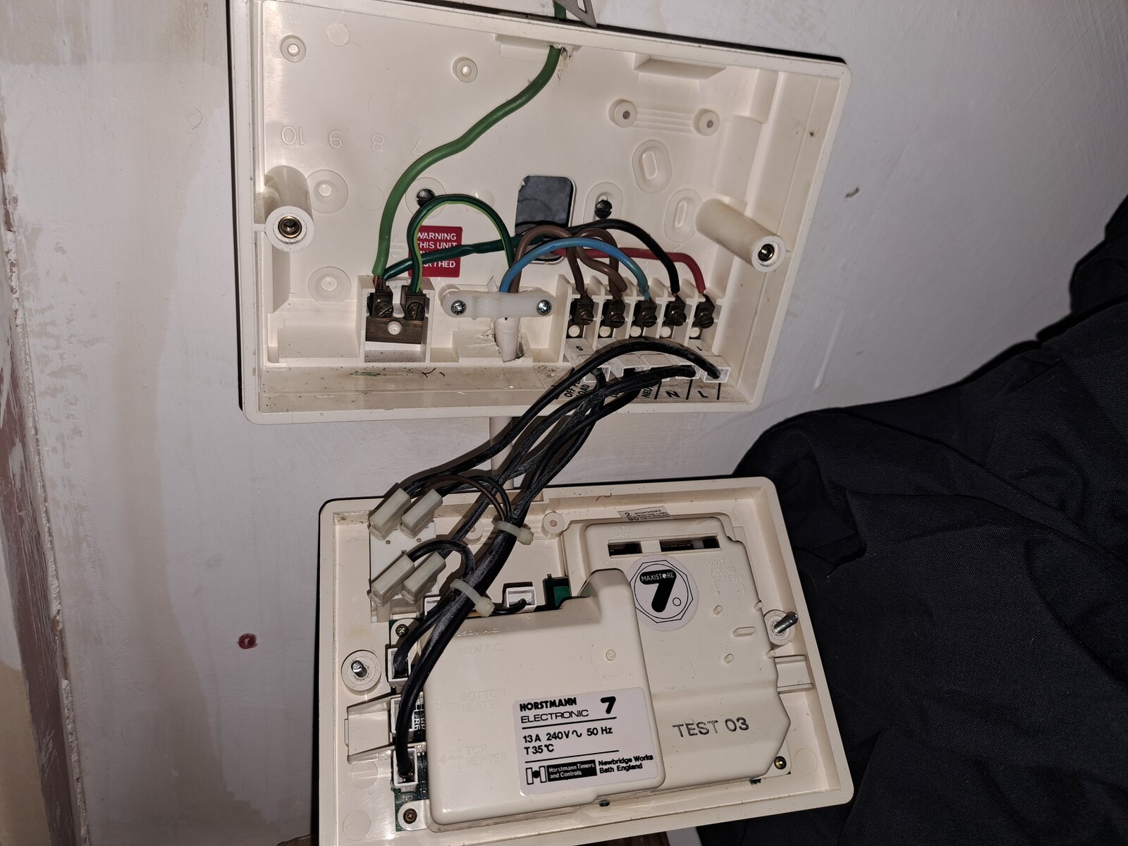

I suppose a basic timer could do the trick. It's no longer an economy 7 tariff but would rather it only on part of the day. Would you need to see the entire unit off? Here's it without the face plate.

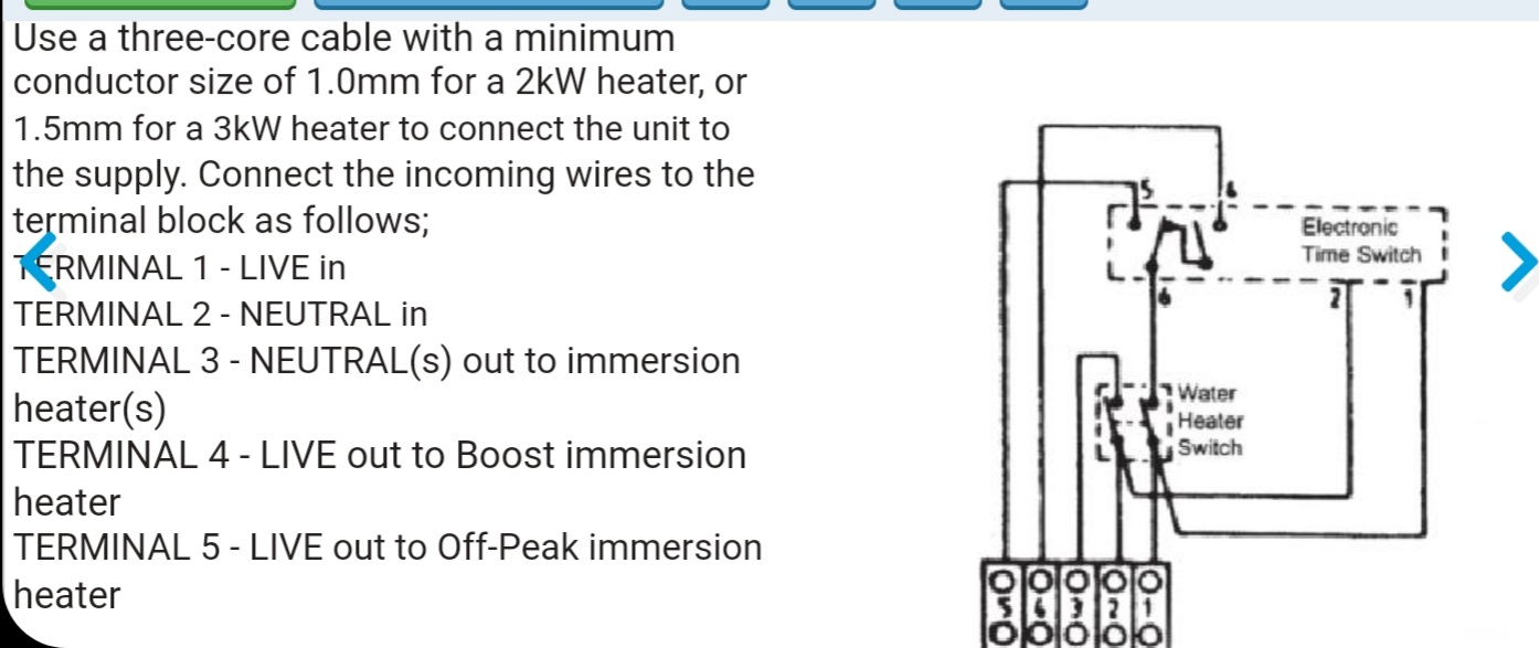

Ok, so excluding the earth connection, it's a simple two wires in and two wires out.
L on terminal 1, N on 2, N out on 3 and L out on 5.
Terminal 4 would be a connection to a boost immersion, or can be linked to terminal 5, to offer the boost function on a single immersion cylinder.
Your options depend on the functionality you desire and what you want to spend.
The most straightforward, but pricier option, is to replace with another Horstmann, as in the previous link - this has the benefit of a straight swap, using the original backplate, and the option to use a boost (dual) immersion (as you mentioned earlier).
