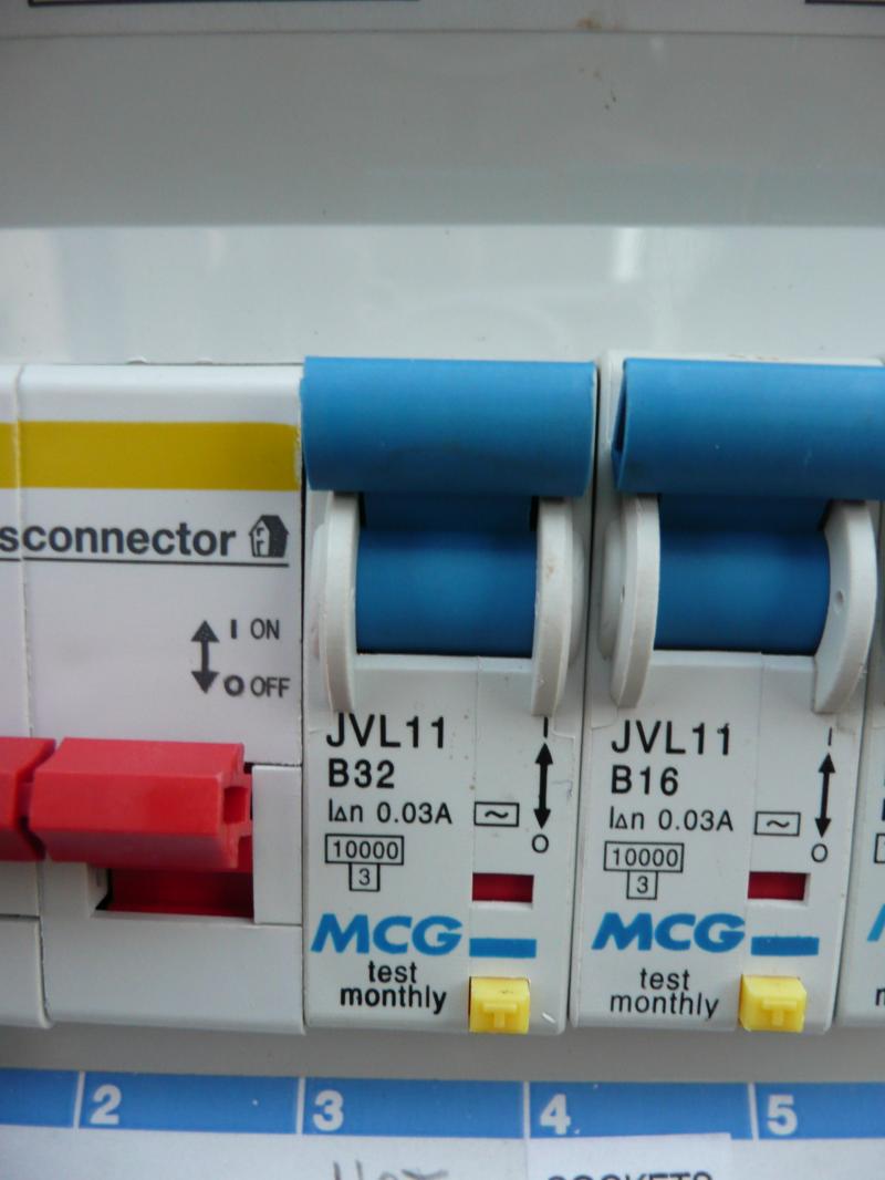

Are you absolutley sure the thing that trips is an MCB?
Perhaps it is an RCD or RCBO.
Does it have a test button on it? what is written on it?
Does it say BS61009-1 or BS61008-1??
Post a picture.
The device which is tripping is an RCBO which is an MCB combined with an RCD.
This means the problem could be associated with an earth leakage as opposed to an overcurrent.

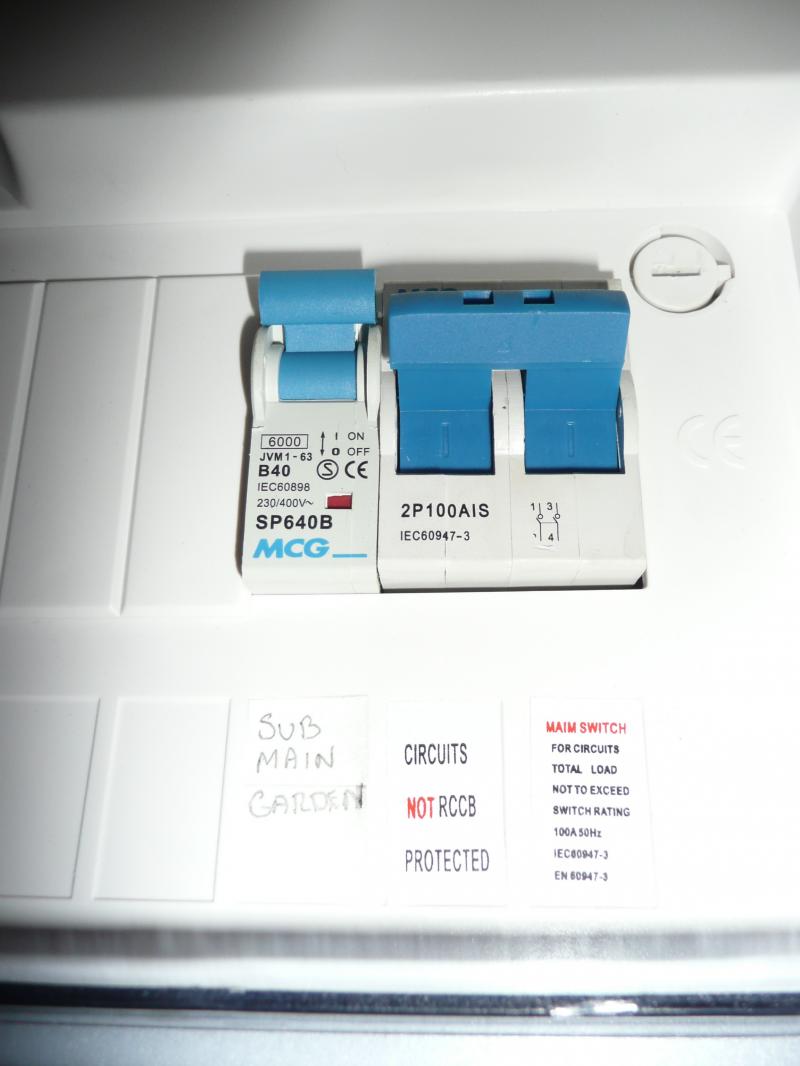

btw whoever installed the main consumer unit needs to look at section 314 of the regs - it doesn't comply having all the lights and sockets on a single RCD.
It wouldn't have been rocket science to put lights on RCBOs on the other side of the board.
Those are RCBOs, not MCBs, and they combine the function of an RCD and MCB into a single unit. Chances are that water/dampness has worked its way into some electrical part in the hot tub, causing an earth fault and the RCBO to trip. Best not to use it at all until you can get it checked over and sorted out.
That device is an RCBO, so the problem is most likely an earth fault within the hot tub. Probably the heating element.

sparky123 how can you say the installation doesn`t comply when you know nothing about the installation, at least ask questions before slagging off someone elses work....how do you know it doesn`t comply?????
Do you think that complies with section 314 of the regs sparkysm?
Hi Spark123,
I had a word with my electrician regarding your comments about the new consumer unit.
I won't print everything he said, as there could be children reading this. But his main point was the each of the curcuits is protected by an RCBO and this meets all relevant regs.
Hi Spark123,
Sorry, but your electrician seems to be talking bull, as the main fuse box picture does not show ANY RCBOs at all. It's a split load board with a single RCD and main switch, and there is almost no way to install one of these (without RCBOs) and have a compliant installation since the 17th edition of BS7671 came into force.
