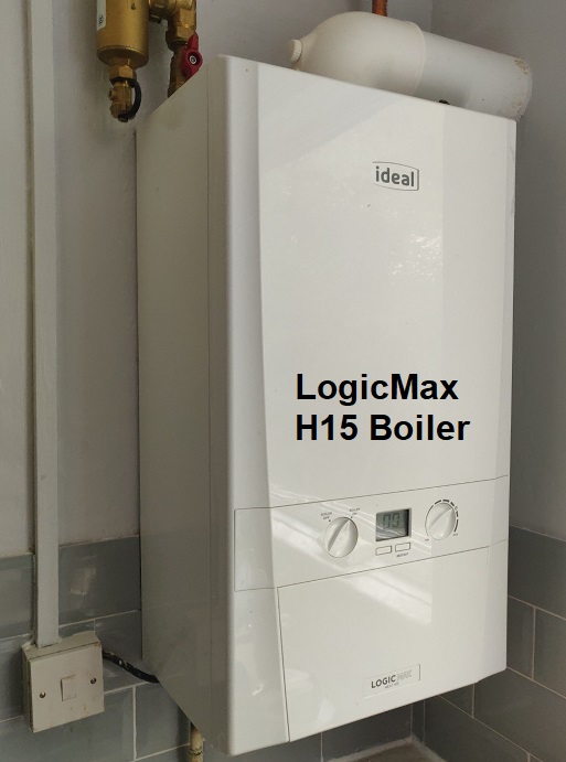

We got a new condensing boiler installed about a year ago. It is a LogiMax H15. When I turn the heating knob (hehe) on the boiler unit then a radiator symbol comes on screen, flashes a few times and goes away again.
We have hot water generated by this boiler but no heating. All the radiators have been bled and are full.
The panel thing in the airing cupboard appears to work as the hot water can be turned off and on there. The heating also can be.
We have a thermostat thing on the wall. It clicks when you turn it up to about 14 degrees. Could this be the problem?.
We also had a brand new bathroom installed last month. This included a new radiator in there. It seems unlikely but could they have turned off something without me realising?
Any thoughts?

Photos and details of your heating controls would help.
Pictures for you - hopefully they're not too big and clunky...
Our boiler- as stated, appears to work fine, produces hot water, has electricity etc...

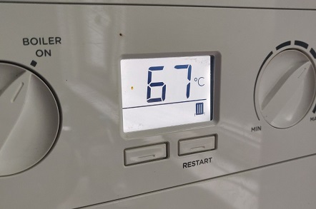

Front of boiler - the radiator symbol here flashes a few times when you play with the dial on the right. The symbol turns off after a few flashes.

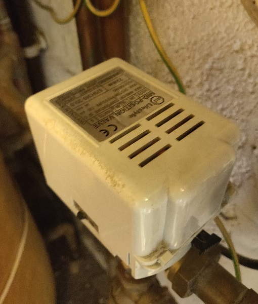

There is a little square thing just at the bottom, not sure what that does

'Little square thing' is a motorised valve, this control where the flow from the boiler goes, into the hot water cylinder, round the radiators or both. If it's not been used all Summer it has possibly jammed in the Hot Water W position. (Indicator on the front should be marked W (hot water), M (Mid position, open to both ports), and H (central heating), see where it's sitting.
If stuck at W, with heating switched on, gently operate the little black lever on the side, (dont force it), this is designed to open it manually to both ports. Check pipe on right hand side on the H port, this feeds the radiators. Does it get hot?
You're a genius, it worked! The lever was only on the W side. I moved it over to the middle and the radiators are now boiling hot!
Thank you to you and everyone who helped with this. I've had a terrible week and a broken boiler/no heating was really not needed. Really appreciate everyone replying.
