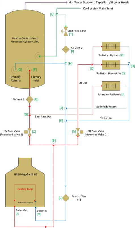

I have surveyed and drawn a detailed schematic view of the current Megaflo system installed:
This system currently suffers from a VERY WEIRD problem: whenever the CH is off, the water in the pipe system stops circulation. Two consequences: 1) no hot water is going to the cylinder, and 2) at the point of shutting down CH, I can always hear a loud BANG in the pipes, suggesting the water flow is stopped.
One would then assume the HW Zone Valve (item [C] in the above graph) might have broken. We suspected the same and replaced the valve [C] TWICE, with different brands and models - none worked.
It is not the wiring of the zone valves either. If you listen carefully you can hear them operating normally when controlled by the programmer or the thermostat. Moreover, when I manually let the HW zone valve stuck at "Open" position, there is still no water flow if the CH zone valve is at "Close". How strange.

We noticed that the INTERNAL automatic bypass is extremely hot on the boiler when HW is on alone; which means all water goes through the very small circulation around the boilder IN/OUT. When CH is turned on, the situation then reverts to normal.
He then tried to install a bypass between after the HW zone valve (section [CD] on the graph) and the cold returns (section [HJ] on the graph). This didn't work either (even when HW Zone Valve [C] is stuck open manually).

sounds like the return from cylinder is piped to the flow and not to a return.can you trace the pipe all the way back to the boiler from the cylinder?
You may have an old non return valve tucked away somewhere out of sight on the hw circuit, sometimes used to stop unwanted circulation in the rad circuit.
Is the pump still running on HW only?
There has to be something stopping that circulation on the HW circs. You will need to physically trace the pipework and see where it goes.

The pipes have poss been crossed over during the pipe modifications you mentioned. You will have to trace the pipes inch by inch between boiler and return on cylinder to confirm no crossing over has occurred. Was the old system gravity hot water and pumped heating? Some older systems I've seen have had the return pumped and not the flow, which can confuse people who presume it's the flow when piping a new cylinder in the airing cupboard.
Yes, the old system was gravity HW and pumped CH. The megaflo installer didn't touch any pipes underneath the floor, but from the surface it looks OK.
but re your last concern, is there a way to identify this without stripping the floor boards? I tried, when turning the CH on, the water flows very quickly from boiler's OUT to the current 2 zone valves . It seems at least the current zone valves are installed on the current flow pipes. But when CH is shut, hey, everything stopped imminently and with a bang.
With ch on dOes the return to boiler get hot.and can u see this return pipe in cylinder cupboard. If so then the return for the cylinder needs to be t'd into that pipe And i see no other reason itwont work. As you have ruled out all other things ie valve direction and pump and zone valve operation. It has to be a pipe issue. Maybe blockage in old pipe. ??
