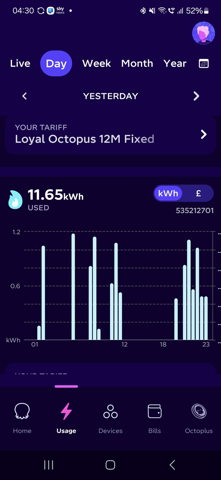

Really hoping you good people can help. My set up is a standard vented HW and CH system. The other evening my HW failed (made known by Daughter moaning how cold the shower was). The cylinder thermostat is a really old Honeywell type so I used a screwdriver to move the dial down to see if it would click in and altho I could hear the switch making and breaking there was still no HW. So used my british gas homecare cover and they identified it as the HW valve (I have separate HW and CH valves). In the meantime I decided to change the temperature switch with a new Honeywell one I had. BG came and changed the old Danfoss HW valve for a new one and system test run OK.
Now here's the drama. Before the valve change I always left my HW on constant. Assuming no one used any HW it would go around 16 hrs before the stat called for more HW and would run for around 3 hours to heat up. What I found with the new stat on the cylinder is it kept clicking in and out every 2 to 3 hours calling for HW, then running for around half hour at a time to top up the temperature. This obviously was a different behaviour pattern to what I was getting with the origonal old stat and it seemed this new one was too sensitive. I changed the stat back to the old one as that was proven to work and it now (again with no one using the HW) there is a gap of only 9 hours between when it calls for heat then it runs for around 4 hours to heat up. So a much shorter time window between cycles and running longer.
This is all so annoying as had I just left the setting of the original stat where it was I probably would have no issue. I can't remember exactly the setting it was on previously but we always had plenty of HW and it used to run fine. The stat is fixed to the side of the cylinder ok too in the correct position.
Is it possible that I need to drop back the stat temperature setting (currently indicating on the very old dial around 55) to compensate for scale build up as we are in a very hard water area and this tank will be at least 25 years old? Working on the theory it's taking ages for the heat to conduct through to the walls of the cylinder. That's my theory anyway?
Thankfully I have smart meter data from before all this haopened showing consistently what level of gas usage was required to heat the tank and at the moment it is higher than previous. I am thinking if I just tweak down the stat in very small increments each day surely I should get back to where it was before?
Does this all sound feasible? My golden rule though is now not to touch stuff if it ain't bloody broke (like the stat as if I didn't move the front dial around on it I wouldn't be in this mess now but at the time I had to do this to fault find the issue).
Thank you in advance for reading all this.

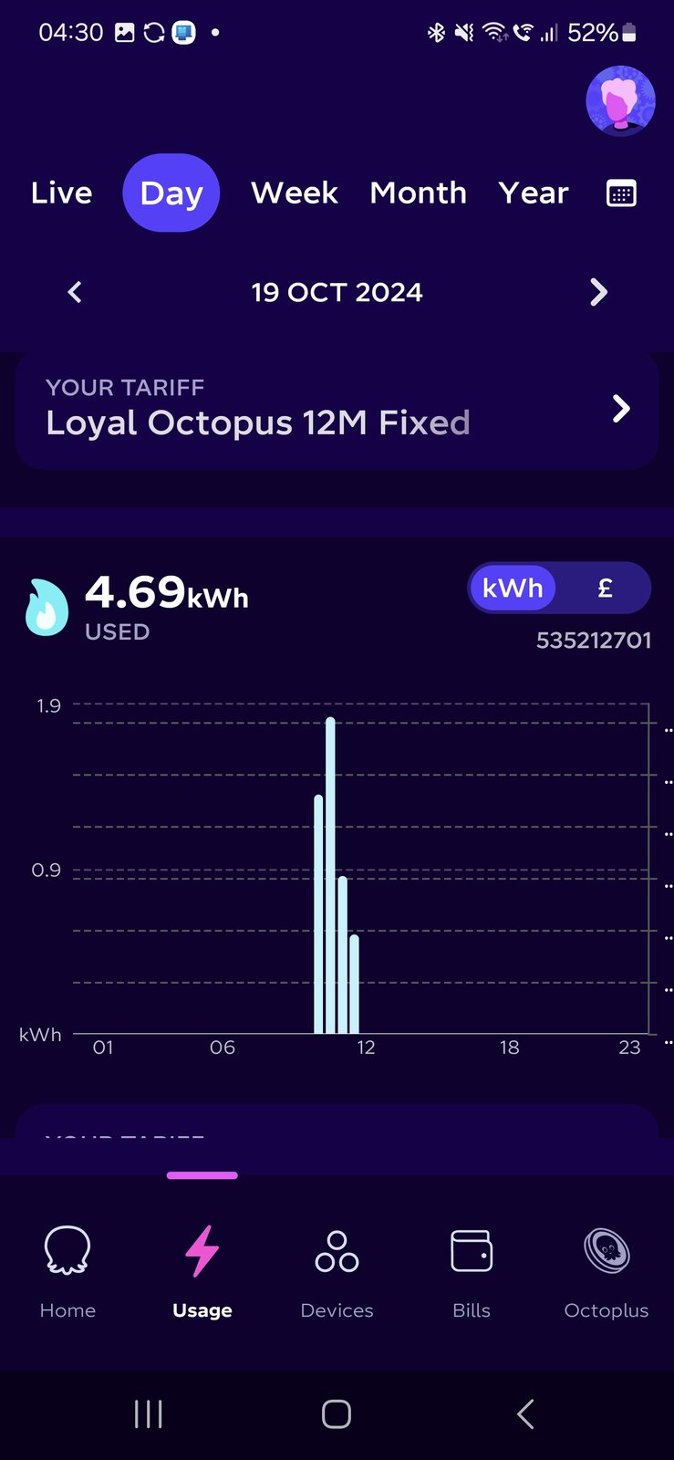

Have attached some smart meter data to demonstrate what I mean.

If it used to run for 3hrs every 16 hrs but it now runs for 4hrs every 9 hrs, where is the additional energy going?

Is that not electrical consumption you are showing?
I hour heating water during the night and max 1 hour in the early evening. Leaving HW on constant is daft to say the least.

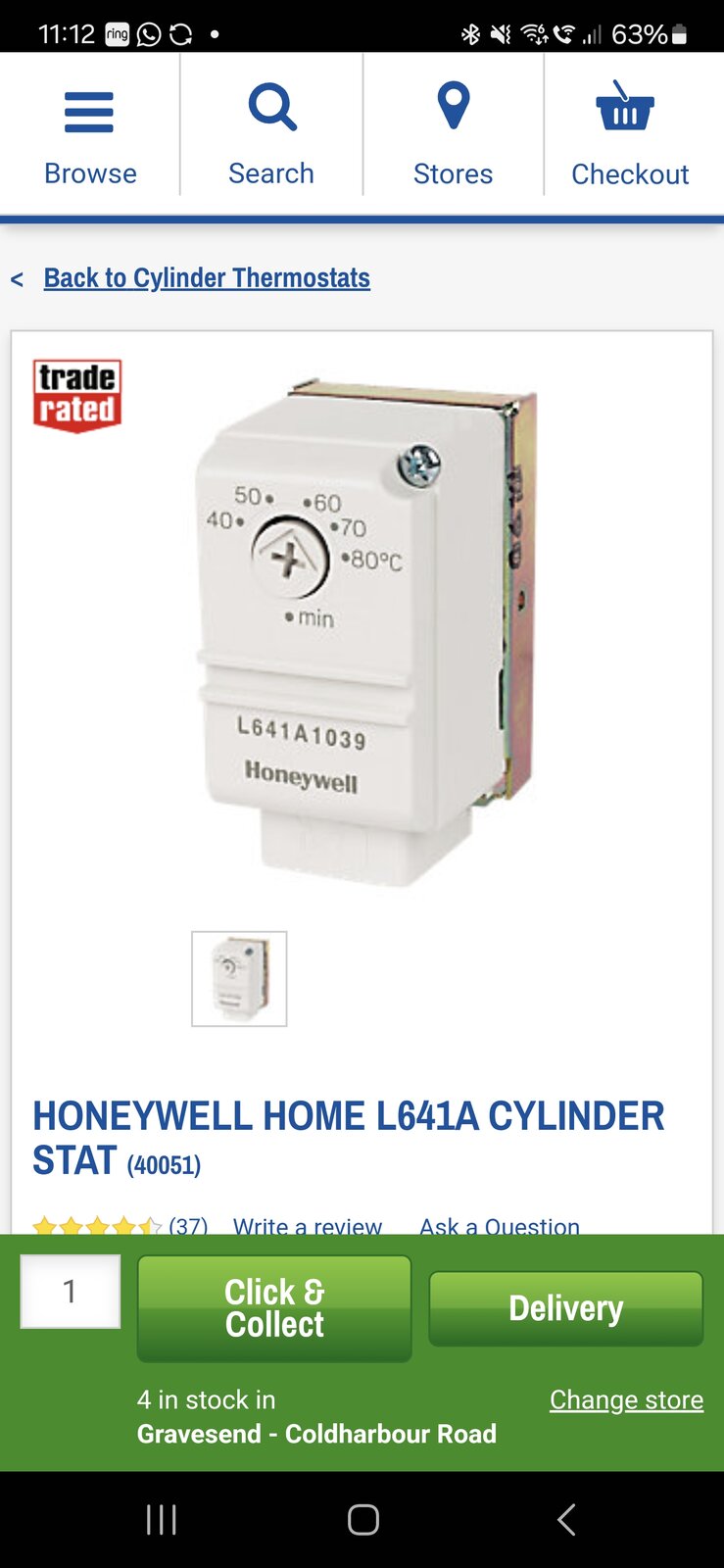

Please show us a photo of the thermostat you speak of.

If the stat has a temperature scale just turn it up and down and note the temperature difference, this is the hysterisis, normally ~8C max of 10C, min of 6C.
Another test you can do to see what the coil is absorbing is to fire the boiler on HW only, ensure its running continuously and not cycling (assuming gas boiler), take a photo of your gas meter and exactly 2 minutes take it again, multiply the difference X 11.0X60/2X0.85 to give the coil input in kw, (assumes a boiler efficiency of 85%), if you have boiler flow&return temps, note them as well.
Thank you for this info. All that has physically changed is the HW valve replaced. I then tinkered with the thermostat setting on the cylinder. I don't appear to have hot water entering the cold water system at least not that I am noticing. Does the stat plate on the back of the sensor physically have to touch the cylinder wall as I notice the plate on the switch won't physically touch the copper just the metal casing of the switch
