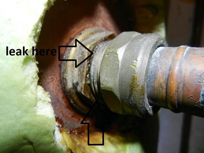

Hi, my indirect vented hot water cylinder has just started leaking slowly (4 drops per minute) from the upper coil connection. I think I bashed the pipe and started it :(
The water is coming out between the threaded pipe and the nut on the tank, as shown by arrows in photo:
What is the likely cause of this leak please? Is it heating circuit water or tap water which is leaking? Will I need a new cylinder or can the connection between coil and cylinder be repaired? Is there any point trying to tighten the nut on the cylinder (I'm guessing this would only turn my slow leak into a fast one!?)
If I have to replace cylinder is there a temporary fix that will last a month or so?
By the way, its possible copper corrosion has occurred in the past - we have private (borehole) water which is acidic, we installed a filter to correct the pH when we moved in 7 years ago (pH is 7 now, I just checked it), but the cylinder is older than that.
Thanks for some advice, Phil.
It looks like being tank water.
Tightening the nut may cause a worse leak.
There was a recent thread which gave all the details of how to try repairing . But that's tricky and not what I would ever recommend to a Diyer.
A replacement tank will be the sure solution. But you could try a repair or call a plumber to try for you.

Drain heatin and drain cylinder undo the nut and re washer it using a fibre pump washer that will do it
Thanks for suggestion gas112 but I really don't want to have an emergency cylinder change on my hands if I have problems with the fix. I'm a DIYer so I need plenty of planning and shopping time...
Also the cylinder I have is oversized - its a 170lt, I don't see the point of storing more than 100lt when its so quick to heat more.
So I think I'll get a new steel tank, probably a Screwfix Aquastel one. I've read steel is more corrosion resistant and we potentially have acid water (if the filtration is less than perfect).
In the meantime I've hopefully fixed the leak temporarily with B&Q Epoxy Putty for Metal. Just by closing the cold feed valve and opening a hot tap, I stopped the drip. Then I cleaned up the cylinder nut and thread with steel wool and white spirit. Stuck the putty all over the nut and left it a few hours. Cold feed back on now and no drips. Hopefully that will hold it for a little while.

Good news is the epoxy putty has fixed the leak. This is good stuff.
