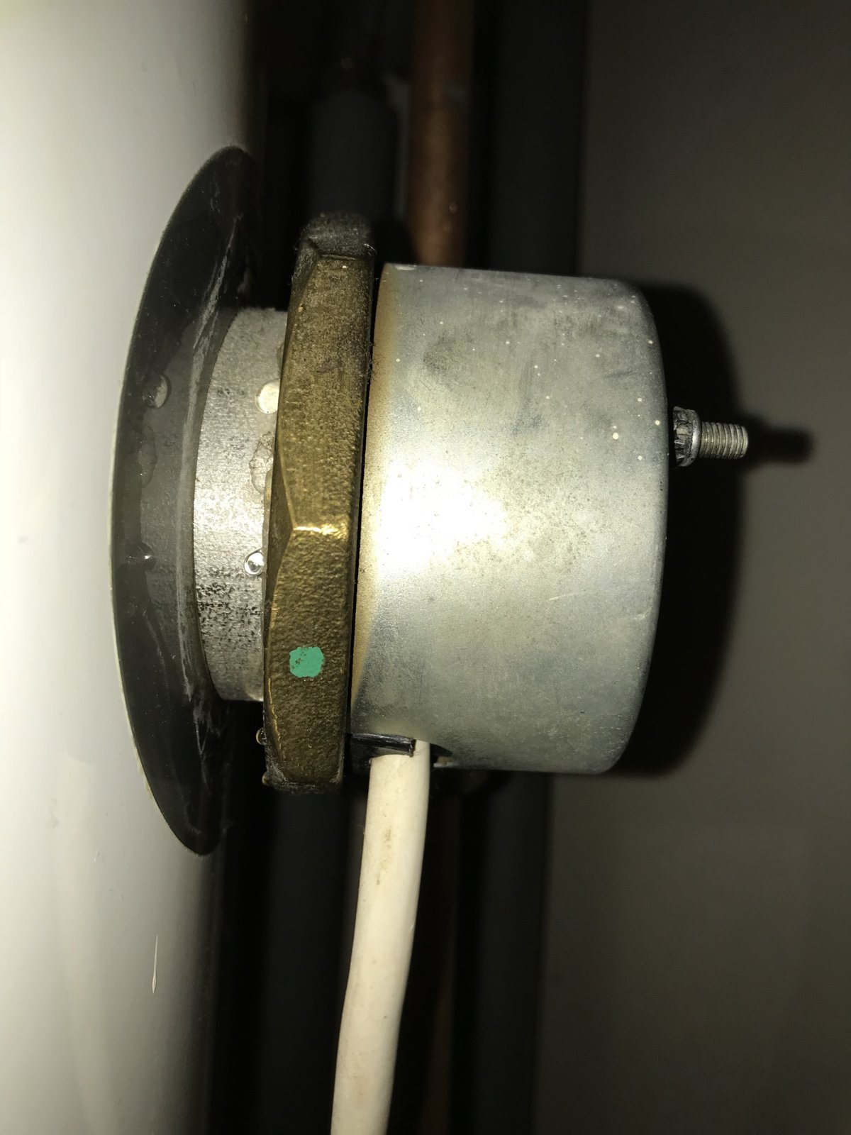

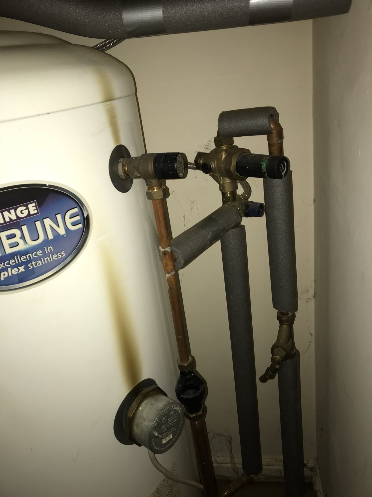

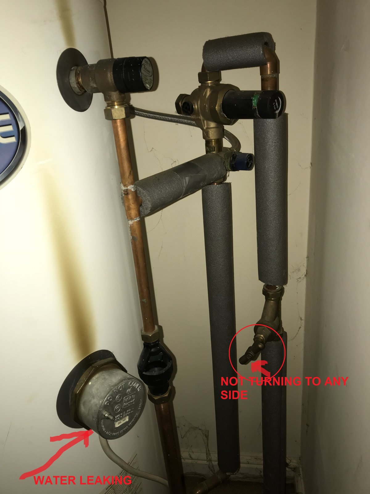

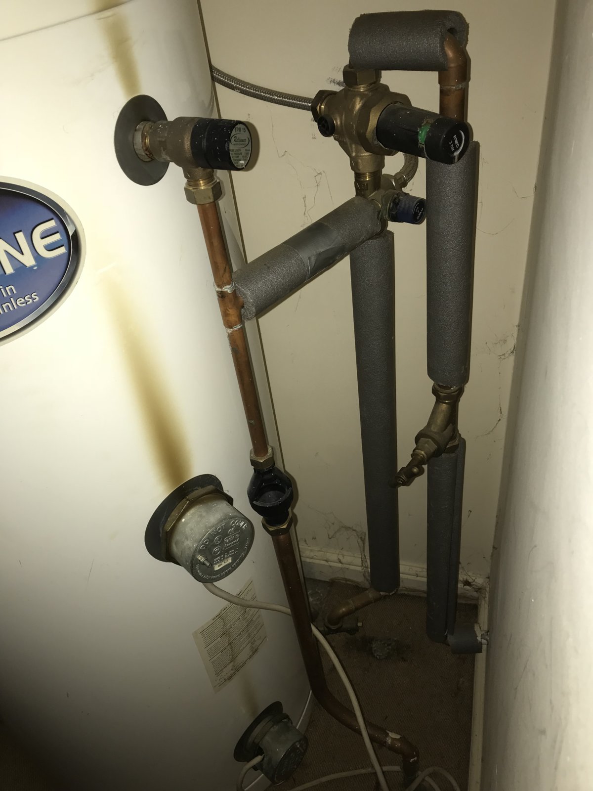

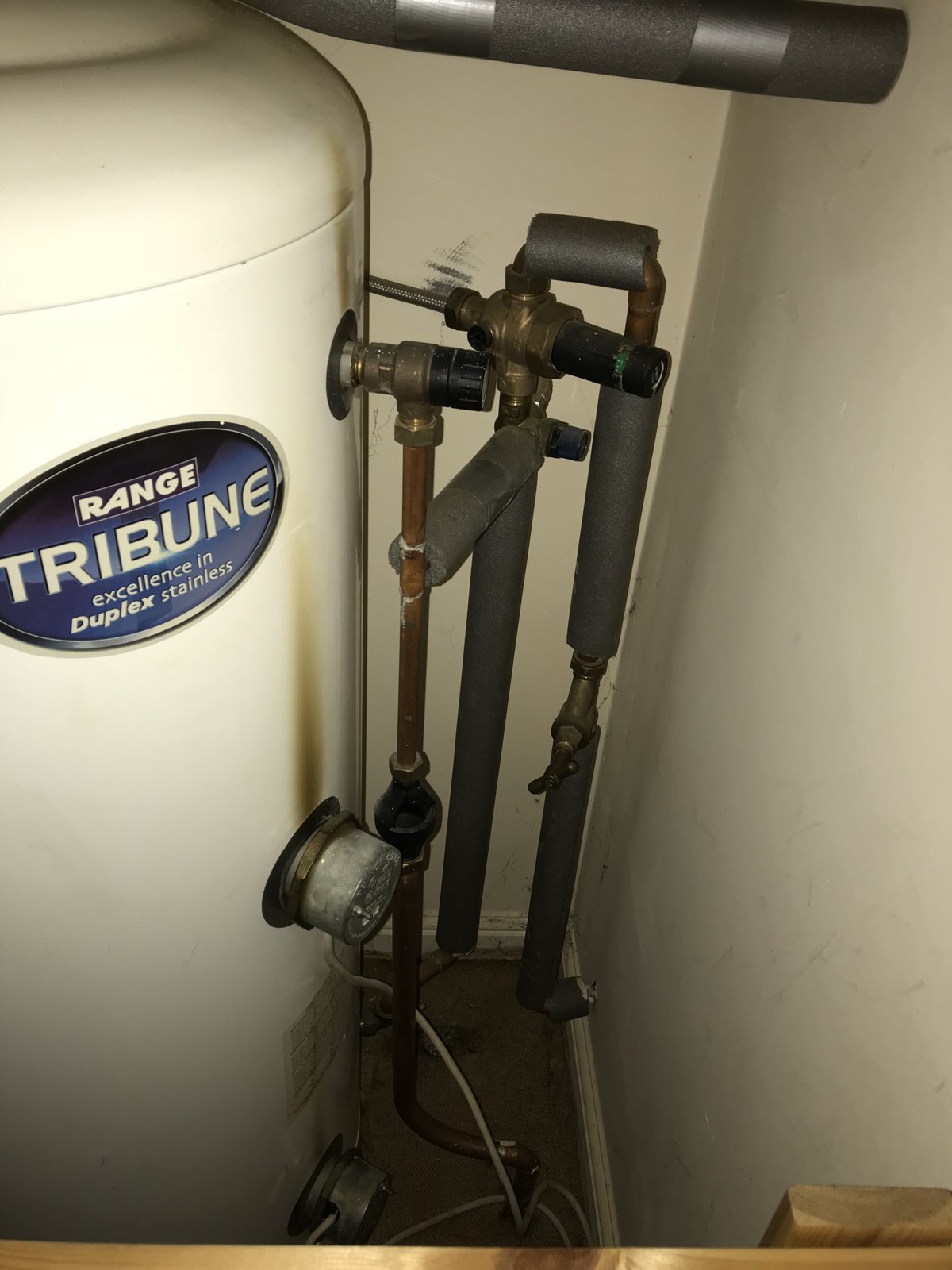

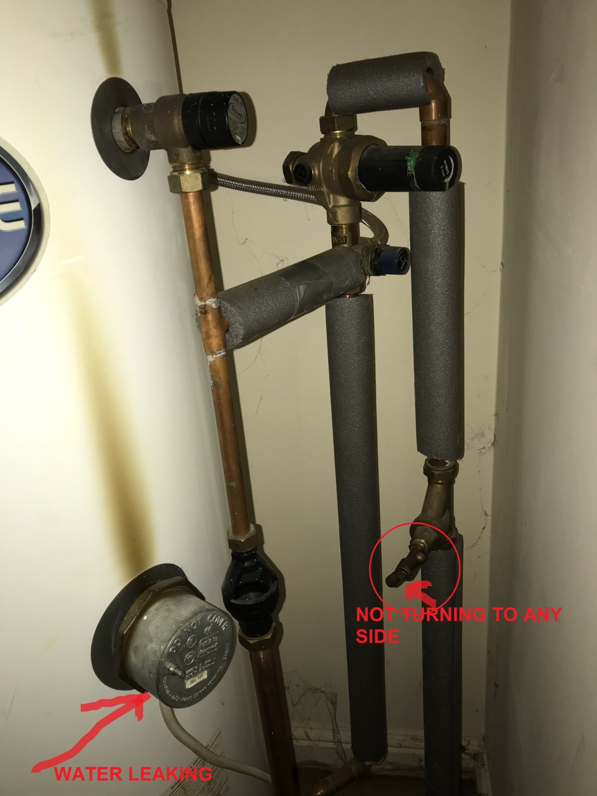

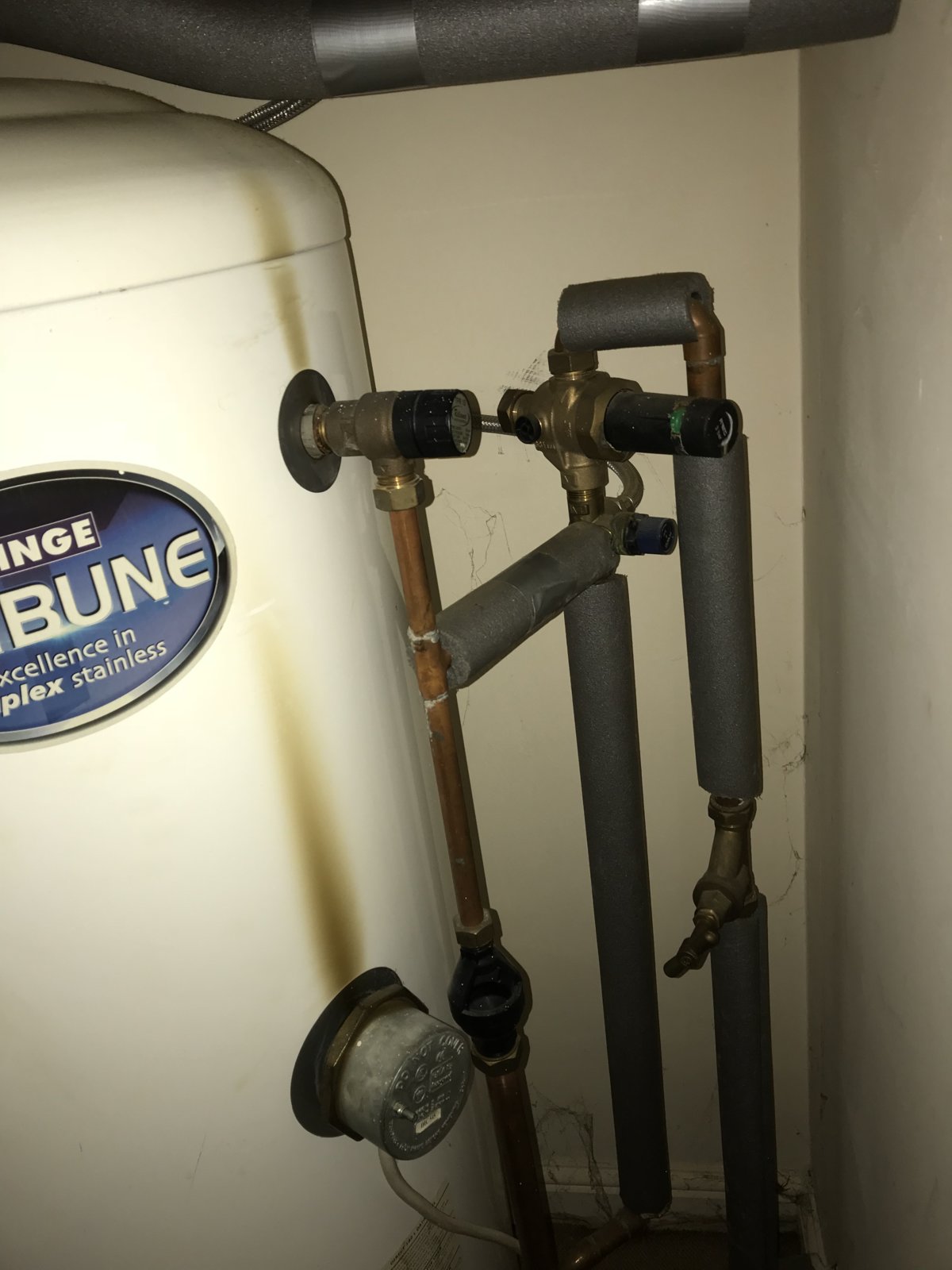

I live in a rented flat, moved in few months ago. Unable to contact my landlord - the phone is turned off. From the first day I've noticed very low hot water pressure to taps and shower compared to cold water. I guess my own fault for not paying too much attention to this problem. A month ago my father passed away and I had to go back to my home country for his funeral and sorting out legal matters. And now when I came back here yesterday, after switching on the water cylinder, I noticed that there's basically no hot water coming out from any hot water taps in this property anymore just from cold water taps. So today in the morning I had no choice just to disassemble a wooden shelf hiding the hot water cylinder. After closer inspection for my horror I noticed that water is leaking in one place. I took some pictures, please, take a look. I'm truly terrified at the moment because my landlord not picking up his phone and for example today, as it's Sunday, I really could not afford to have an emergency plumber coming to check this hot water cylinder. My question is, do I need to turn off the main water supply into the flat, although, I do understand that it won't stop the water cylinder from leaking as it's full of water anyways? Please advice, till I'll get a pro to fix it.

OK, first thing first, shut all the power to that cylinder off. That tap that you say isn't moving will need to be unsiezed. It isn't that old and has probably just locked at full on, it will probably free up with a little persuasion. It needs to be turned to the right (clockwise) and if you use an adjustable spanner across the tap head it may free up with a clunk, try that with the mains water turned off.

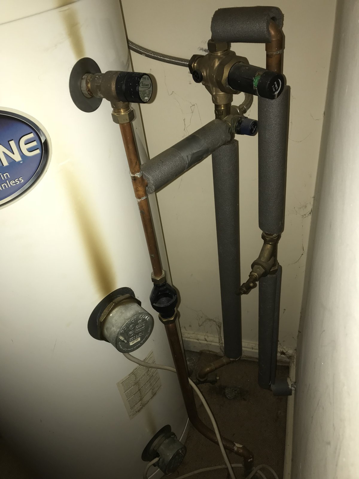

2nd is once that's shut off then there is a drain tap at the pipe running into the bottom of the cylinder which will allow the cylinder to be drained (pic 2 you'll nsee a little valve sticking out of the pipe with a square end and an outlet. You need to get some hose onto that and then loosen the square top on the tap (not all the way out) and the water will start to drain out through the hose till it's below the level of the immersion element.

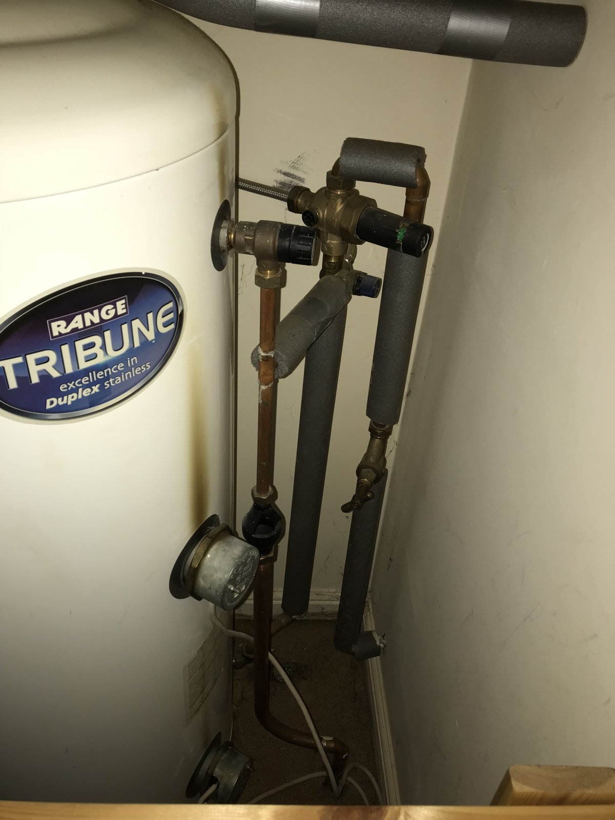

This all needs looked at urgently, that is an unvented hw cylinder and has the potential to be pretty dangerous and the scorch marks on the cylinder aren't a good sign either. Make sure that when it is being looked at that the engineer is suitably qualified. He must hold a G3/UVHW certificate and card that he must be able to show you. If you can't get your landlord repeatedly then I believe you can legally get someone in and then get them to bill him but check that on Monday.
1. As Madrab says, that is an unvented hot water cylinder and only a suitably qualified person can work on it. As he also says, turn off the power to the upper and lower immersion heaters.

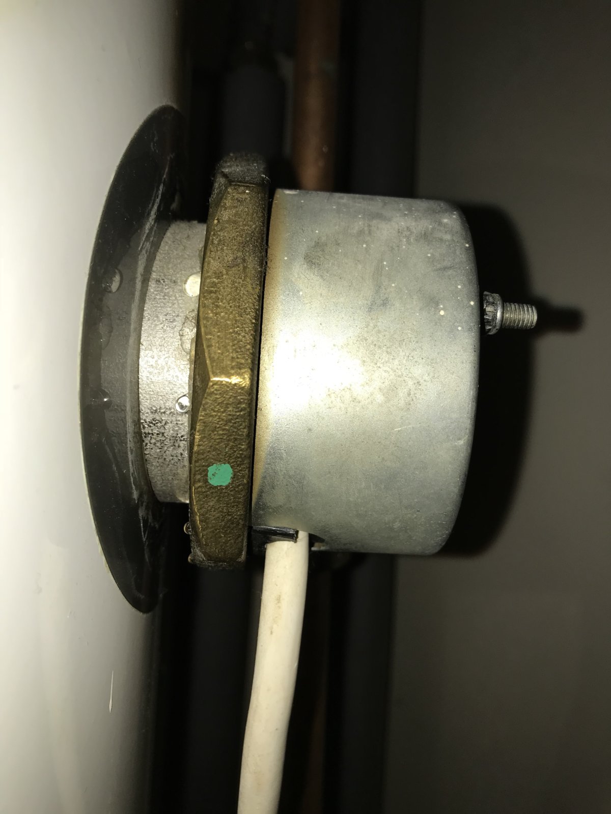

2. Are you sure that the leak is coming from where you have shown an arrow to it. It could be coming from the open black plastic device (called a tun dish) next to the immersion, and dripping onto the immersion cover. That might also explain the low pressure of your hot water prior to discovering the leak.
3. Those cylinders should be serviced annually. Its not a legal requirement, like a gas safety certificate, but a responsible landlord would have it done.
4. You really need the landlord or his agents (if any) to get the work done quickly. I for one would not do work which was to be billed to someone else without that someone's prior agreement. You pay have to pay for the work to be done and claim back from the landlord.
I turned off the power yesterday in the late evening even without seeing a water cylinder. As I mentioned before, I had basically no water at all coming out of hot water taps, so I just felt instantly that there must be a real big problem with a water cylinder.
The tundish is completely dry. Not a single drop of water inside of it. And yes, I'm totally sure that water is leaking from that upper immersion point.
The date on the sticker that's located on the cylinder states that the inspection (or service) been done back in 2004... If it's true or not I don't know - I'm here from October 2019. In any case, I have no other option but to get a professional person with G3/UVHW certificate and card. And I'm gonna ring every heating and plumbing engineer in this area first thing tomorrow in order to find one. I need to shower, I need to do my laundry, I need to live normally after all....
BTW, I had to call my neighbor to help me turn the tap by the cylinder. I could not do it myself. Not an excuse but I'm a female so probably not strong enough... Well, anyways, the tap freed up, however, is it normal that we had to turn it clockwise ~ 20 times? That many?

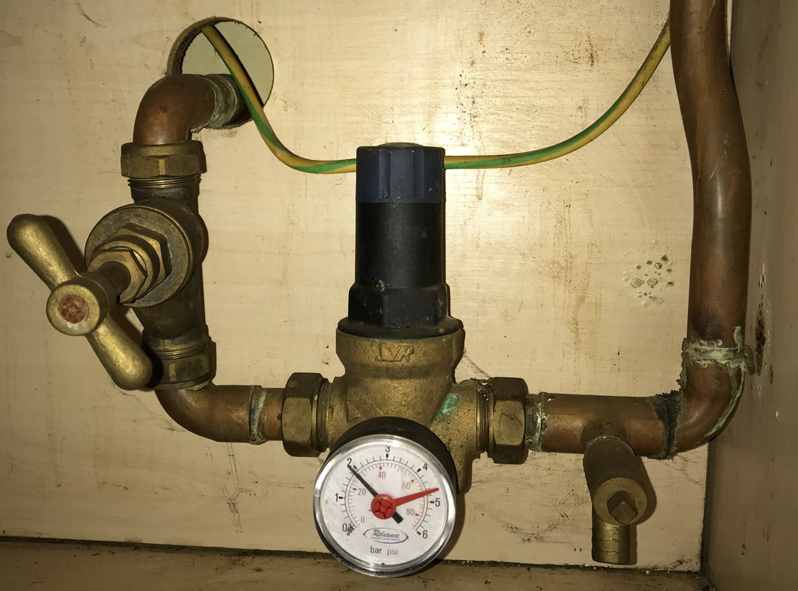

Unfortunately, my neighbor knows nothing about the pipes, taps, heating, plumbing, etc. So neither do I. But I think, there is no mains water tap (no stopcock) in the flat. Attaching the picture of what I found in the kitchen under the sink. It's not mains, is it? Do I need to shut it off? Got a hose and fitting for draining the cylinder. Do I need to adjust TPR (?) or RWC (?) regulators before starting?

That most recent pic of yours certainly looks like a stop tap. Turn it off and see if the cold water taps stop working. Don't touch the pressure regulator or any of the other adjustable bits in the cylinder cupboard.

Turned off a tap in the kitchen. Opened the cold water tap - still have cold water, good usual pressure.

Can that tap under kitchen's sink be somehow related to washing machine only? It's turned off and I run cold water for quite a bit but still no changes in cold water's flow....

That stoptap in the kitchen is definitely supplying something- are you sure you've turned it all the way off (clockwise)? It is possible (though unlikely with the pressure regulator on it) that only the kitchen cold tap is on that (presumed) rising main tap, others might be on tanked water supplied by a different stop tap. Hard to tell without having a good look round, unlikely since you have an unvented (mains pressure) hot water cylinder...

I'm pretty sure that I've turned that stop tap clockwise all the way off. Can it be that it's faulty and won't shut off properly?

Limescale could easily be the cause of your lack of hot water. And yes it is possible the stoptap is blocked (though it doesn't look that old)- don't gorilla it, you've done your best. Even more reason for not getting involved with booking repairs- could be a very dear do.
