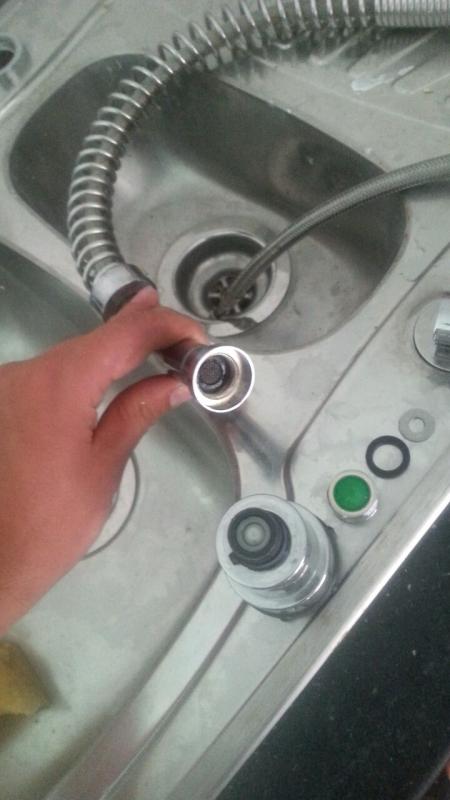

iv just fitted a mixer tap into the kitchen noticed a drip. Disconnected hot and cold pipes no water comes through the isolators when off. But when they were connected if the hot was on then it dripped.
Any ideas where I should be looking I took some pics of thr tap.
As previously said. Cartridge/ cartridges are passing. If it is a new tap, then it should be under warranty, so call the manufacturer. If it is out of warranty you will still need to contact the manufacturer for replacement cartridges.
Where is the cartridge.? In the last picture I put on you can see a rubber washer and some mesh. Is tgat it? i dont know how to rake it off
