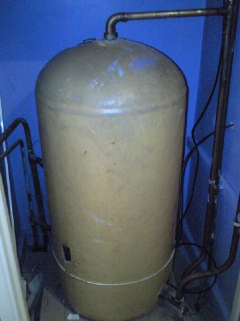

If you do not know what sort of system/cylinder you have, then try to load some pictures please, it will be a huge help

i cant see a pressure gauge on anything.
yes it has expansion tanks in the loft
no idea how old the rads are as i only moved here 12 months ago
no idea of age on the boiler either. its a gas fired back bolier system
i havent altered anything since i moved to this property
i just dont understand why its gone from fine on friday to stone cold water on sat eve
i know im not much help but like i say. im no plumber :oops:
back boiler?
probably more than 20 years old

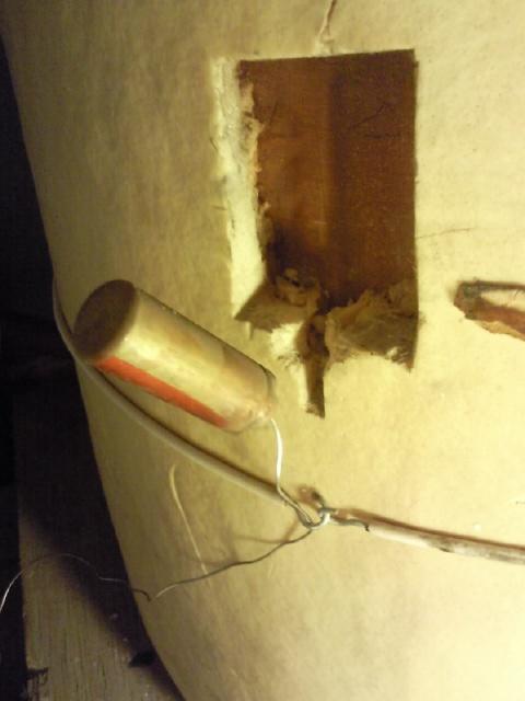

Can you see an electric thermostat strapped to the side of the cylinder? It will have a cable that might go to a connection box near the boiler

In this picture, there is a strap round the cylinder, and a square hole has been cut in the foam insulation. There should be a thermostat in it. Where is it?
like this, or similar
as john has said,can you see the cylinder stat lying about? it will look similar to this

small brass tube in shape
it was behind the black shrouding

it might be some kind of thermostat, but it is not correct for a cylinder. the wires and connections look very frightening as they carry mains voltage. I can't see any way to adjust it. Cylinder stats should be tightly clamped to the cylinder with the strap, and usually have a black or white mains flex attached, and a temperature adjuster on the front.

the "thermostat" is just a small brass tube with a silver single strand wire that goes to a valve on the infeed pipe to the cylinder didnt know it would have power to it so obviously have touched it. didnt get a shock so dont think its wired to anything mains wise
