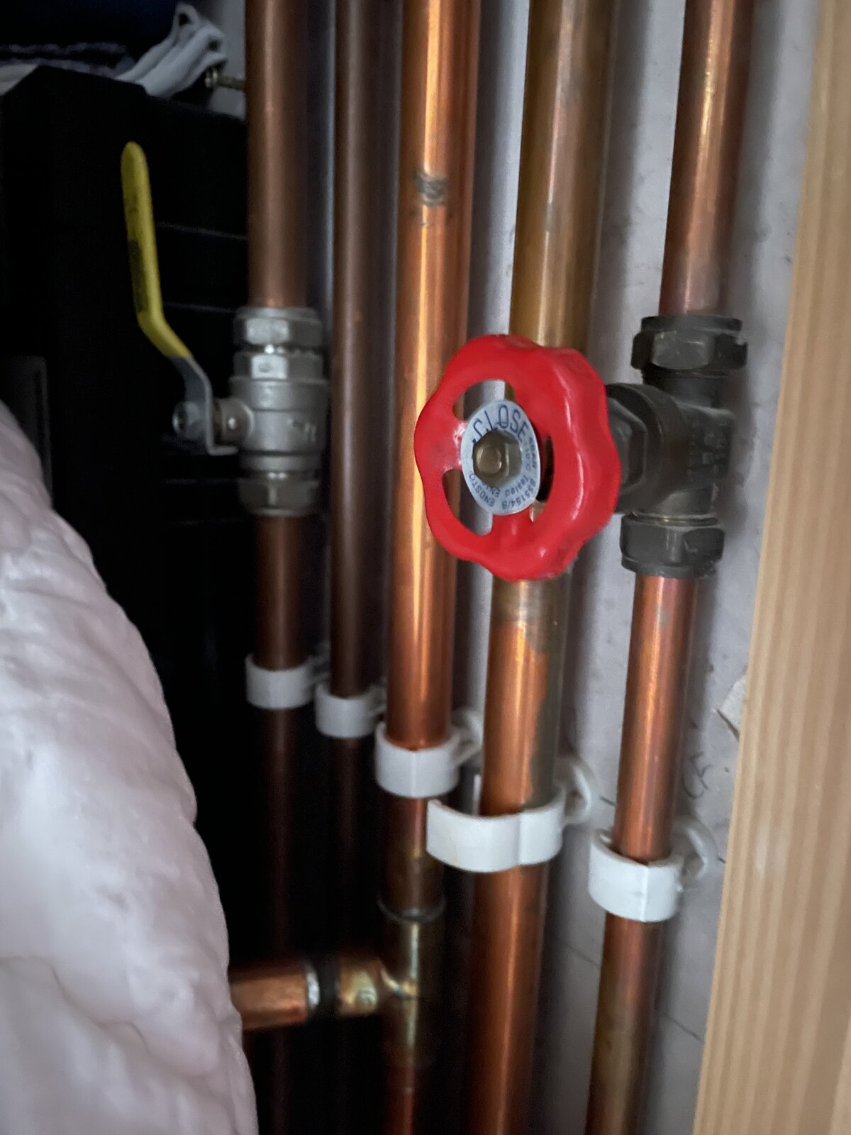

If I turn off the gate vale on the pipe running directly into the bottom of hot water cylinder, should the hot water supply to the taps stop almost immediately? I've done this but the hot water still runs. I thought cutting off the cold water feed would stop hot water being pushed out of the top of the cylinder and would therefore stop the hot water immediately. Is this wrong and do I need to run until the cylinder is emptied? I am trying to change a tap without draining the system.

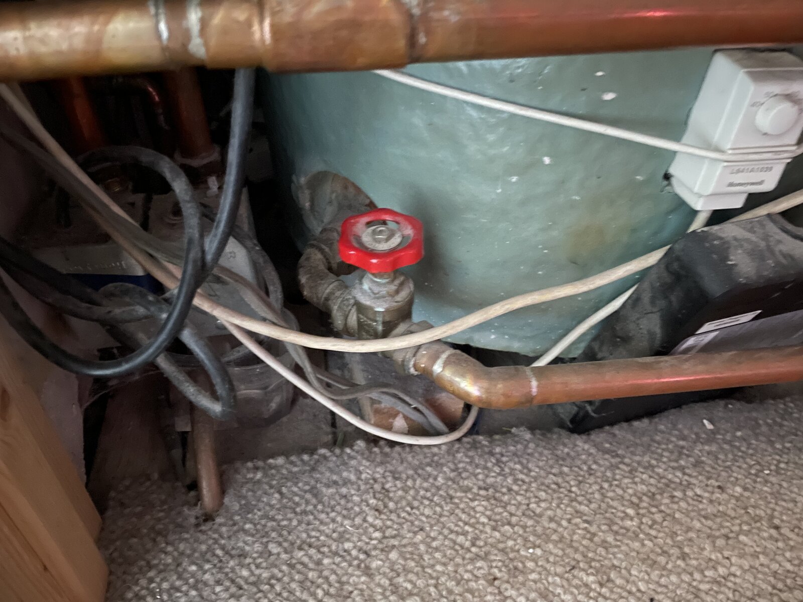

Pics of gate valves - first one is the one I shut off. Second is on a pipe that runs to first but also splits off before that. C4ED02BC-849D-4D56-AFEA-B58F622B6041.jpeg5028172D-D359-48E8-8376-B950BA7C0652.jpeg
Impossible to tell from your pics as they dont show anything really, try closing the valve on the right hand pic,the lower down one could be a restriction valve for the HW heating circuit
The first pics gate valve goes directly into (and is immediately before) the cylinder so I assumed that was the right one. Am I ok turning off any of these valves and testing the effect? Is there any potential to cause a problem by doing this? There are also a couple of lever type valves in the airing cupboard - same applies to these?
Hard to tell but one looks like the return from the coil and the other looks like 15mm. Could be that neither are on the cold fed from the storage cistern.
My money would be on the lever valve being the cylinder cold feed. Feel down that pipe and see if it goes into the bottom of the cylinder. It may be round the the back as its usually on the opposite side to the coil tappings.
