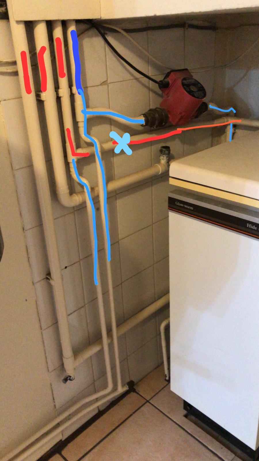

Recently moved house and have noticed what I suspect is a fault with my heating / hot water system.
With the central heating off and the hot water on, the upstairs radiators are getting red hot.
The boiler is a Glowworm Hideaway 50, and I believe that it’s a gravity fed HW, pumped CH system. I haven’t found any zone valves or additional pumps anywhere, other than the one on the CH pipe next to the boiler.
I’ll attach a picture, but you can feel the pipes when the HW is on and the HW pipes are hot, but one of the CH pipes is also hot out of the boiler which leads upstairs, the downstairs radiators also Tee into this pipe which is stone cold.
So it definitely seems as though the boiler is somehow allowing heated water to pass into the CH system when the HW is on and gravity heating the upstairs.
I’ve had a plumber out, who has pretty much said it’s a quirk of the house and normal. Doesn’t sound right to me that the upstairs cooks when you want hot water (especially in summer)
Any suggestions of things to check or possibly what the issue could be?

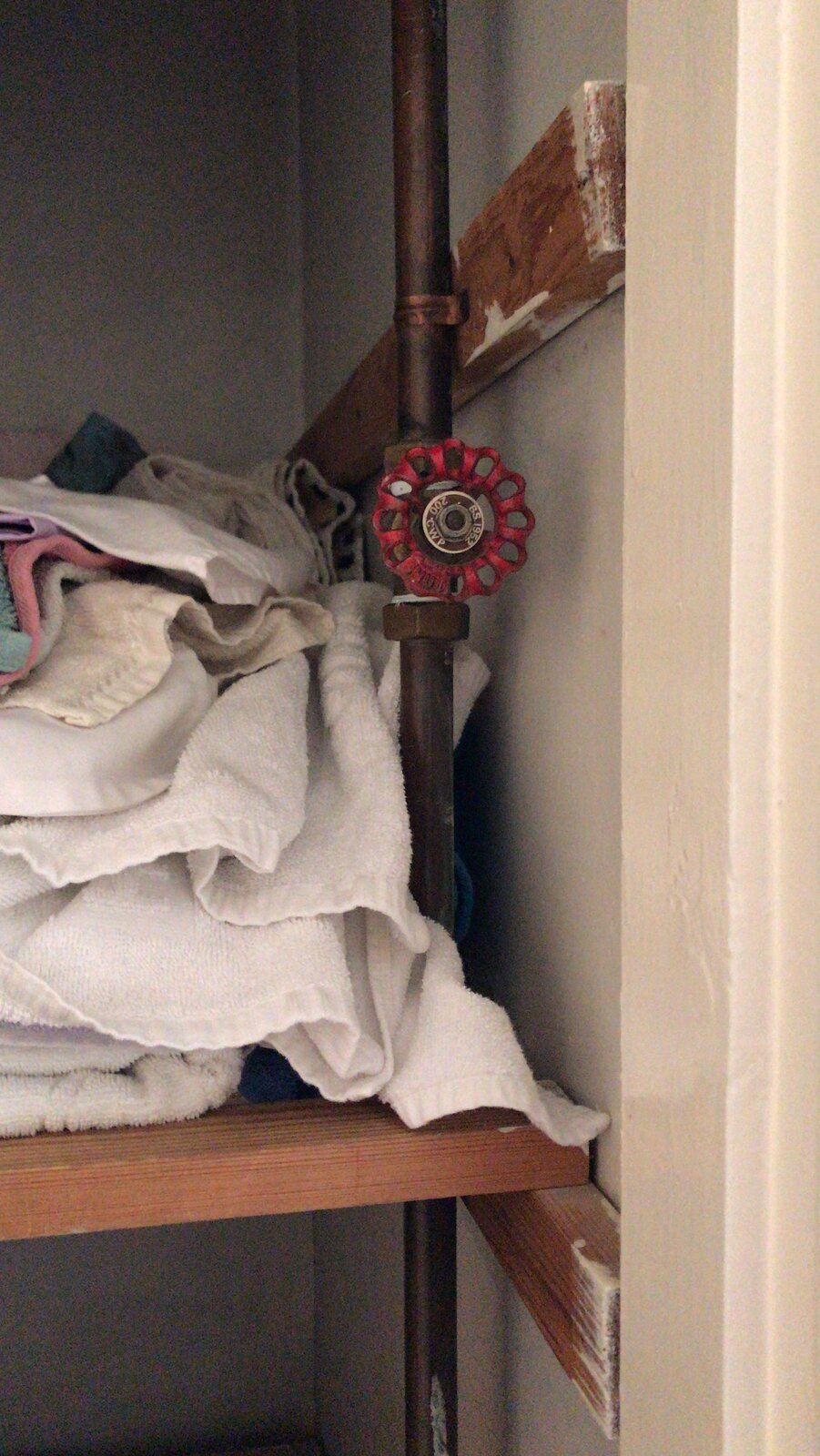

I’ve had a look around for any valves and can’t find any, unless it’s possible they’re installed under floorboards?
The only valve I’ve found is a manual valve to one side of the water cylinder, but I think this may be the supply from the header tank to the boiler. I’ll add a picture.
In regards to reverse circulation, the house has been extended downstairs, but it’s all of the upstairs radiators that are effected (4 in total)
That's an old gravity hot water and pumped heating set up. Top floor rads getting hot is caused by thermo syphoning. Normally an anti gravity valve was fitted to prevent that. Simple to fit, but will require a drain down. If you want to have more control over your system, then have it upgraded to fully pumped, which would allow you to control hw and htg separately. In Summer you could simply turn off the affected rads by their valves.

A conversion to fully pumped requires, motorised valves, pipework, possibly a new cylinder and electrical controls to be upgraded. I've been retired 10yrs, so am out of touch with current pricing. Used to be around £800 when I was at work. Possibly two days labour. Sorry I can't be more precise. To have separate controls will save money on gas usage, but will make the system more controllable. When you come to replacing the old boiler, your system will be ready. Sorry for the delay in responding.
