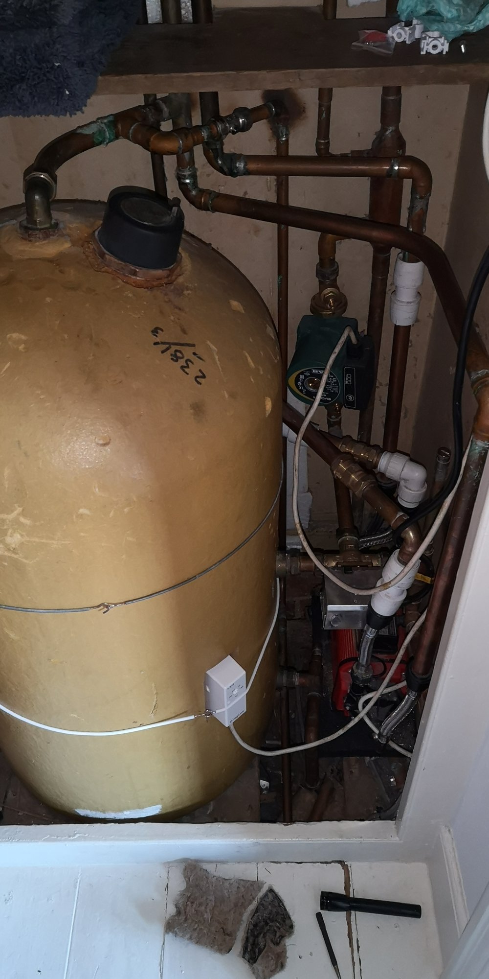

We have a conventional boiler system, small tank in the loft, hot water cylinder in upstairs cupboard with pump and Y port valve and boiler downstairs.
Earlier this year had new timer / control unit fitted, new Y port valve, new pump and new hot water thermostat.
Since the beginning of this week the hot water coming on at 5am has made a repeated knocking / tapping sound, starts fairly slow, gets faster, then slows and stops. Sounds to me like pipe expansion against joists or something in the floor. Knocking noise probably lasts 15 seconds in total.
However, it doesn't stop when up to temperature. The noise just repeats every minute or so and it's driving me mad!
Is it pipe expansion or could it be something else? Anything else I can try?
We have a magnaclean fitted above the boiler, I noticed that sounded like running water (air in system?), I got some air out last night but its made no difference. If anything, worse this morning.

What brand valve was replaced? What brand valve is in now? Are you able to take photo of current setup?
Another update this morning, noise is still there and I think I now understand why it's repeating like it is.
I noticed the pump and boiler turning off and on repeatedly this morning, so seems the boiler is cycling when hot water is running. It's a Vaillant ecotec plus 418 boiler.
I noted S.8 code on the display, this last maybe around 5 minutes before it goes through the ignition cycle etc for another couple of minutes and then repeats.
Additionally, I noticed one S.53 code but this happened about the same time as the heating system firing up and it cleared (then I had to go to work...)
I suspect this is what is giving the repeated expansion noise! I can't understand why it's only started now but at least it seems we're closer.
I've done some more reading on the forum regarding these boilers and codes, seems it's common.
I will note the D0, D1, D2 parameters this evening and consider changing them to see if it makes a difference.
Any other suggestions? How can I calculate the correct output for D0?
