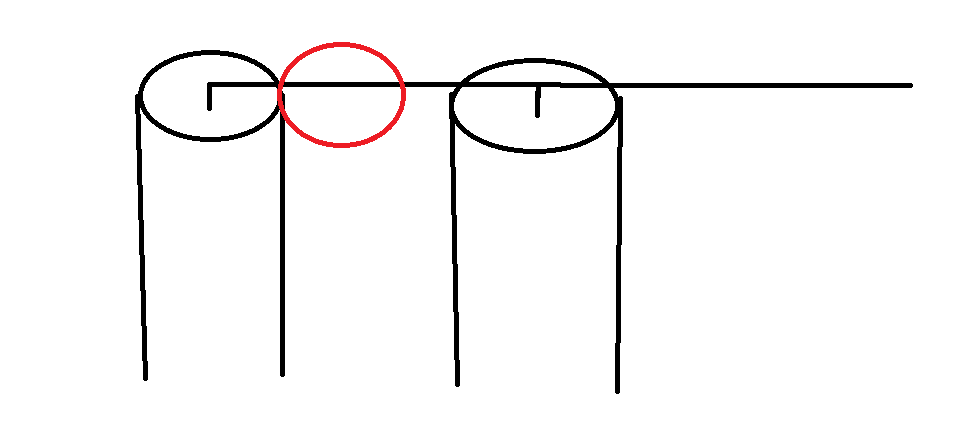

Hello,
We have two linked megaflwo tanks as in picture. Recently we noticed we were running out of hot water very quickly. It turned out the left hand tank was not giving out any hot water, just the right. Before the plumber came to look at it the hot water outs were connected in series at the top and you could feel the left hand out be cold when a hot tap was run and then come back to feel hot when the tap was turned off.

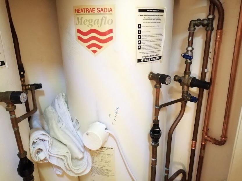

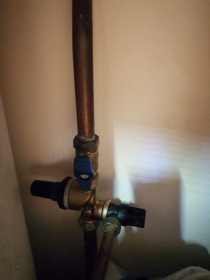

The plumber said either the cold water ins or hot water outs should be crossed. So he's crossed the hot water outs and therefore they are no longer connected at top. This did not solve the issue. He also installed two leavers on the cold ins so as to seperate the tanks allowing them to be tested independently. It was then noted the pressure reducing valve, second picture was not allowing correct flow of water. He said 100% a new prv would sort the issue. So done that.
Now we are still no further forward. When running hot tap we get hot water for a while then the hot out on the left hand tanks turns cold and water at tap drops in temp. Once tap is stopped the pipework goes back to being hot, I assume this mean there is still hot water in the tank.
All elements on both tanks are fine, been tested by electrician and plumber, giving correct resistence and the two on left hand tank are new July 2020. We have no mixer showers, isolating the mixer tap has made no difference.
One thing I'm not clear about is I thought it was the cold water coming in bottom of tank that help push hot water out the top. If I close off both the cold water ins using the leavers installed hot water still flows quite normally out the taps.
Any thoughts much appreciated please and thanks.
