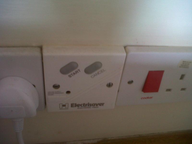

Hi there guys, I need a little advice.
myself and the girlfriend just bought a 1 bedroom flat whilst we're at University which has a copper cylinder with 2 elements as the main heating supply. The boiler literally supports 2 hot water taps, 1 in the bathroom and 1 in the kitchen.
We just got a shock when the electricity bill came through and I've decided to look for cheaper alternatives. Of which, I've come across water heaters similar to this NOTE: If linking to outside sides isn't allowed I'll delete the link.
I was just curious of 2 things; will this be suitable for our needs and will it be cheaper in the long run?
Friend is a heating engineer, so labour will be considerably cheaper so that's a less important factor.

Is your existing cylinder well lagged?
are you using the immersion heaters properly, if you are on Economy 7 tarrif the bottom Immersion heater should be on from 11pm till 6 am the top immersion heater is used as a day time boost ONLY if neccessary.
it sounds like both heaters have been on 24/7??
the unit you have suggested looks to be very power hungry, there are better alternatives such as a Heatrae sadia multipoint unvented, although one of these would struggle to support a shower, so an instantaneous electric shower could be fitted,
I suspect if you get to grips with what you have you will find running costs to be more reasonable! ;)
With that heater you will probably require a larger electric main incoming cable from the road, it uses up to 75Amps!!!
Boilerman, I meant to mention that we already have an electric shower so that's a cold water feed itself. No need for the heating system to power that :)
We've never really had the heating explained to us on move-in. I thought the control panel (in the kitchen) would be for the heaters only.
EDIT: We have old brick filled storage heaters.
Sorry to double post but you guys have actually helped me to conclude something. The people who lived there before us just had a baby and had said they were keeping the heating on 24/7 to keep the house warm. They've obviously not changed it after moving it. *sigh*
Cheers for the help guys, a change might not be needed yet!

Just have the immersion heater on for 1 hr per day or less if you only need it to wash the dishes, you can buy a timer cheap at screwfix/toolstation, as said before make sure the cylinder is well lagged & no dripping hot taps, I think buying is a great idea if you got the flat at the right price, my daughter was paying £ 85.00 per wk just rent & after you graduate if you move away you can always rent out the flat to other students & hopefully make a pproffit
We got it at a pretty good price for a 15 yr old flat. How do I go about checking how lagged it is?
That'll almost certainly be for your hot water (possibly the top/sink heater only on a two-heater system) for a daytime boost.
Press Start and the water heater should turn on for a pre-set period of time.
Press Cancel to turn the water heater off.
