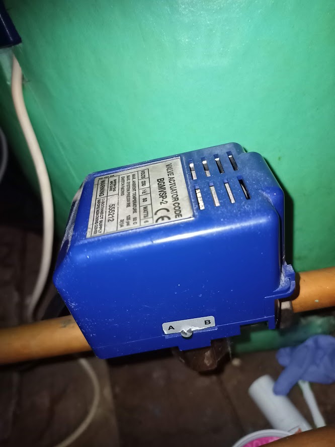

It's a BGMVSP-2 by the way if that helps. There's that one next to the cylinder, and another one further off in the pipework which I guess is for CH.

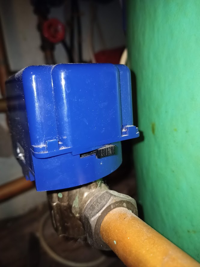

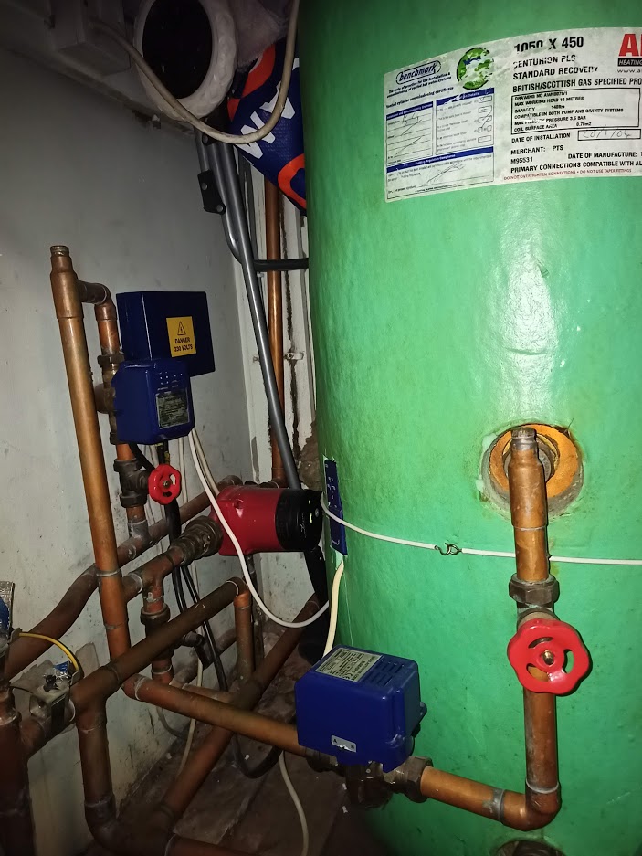

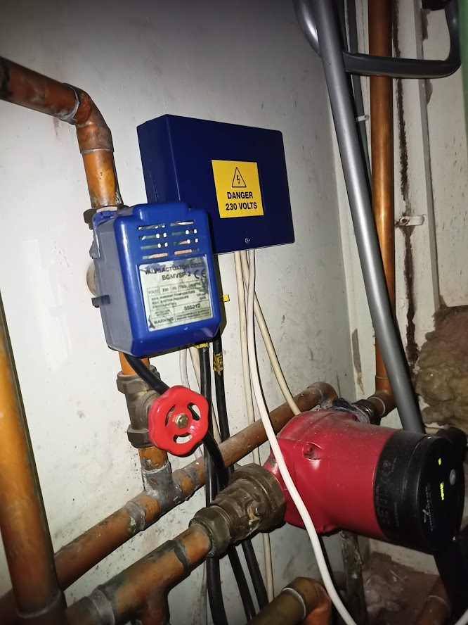

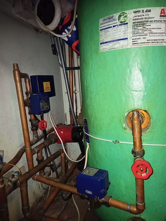

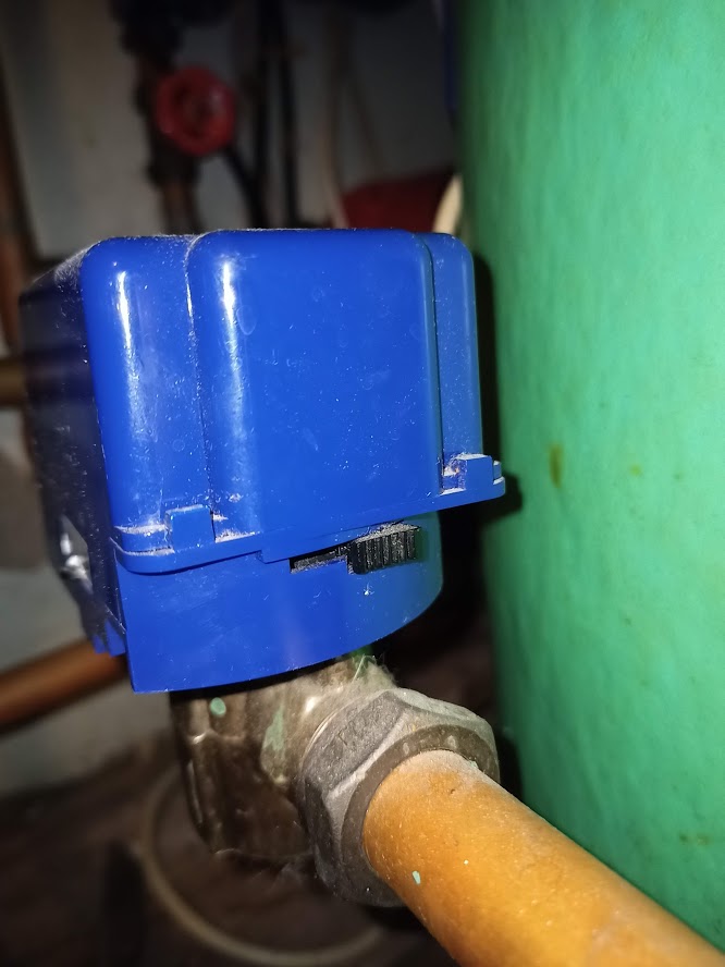

Can you post pics of pipework around cylinder , particularly the motorised valves ,the valve that controls the flow of water into the cylinders coil will be on a pipe that goes directly to the cylinder. Electrical testing would be done at the wiring centre.
IMG20200529223346.jpg IMG20200529223425.jpg IMG20200529223442.jpg IMG20200529223456.jpg
Sure - here you go, excuse the mucky airing cupboard, the flash reveals all it seems!
Cheers . Obvious which valve is for the cylinder !! The brown wire brings voltage to the valves motor ,motor turns a spindle ( shaft basically) that opens the port allowing water to flow thru the brass body into the cylinder. The spindle also triggers a micro switch ,which has a seperate voltage supply, and allows voltage to flow through the orange wire to the boiler and pump. The valve is getting voltage on the brown as it is opening and you are getting hot water. If it wasn't the valves default position is closed, under spring pressure, and you would not get hot water . So I suspect the micro switch is not being made / or is goosed.
Ah OK, that's really helpful - thanks! I guess tomorrow I will cut the power and see if I can open it up and find anything obvious. If not then maybe bridging the switch wires as a temporary test to see if the boiler starts up (just to confirm diagnosis, I wouldn't leave it like that!) - I'll update the thread when I know more, thanks again!
They are common parts to fail, due to the amount of work they do over their lifetime.
Order a new actuator and replace.
Got a new actuator from Screwfix for £55, easy swap over with the power off - problem solved. Thanks for the help, really appreciated and saved me a load of hassle!
