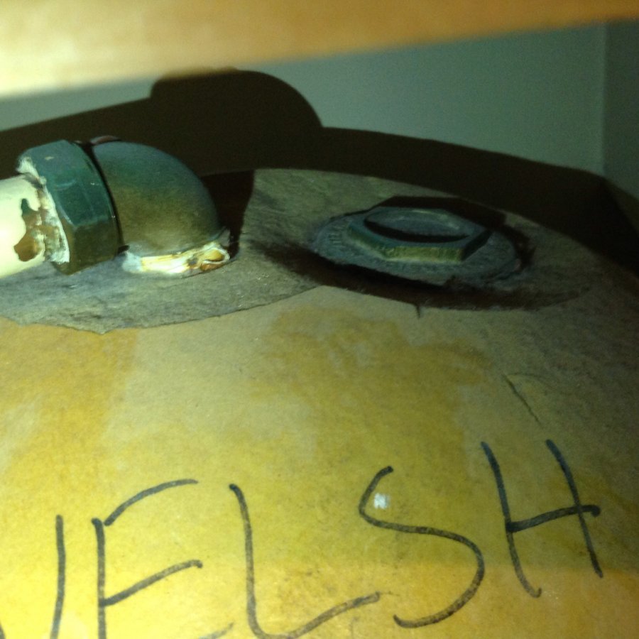

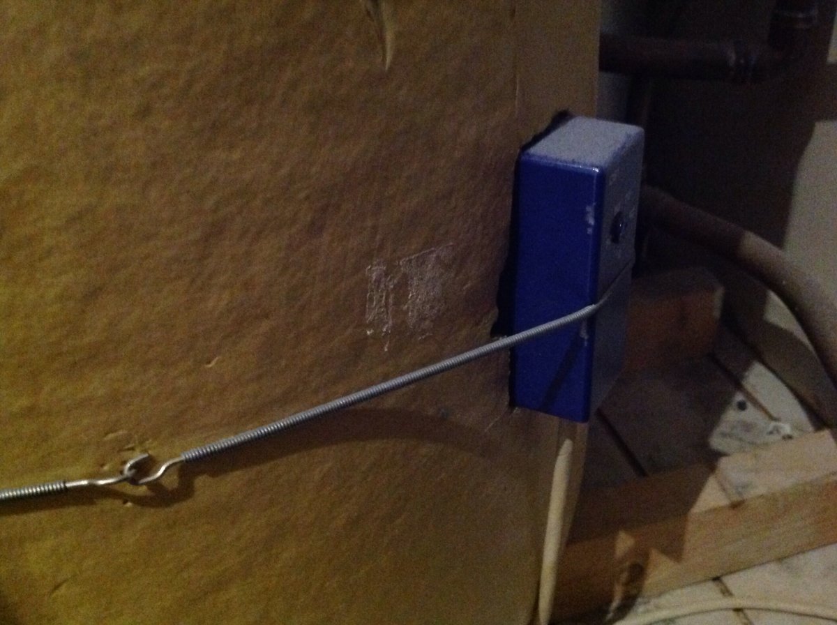

My indirect coil cylinder, only has a thermostat at the bottom which is secured onto the cylinder but nothing wired on top. Firstly, am I correct in saying I have no electric immersion heater?
Secondly, is this thermostat okay being supplied from your normal electricity meter? Reason I ask, is I saw a video mentioning it comes from Economy 7 but this is the first I have ever heard of this. My only thought is if it is an immersion heater, then it comes from Economy 7.

Thermostat

Guessing where this is immersion heater would be installed.

You dont appear to have an Immersion Heater, that is the blanking cap for the fitting of an Immersion.
Check your Consumer unit (Fuse box) to see if you have an Immersion Circuit, if so you should have a Neon fused Isolating switch in your airing cupboard .
1) You are correct, you have no immersion, the blanking nut up top is where it would normally be.
I assume you have central heating that warms the cylinder?
2) The cylinder thermostat would have nothing to do with an electrical immersion heater, that's for the central heating. The immersion would work from the mains itself and would normally have it's own thermostat.
An immersion heater would only be powered by economy 7, if you actual had an economy 7 package with your electrical supplier. If not it would be powered by normal rate electricity via a fused spur from the Consumer unit. If your hot water is heated by your central heating (CH) an immersion heater would only be there as a back up if the CH failed.
Heating hot water by electricity is probably the most expensive way to do it.
