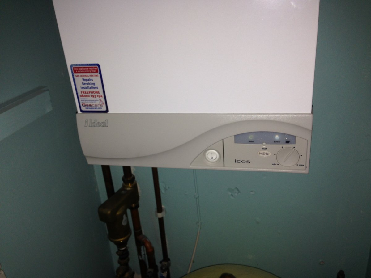

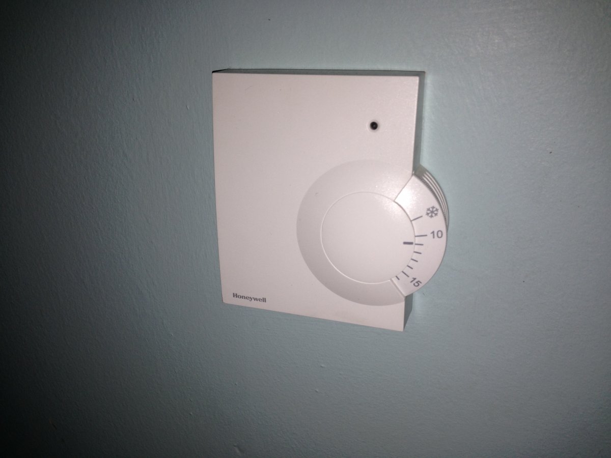

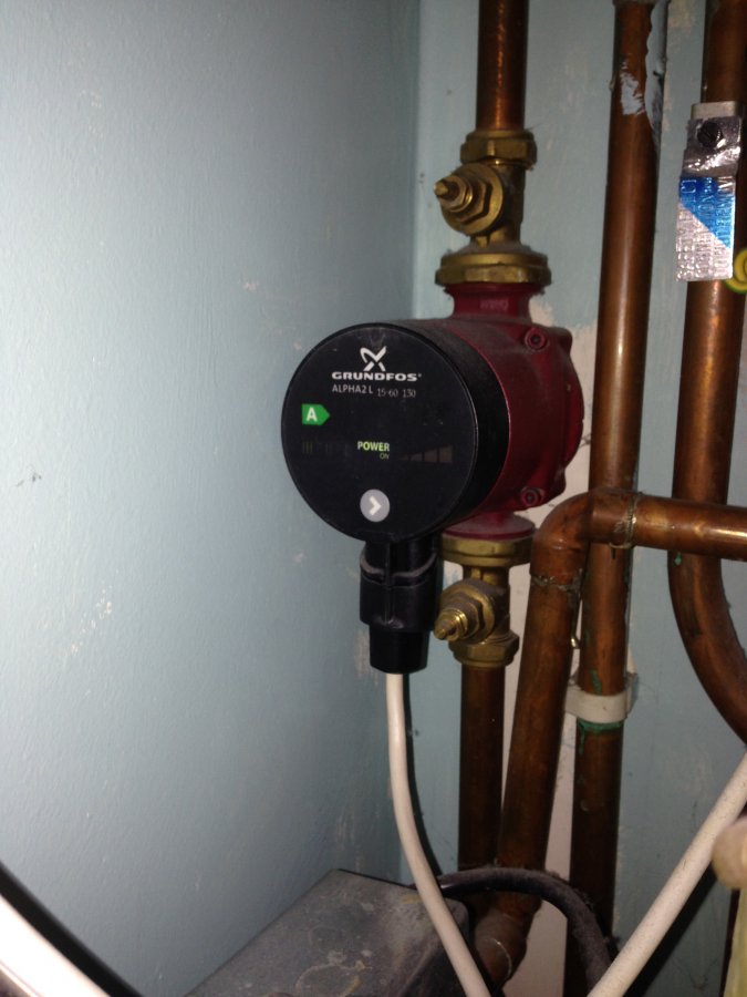

Hello everyone,
My girlfriend has recently purchased a new home and her hot water taps are so burning hot you can't put your hands under them at all. Can someone please help us reduce this temperature?
It's a gas boiler with a water tank, and it doesn't look too old to me.
With 100 degrees being boiling point, going by feeling this water and the heat of the metal taps afterwards I would guess and say this hot water must be about 80 degrees but I don't know if I'm exaggerating lol. It's difficult because I've lived with combi boilers for so long so I'm used to slow heating water.
I've attached a load of photos of her airing cupboard so you can see the set up and hopefully advise me on what dial needs turning etc.
I have googled it but got no straight answers.
I did read the tank has to be a certain temperature to kill bacteria in the water, but these taps are so hot it just doesn't seem right to me. And it must be wasting money on energy bills too.

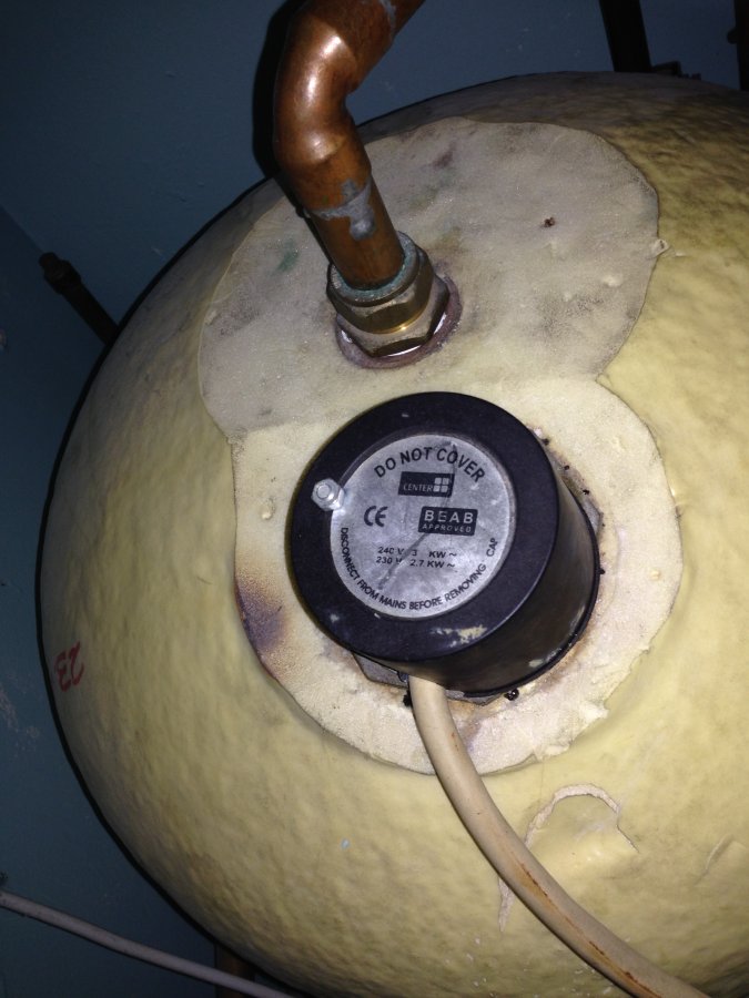

in the top of the cylinder you see an electric immersion heater. Follow the flex. It should be switched off. If it is switched on and the tapwater is excessively hot, the thermostat is faulty, which is expensive to run and dangerous. Have an experienced plumber replace it with new. New ones incorporate an overheat cutout to prevent the danger.

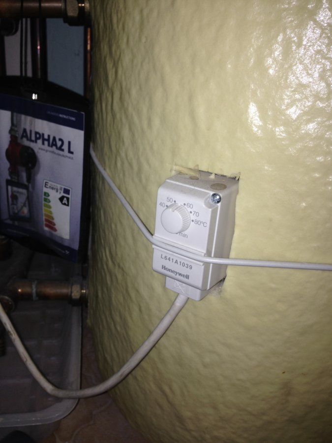

If the immersion heater is already turned off, and the tapwater is excessively hot, observe the cylinder thermostat strapped to the side of the cylinder. It appears to be set to 55C which is correct
edit
as Nige says, deal with the immersion heater first.
It appears to be faulty and dangerous. Do not turn it on again until it has been replaced.
The gas boiler can heat the cylinder without needing the immersion heater, which is just a backup for if/when the boiler is out of action. Gas is cheaper than electric.

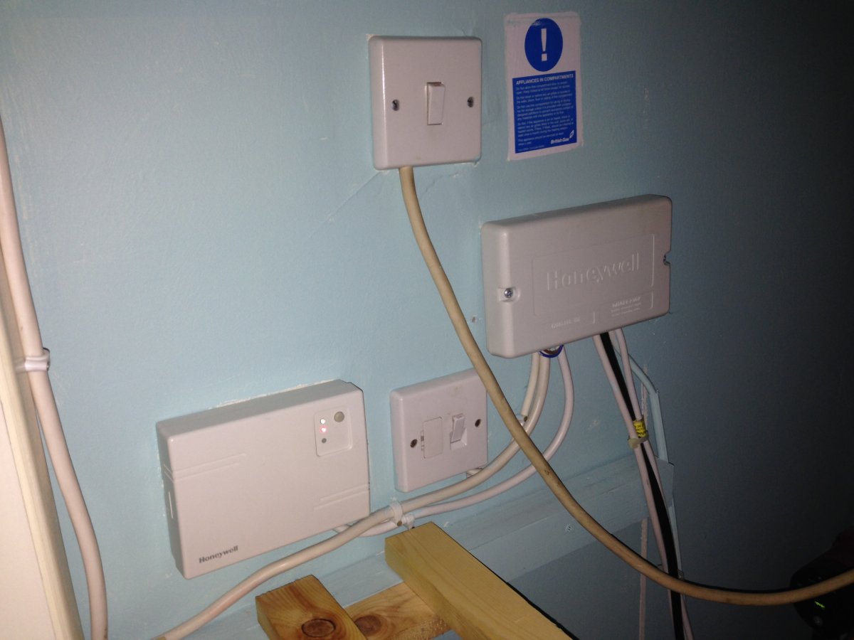

I see what you mean about that wall switch, so that is there for if there's an issue with gas not coming into the building?
So is it designed this way to be manually switched on when there's no gas?
Or is it meant to be switched on at all times and automatically starts working if it sees no gas?

as already advised turn off the immersion heater, it is only there as a back up if your boiler fails, and get someone to check the rod thermostat for you

So basically this immersion heater bit literally has nothing to do with the gas boiler?
It's a completely separate way of heating the water using electricity.
And as it stands at the moment she is heating the same tank of water with both gas AND electricity at the same time lol...

yes that is correct , just turn it off, it is only there as a back up if your boiler is not working
Hi all just a follow up to this.
She's confirmed the taps are much better now and even her radiators can be controlled properly with her thermostat now rather than being burning hot all the time.
